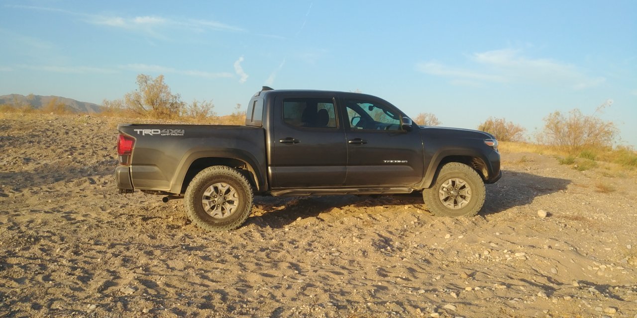

    255/85r16 cooper st maxx, RCI sliders and skids
    After looking at the forum for a few weeks, I decided to go with 255/85r16 cooper st maxx tires. I do notice a slight rub when I fully crank the wheel in parking lots, I think that having the extra weight from sliders and skids might have something to do with that though.

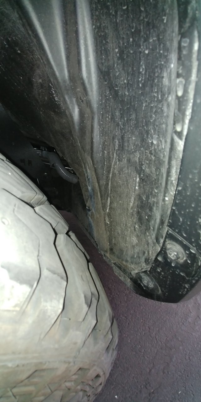

    Hmm, have same setup with aluminum front skid and sliders and have cycled the suspension, the top of the tire brushes the top of the wheel well if you bounce the truck but haven’t had rubbing in the front or back. Where’s it rubbing?

    I think it's the outside of the front tires. There is some wear there, but Idk if it's from the bad alignment I initially had, or rubbing. I get a slight vibration when the wheel is fully cranked. It's not really that noticable and does not happen all the time, seems to happen more when backing up.

    The outside of the front tires can mean rubbing at the front of the wheel well or the rear. Any rub marks on the fenders? An alignment may help. I get a lil vibration when turning tight slow corners but that’s just the chunky lugs being rolled over.

    I went and took a better look. The rear of the fender on the front drivers side looks like it might have made contact on the plastic. It's so subtle that what i am feeling could also be just the lugs like you said. It's not that big of a deal to me since I plan on getting a lift soon, and that should remedy it.
    The st maxx are also 32.8, my truck dropped a half inch hub to fender in the front after I installed the rci gear, did you notice a height decrease with yours?
