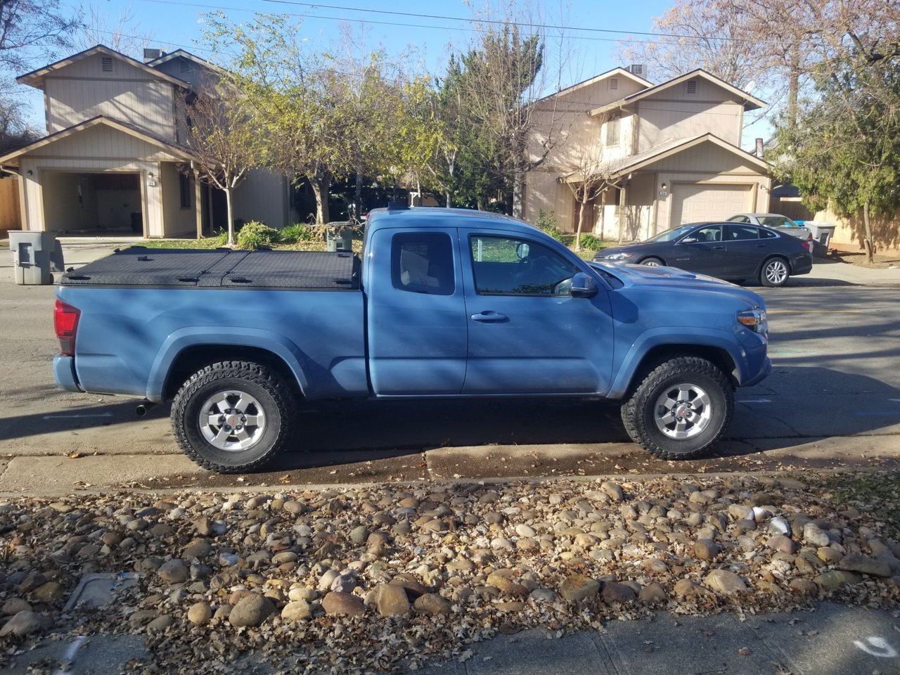

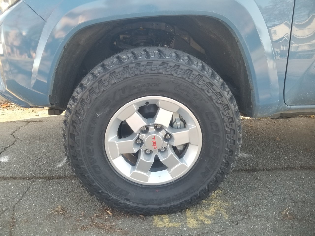

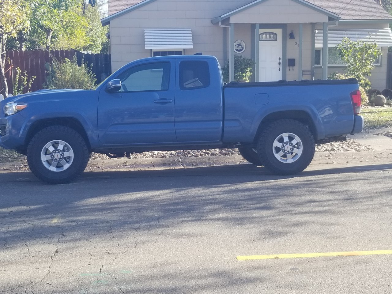

    255/85/16 St Maxx stock suspension its a Sport but they fit 20191216_104602.jpg 20191216_104546.jpg 20191216_104620.jpg
