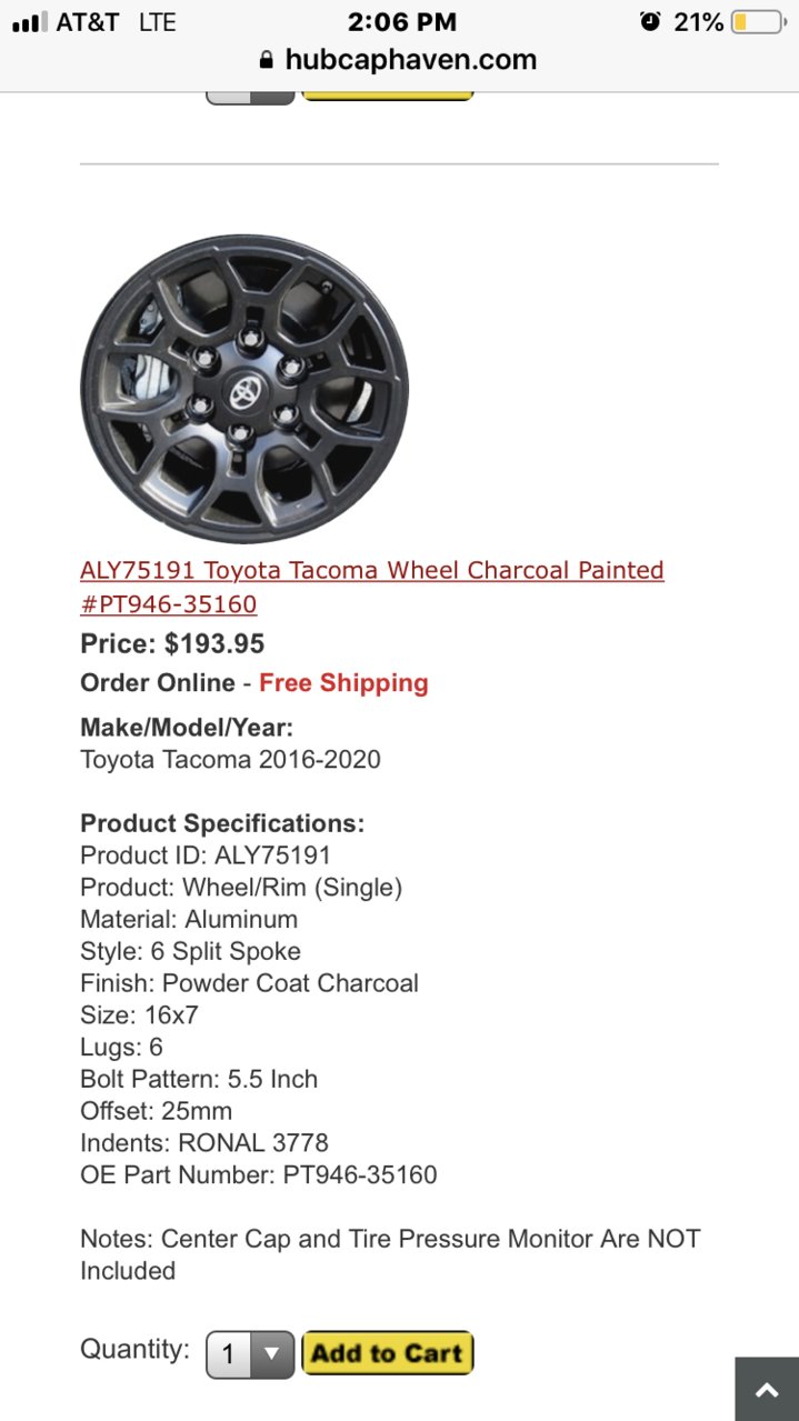

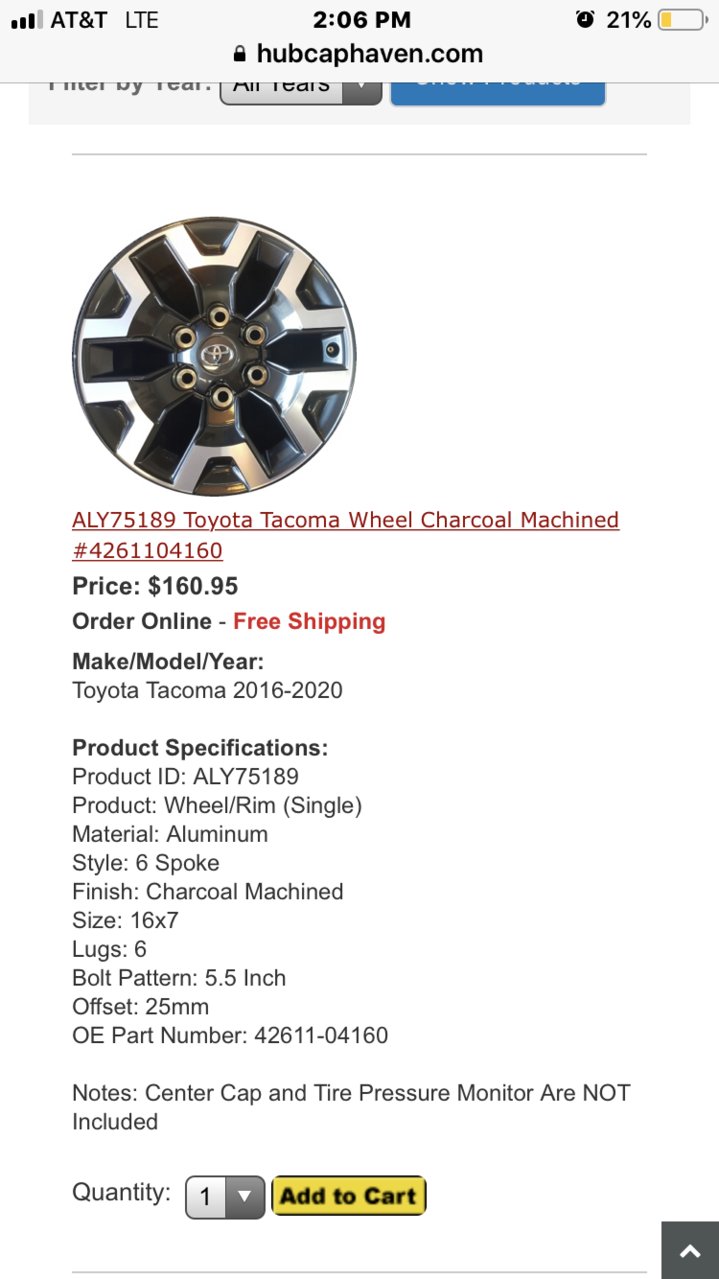

    Ive browsed most of this thread but reading every post gonna take a long time.
    Has anyone gone the tall/skinny route on an sr or sr5?

    I was finally able to find the wheel specs online...took a few tries. Leaving this here becuase i’ve seen a few older posts asking about the 4x4 sr5 wheels

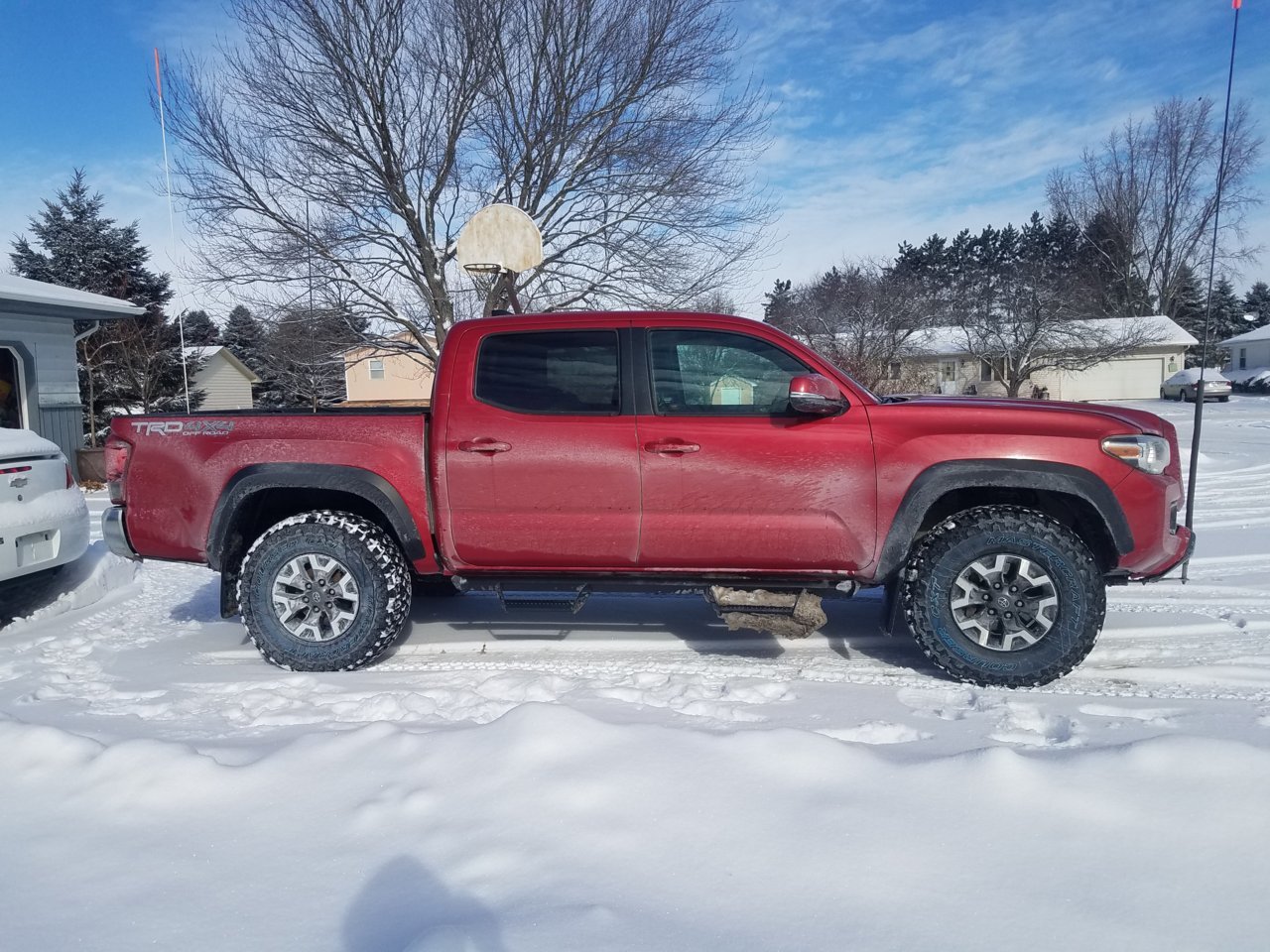

    Best photo I have, before I washed the blue off the tires.

    There’s a sticky in the tire/wheel section.
    https://www.tacomaworld.com/threads/wheel-specs.30754/

    Okay I've ready pretty much this entire thread now and after leaning towards 255/85’s for a long time, I’m now considering 265/75’s.
    From all the pictures of tacomas with 255’s, it looks like if you hit a pothole the front tire will smash into the cab mount, and it looks like there is very little space in the wheel well for upward travel when on the trails.
    Someone talk me off the 265 ledge please haha

    Been running them hard for 20k miles, no issues. I don't baby my junk. I will tell you that if you bottom out hard, the tires will just kiss the wells at full compression, with compressed bump stops. I really honestly believe this is the best tire for a stock Tacoma that values traction and ground clearance.

    Yup. I won't say I've never rubbed, but I can tell you I haven't rubbed offroad, and only in one type of situation on road (sharp turn, hard brake/bump, with mudflaps) which is insane for a no-lift 33.
