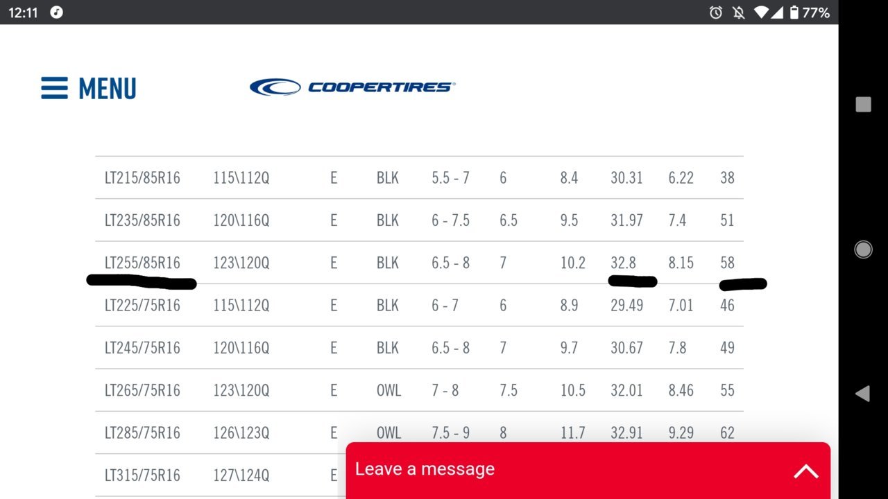

    I like my ST MAXX but I might go Yokohama G003 MTs next set. I haven't given the Coopers a proper test because of some health and subsequently money issues last summer but I suspect the muddy terrain in my area will warrant MTs. Time will tell - the Coopers are very aggressive and have large voids.
    ETALATE[QUOTED] likes this.

    According to discount tire site the yokos are 55#, same as the km2s. The st maxx being 53#, lightest in this size. Toyos being the heaviest at 62#.
  19. Feb 23, 2020 at 12:09 AM
    #2519
    photogr4x4
    photogr4x4 Well-Known Member
    Sep 16, 2015
    #164438
    1,266
    Canada
    TRD OR
    Nada
    My Cooper's weigh in at 58.9 each on an accurate bathroom scale which is accurate to Cooper's measurements. They're also 32.8" which is smaller than other bigger brand MTs (Yoko, BFG, Toyo)
    But you are right BFGs weigh in a hair lighter than Yokohama. I remember looking at Toyo weights and I feel like I remember 63lbs.
