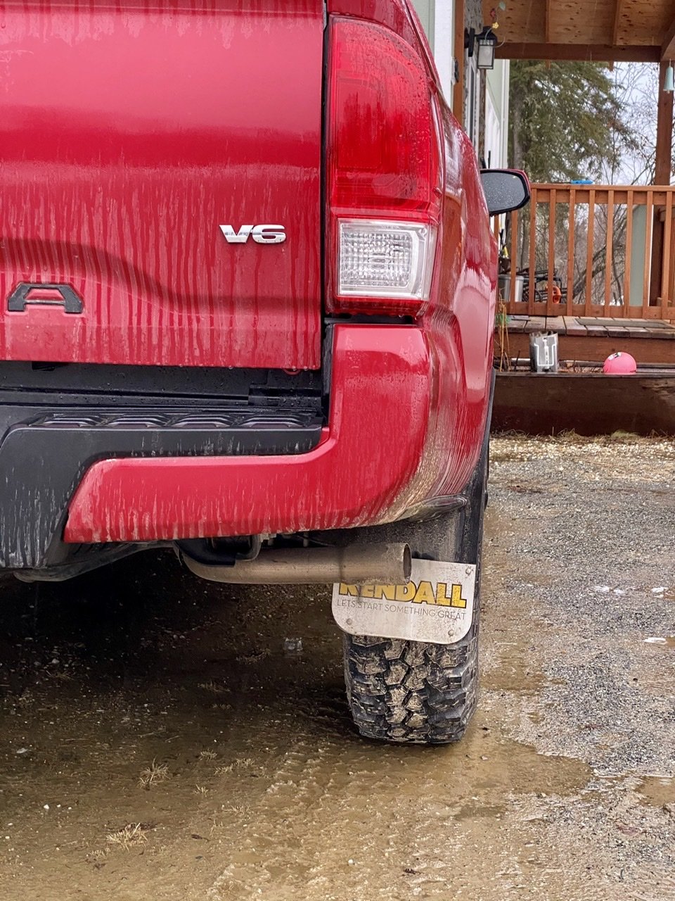

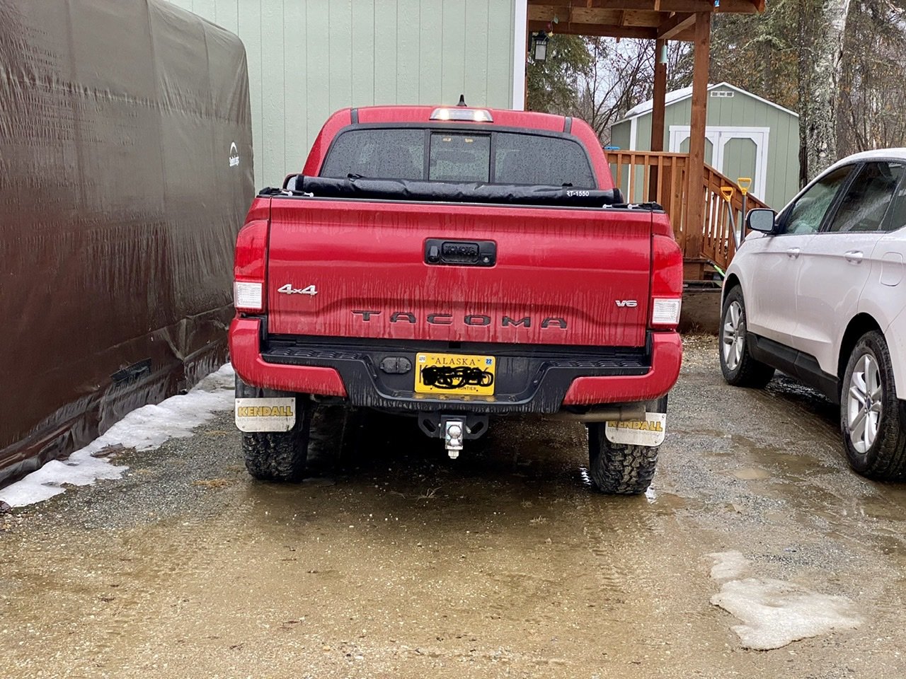

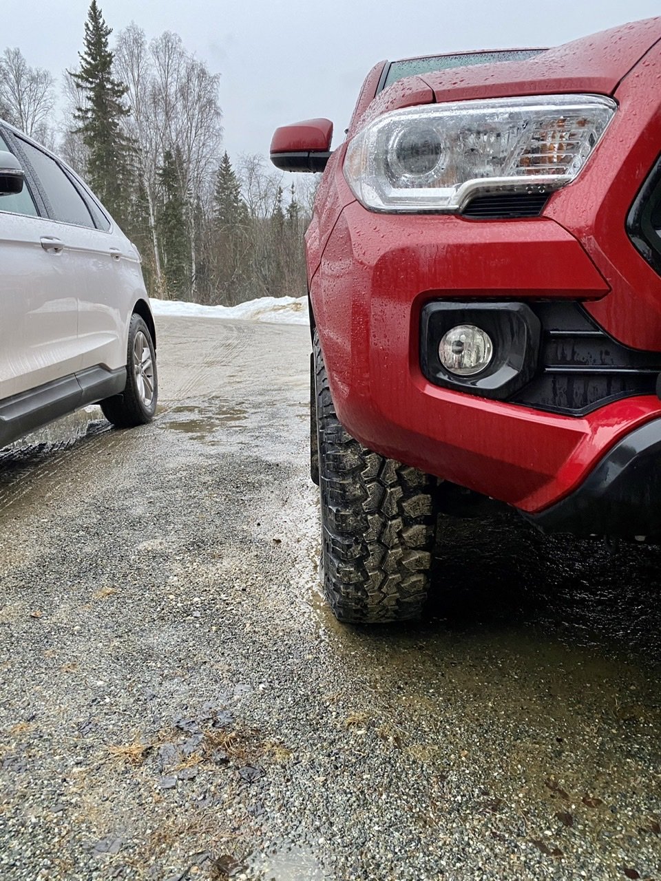

    This is such a good looking size for Tacoma’s
    Maxxis MT-762’s in 255/85r16
    I do get a slight rub on the corner of my front mud flaps when turning in to parking spots, but so minor it’ll either clearance itself eventually or go away when the tire wears a little. I’ve gotten a rub on the wheel well liner going up big curbs turning in to parking lots but it’s way better than some of the lowered sports cars and compacts I’ve had over the years with wide rims/tires.
    No issues in the rear.
    I’ve only got 100 miles on these so far but my impressions are really good. They’re noisy but different than the studded snow tires they replaced... lower pitched, more of a howl (these are my first MT tires). The ride quality and handling at 38psi is great. I think they handle big road bumps better than p-rated tires with less bouncing. Dry pavement and wet pavement is fine. Slush is great. Ice and refrozen rutted garbage traction is ok. No fresh snow yet, hopefully no more till next winter.

    Amanhowzit taco

    Got any pictures of the looking at the rear to see what the tire width looks like? I agree they look great

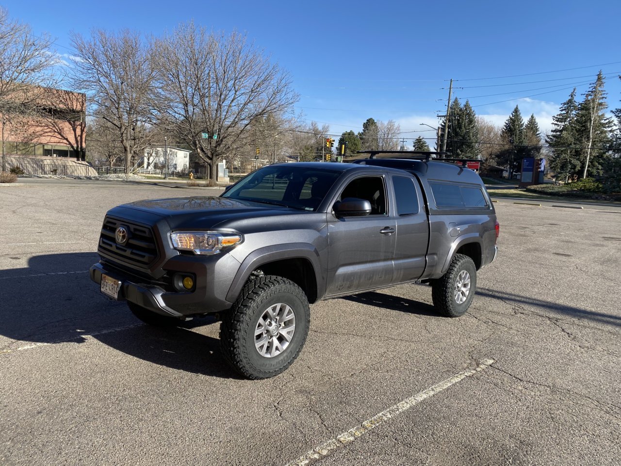

    Do you both happen to have front/back shots showing poke (or lack thereof). Want to see where those tires sit in the wheel well.

    Thanks! I'll try for some "poke" shots tomorrow.

    No poke, they just fit like they’re supposed to be there.

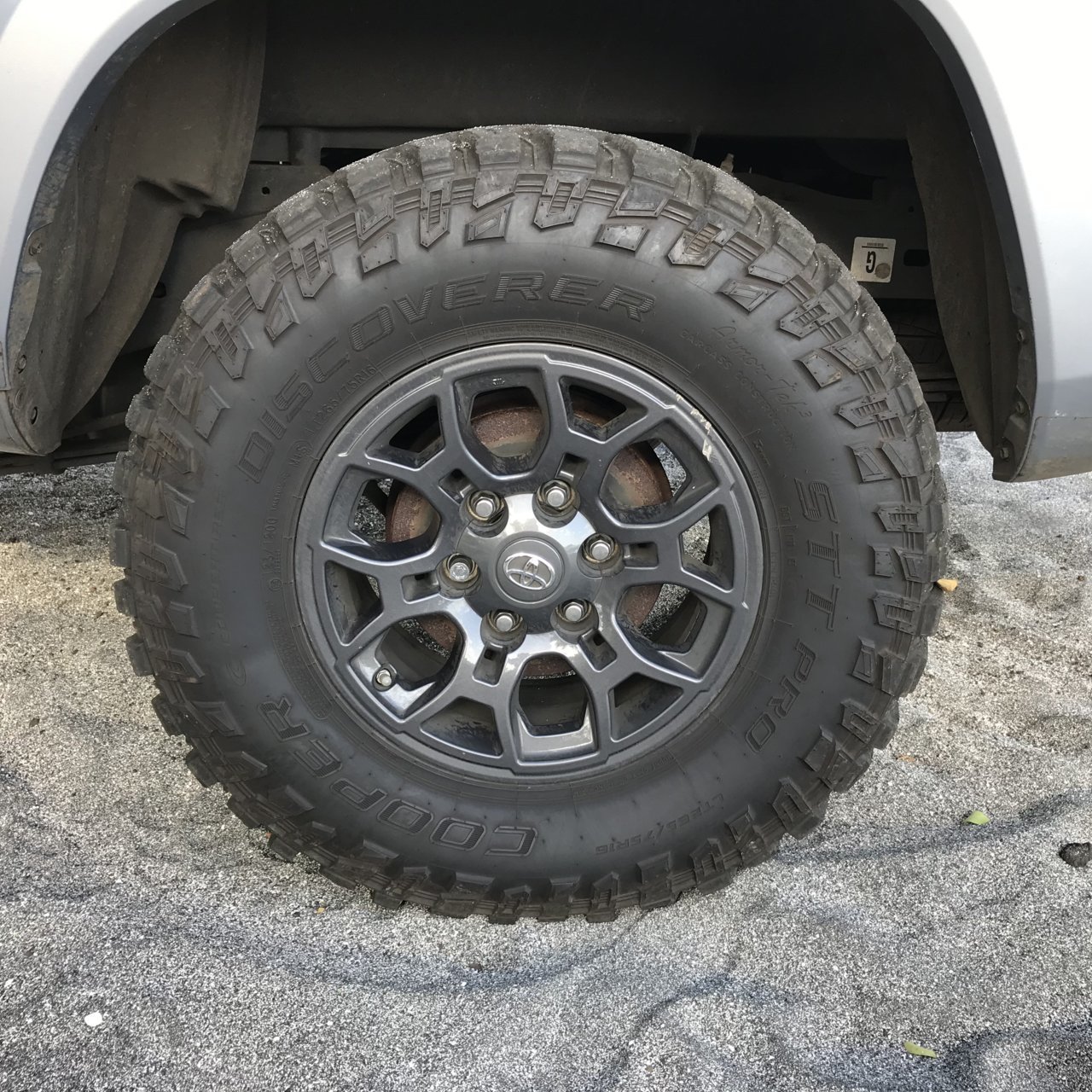

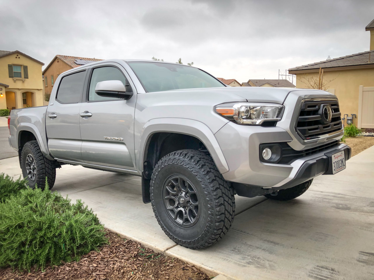

    No issues with fitment on this rim. Cooper ST Maxx 255/85r16

    Beautiful- have you ever had 265s on the same rim and if so do you like the 33s better? Also Do you have any lift?

    thanks guys - “poke” isn’t what I was really looking for, just curious how those meats sit in the wheel wells. I don’t like the sucked in looked or heavy poke. Right at the fender line is perfect.
