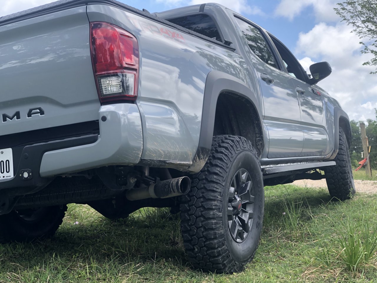

    Made four new friends today. The 5th will be here tomorrow.

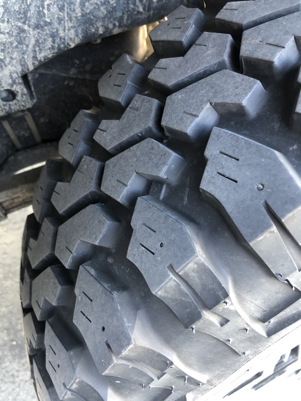

    They were grossly exaggerating then. These tires are lasting way better than the stock tires did. I replaced them with the Maxxis at 25k and I just hit 40K. I do not see them being down to wear bars in another 15k lol.
    Here are the stock tires when they came off.

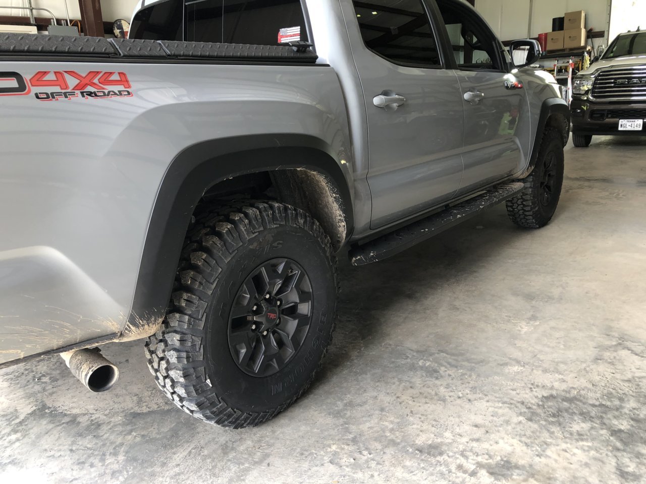

    Well, I’m gonna try them out for a while. Got me mounted today.

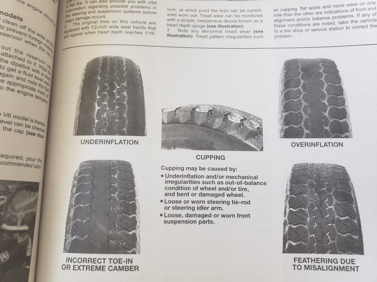

    Oh yeah absolutely check it out. The toyota reccomendations are for the tires that come stock. The chalk test helps:
    Find road pressures that utilize the entire contact patch of the tire resulting in
    -even wear on tires
    -helps longevity for tires
    -optimized traction
    -avoid uneven wear
    When you over inflate your tires, the center of your tire makes more contact with the ground while the edges do not, resulting in wear in the center of the tire.
    Too low of tire pressure, the edges wear before the center does. Resulting in wear on the edges and pre mature tire wear.
    I will grab some pics in a sec
    Edit: 20200513_153508.jpg
    not the greatest pictures but this is what it ends up being. I've seen photos of people selling tires on here with this wear, and don't even realize it. It is very easy to over inflate SL tires. It is easy to under inflate LT tires. (At least on these trucks)
    The chalk test gives you an honest even wear on your tires for your truck at your weight. Get a front bumper, winch, skids, sliders, or other bells and whistles? Check out your tire patch. The beauty is it takes 60 cents of chalk, 10 minutes of trying to save some $$ and get a better performing product.

    It's basically the very definition of science. A physical result of complex dynamics.
    Where chalk rubs off, you have contact (or else the chalk wouldn't rub off). If you have contact on the entire tire, there's less pressure because the same force demands it. If there's less pressure, there's less wear. Also if it wears all over the tire, then chances are it's not uneven.
