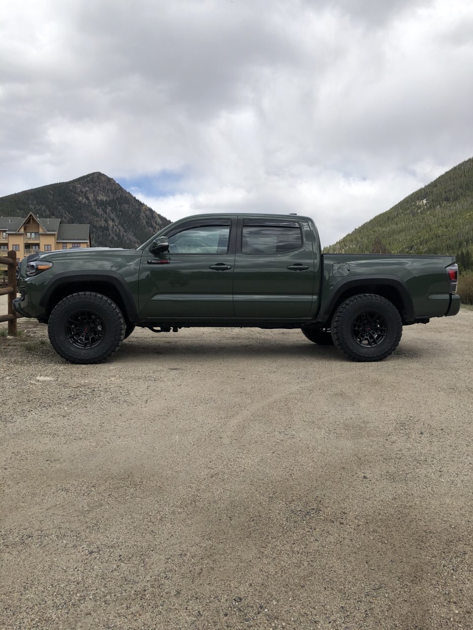

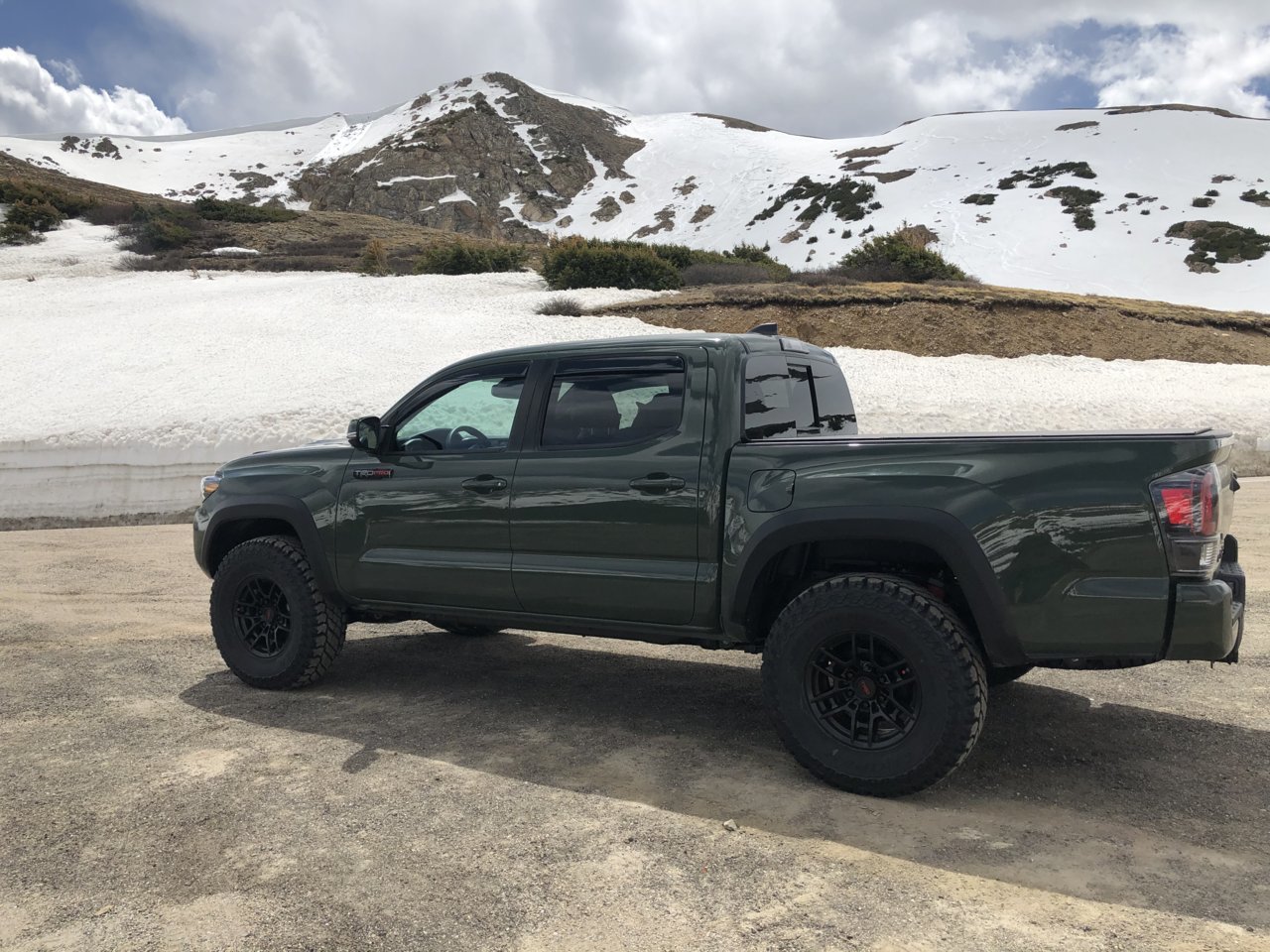

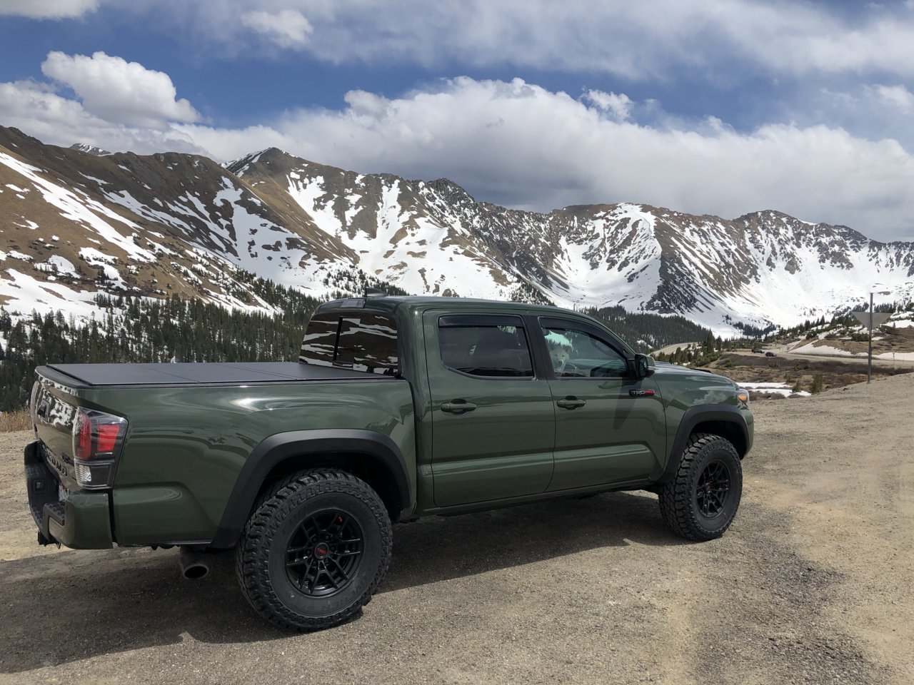

    Alright back on track here
    :threadjacked::ohsnap:
    finally got the Cooper ST MAXX! :eek:255/85/16 on stock TRD Pro wheels. Got the spare underneath too. Did the spare tire relocate and it fits nice and tight with a lil wiggling. I think they look sick! They ride pretty nice so far. I took them out on a drive over a mountain pass, on the highway a short stretch and then on the 4wd trail behind the house. Performed great! Even got stuck in a lil snow. I might put the rear mudflaps back on and save some people behind me:thumbsup: Hopefully I can save up enough before summer is over for some sliders!
    D84BAA79-80C8-4F62-9704-82D0E3CEAC86.jpg 283E0BB0-5E4B-495B-846C-A80B2CCCE86F.jpg 254E9253-A7B9-41A8-BE4C-A1445D056F58.jpg
    skierd, Discount Tire, E.J. and 5 others like this.

  16. Jun 5, 2020 at 8:25 AM
    #2676
    Hot Taco sauce
    Hot Taco sauce Well-Known Member
    Jun 16, 2019
    #296486
    438
    WI
    Dclb lover
    Just starting out, give me time
    Looks good, what tire pressure are you running? I'm currently at 35 cold 40 warm. Way better in town than at 45 cold the dealer had them at. Still seems a little harsh and squirrelly on interstate at times. I just have to pay more attention than before I guess.

  17. Jun 6, 2020 at 3:27 PM
    #2677
    TacomaGuy7878
    TacomaGuy7878 Mmmm....Tacos
    Nov 21, 2019
    #311371
    848
    CO Mountains
    2020 AG Pro
    I got mine from my local 4 wheeling shop. They put em at 33 cold 35/36when warmed up. They suck up cracks and sewer caps way better than the stock tires:D I was thinking bout playing with the pressure a bito_O I’d say the tires in general are a bit more squirrely on the highway/corners but that was my expectation with a taller tire that is way more aggressive than stock. Most of my driving is on mountain roads under 50 mph though:thumbsup: I see a lot of guys disappointed, expecting MT tires to perform as good or better on pavement than a more dedicated all season or AT tireo_O a bit unrealistic IMO
    First time I took stock tires off road I got a flat:mad: I’ve heard the Coopers are bomb proof so I shouldn’t have to worry about that anymore :cool:
