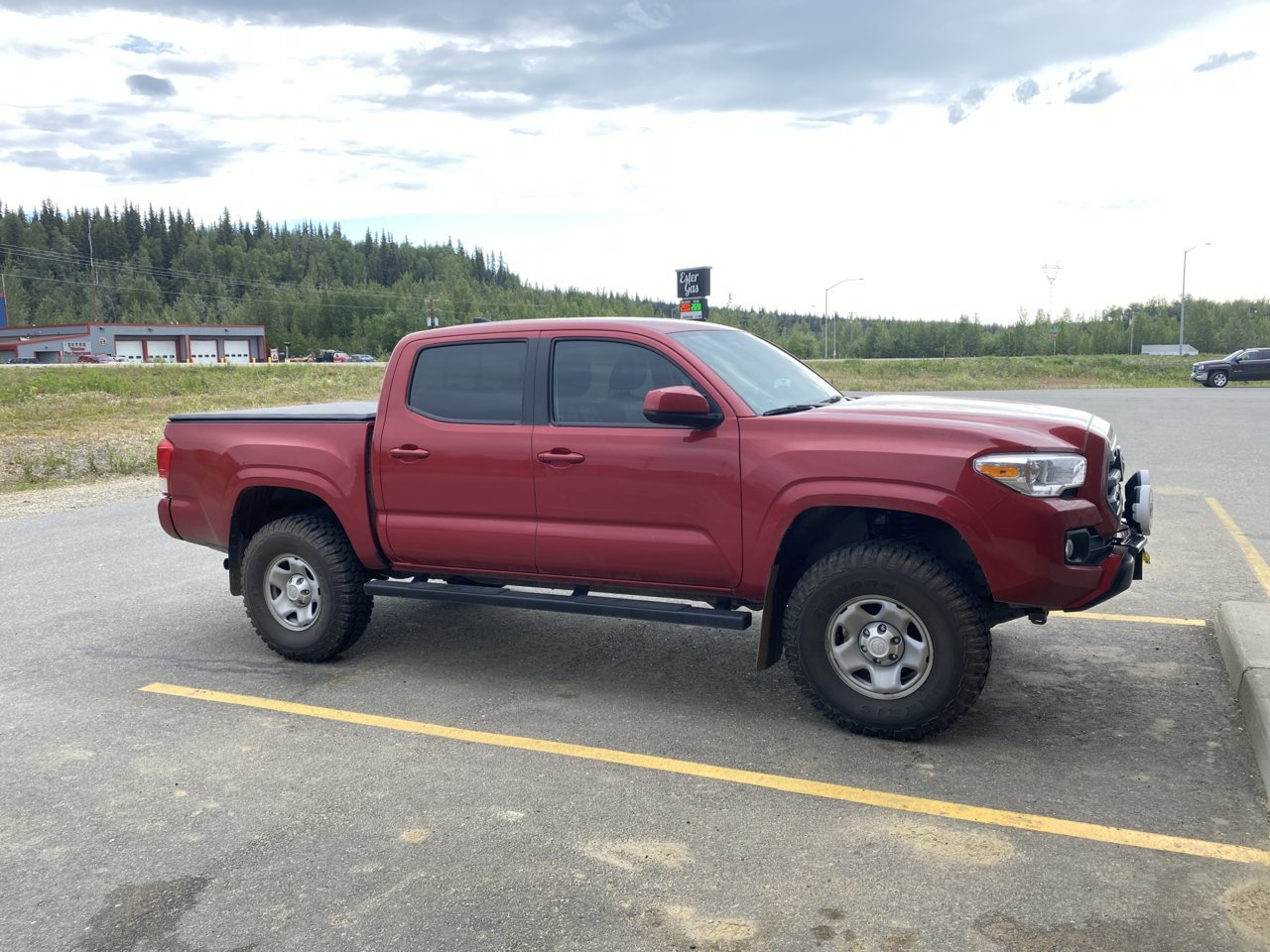

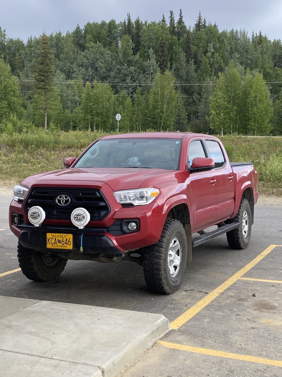

    I lifted my truck because of issues unrelated to the tires. I wanted to add an AAL for better load carrying, which meant also lifting the front. The truck looks much better with a 2” lift on 255’s imo too; if I planned on staying stock height I think 265/75r16’s would have been better looking.

    whats your 2" setup? im not against lifting i just dont want to do more than 2" and it may be a little while .

    Looks great def going to be doing 2" down the road. 2 questions what mud flaps you running and whats your review on the maxxis tires?

    The tires are great. They sing on the highway for sure. No traction issues in rain on pavement and I’ve had to deal with a couple muddy roads and they’re awesome in the slime DOT used to resurface our dirt road this year. I won’t have a winter report till October, hopefully.
