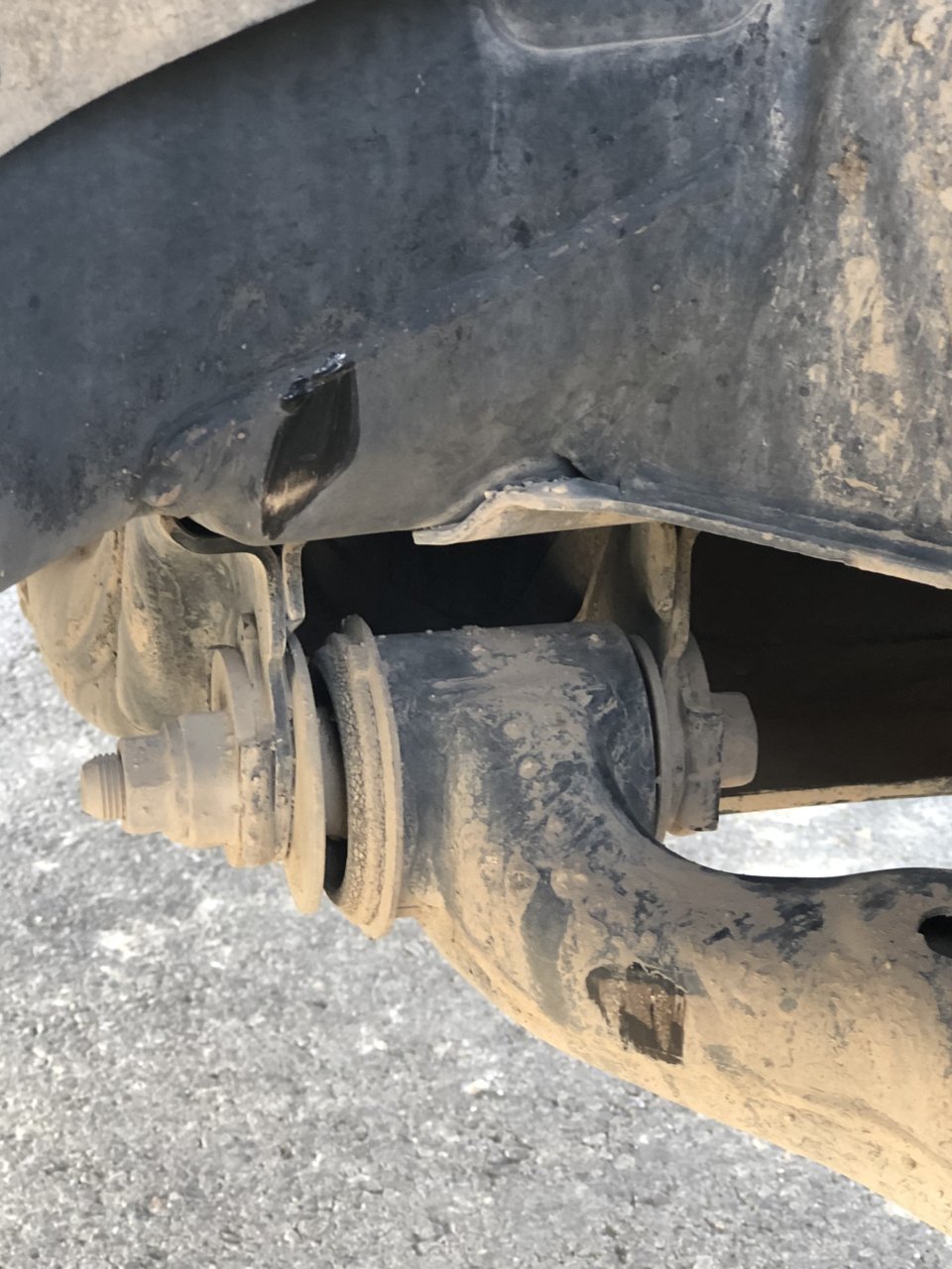

    I’ve got geolanders 255/85/16s and I’ve notice the mud has been rubbed off of the frame and part of my LCA. Should I be concerned about my tires rubbing against the frame?

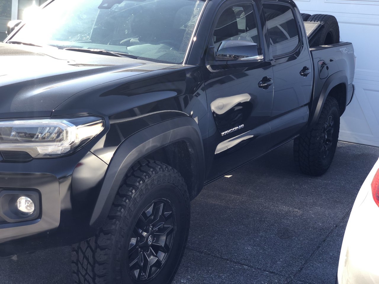

    Just got mine put on a few days ago thanks to this thread. 255/85r16 Cooper ST Maxx on a stock OR. Love them so far - perfect height and aggressive look to them. Don’t notice a difference in road noise vs the stock wranglers, but I haven’t taken them to 60+mph yet.
