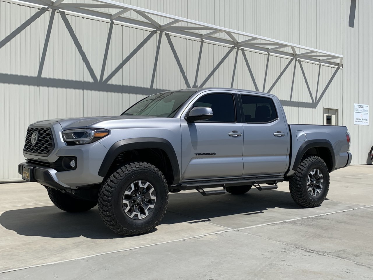

    Eibach Stage 2 1.jpg BFG MT KM3s

    Doesn’t look like stock suspension whats the details

    Eibach Pro Truck Coilover 2.0 Stage 2 up front with about 2" of lift, 1" block with Eibach Pro Truck Sport Shocks in the rear.
    I did have the tires on for a few days before the lift and had no issues with rubbing.

    Factory uca? And rub on them? Your not runnning wheel spacers right?

    Yes, stock UCAs. No rubbing, no spacers.

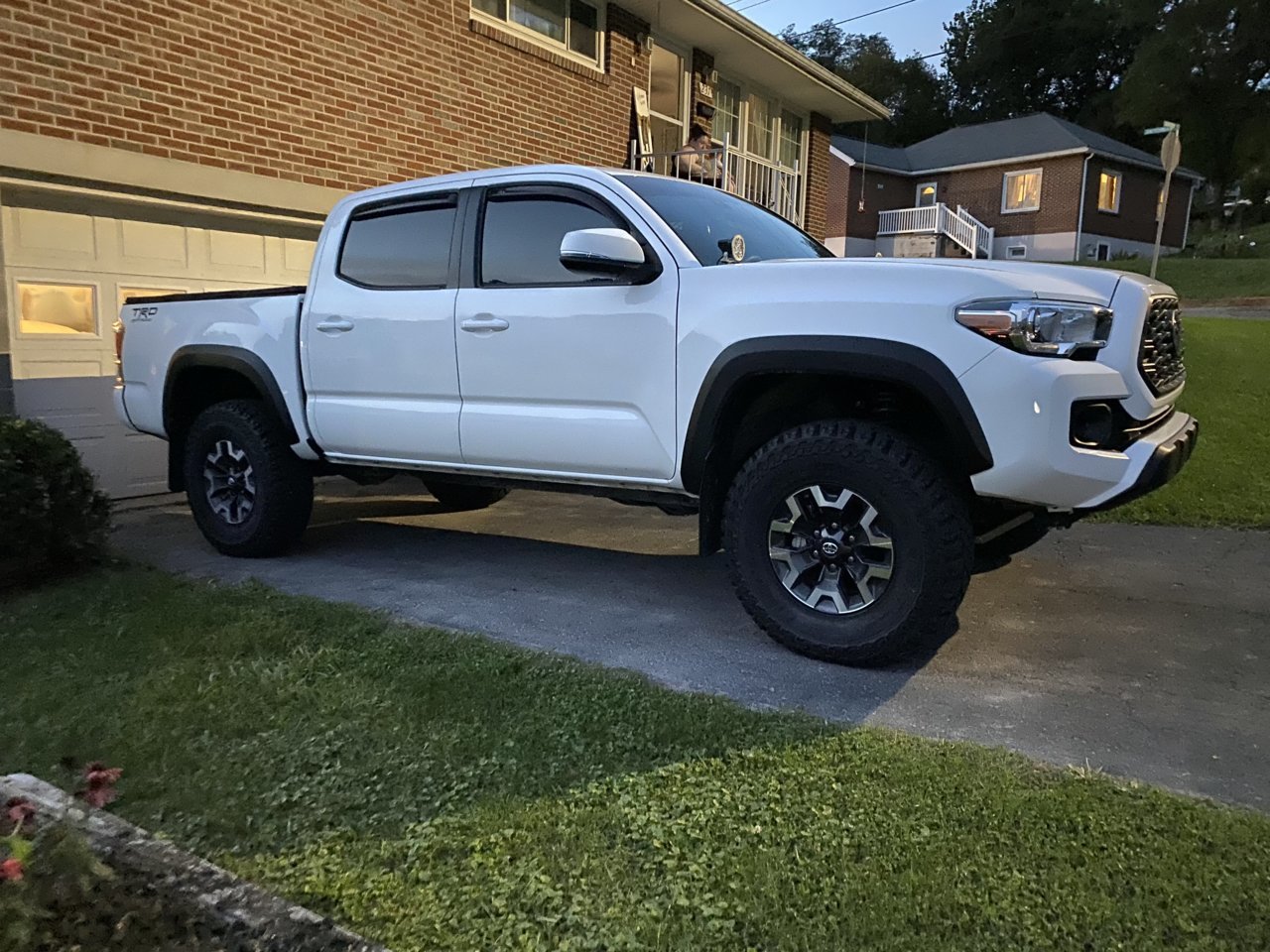

    Got my 255’s on this evening. Just gotta figure out how to get the spare under the bed now. No rub 2” lift factory wheels no wheel spacers.

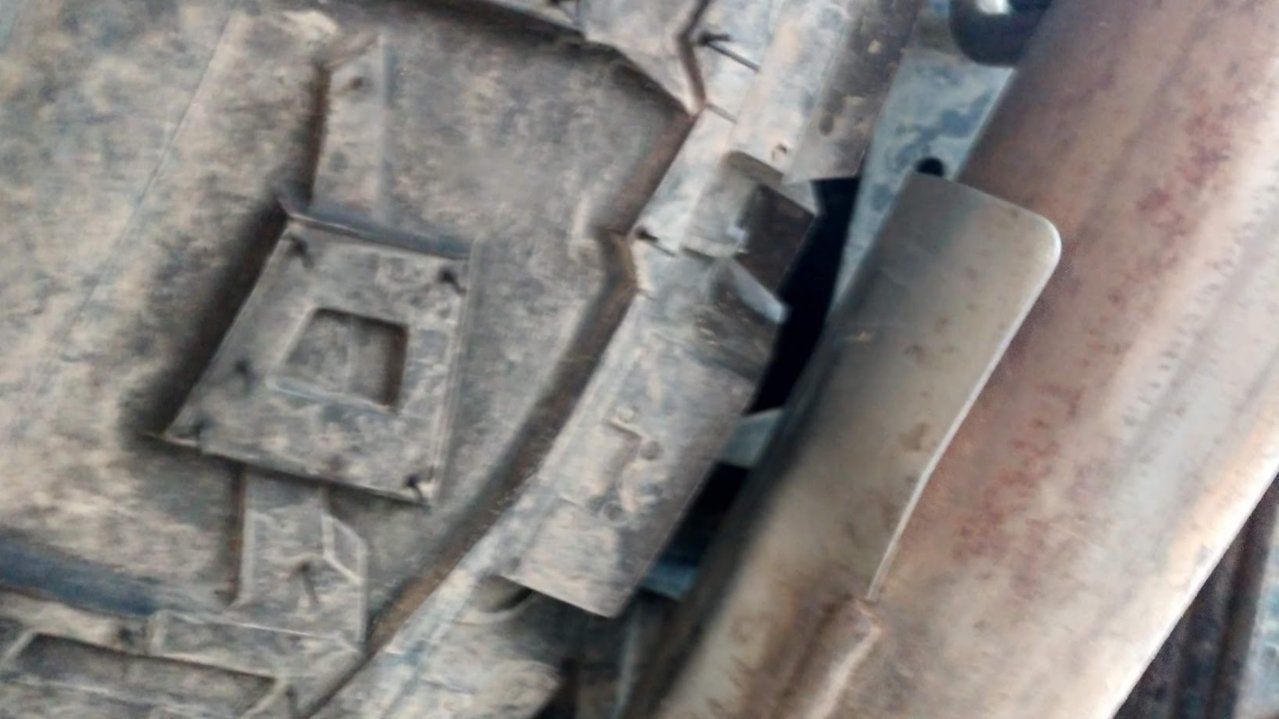

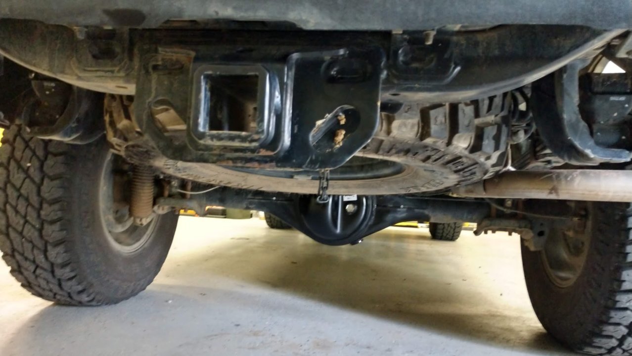

    I just stuck my 255/85 16 under there, no mods no drama. It's been fine for a year now.

    Pics?
    On my second gen i just bent the two tabs flush and didnt relocate the mount but i did have my exhaust dumped already. I was hoping to not mess with the exhaust but i will if needed.

    Tight to the exhaust but it works hows the clearance to the diff?
