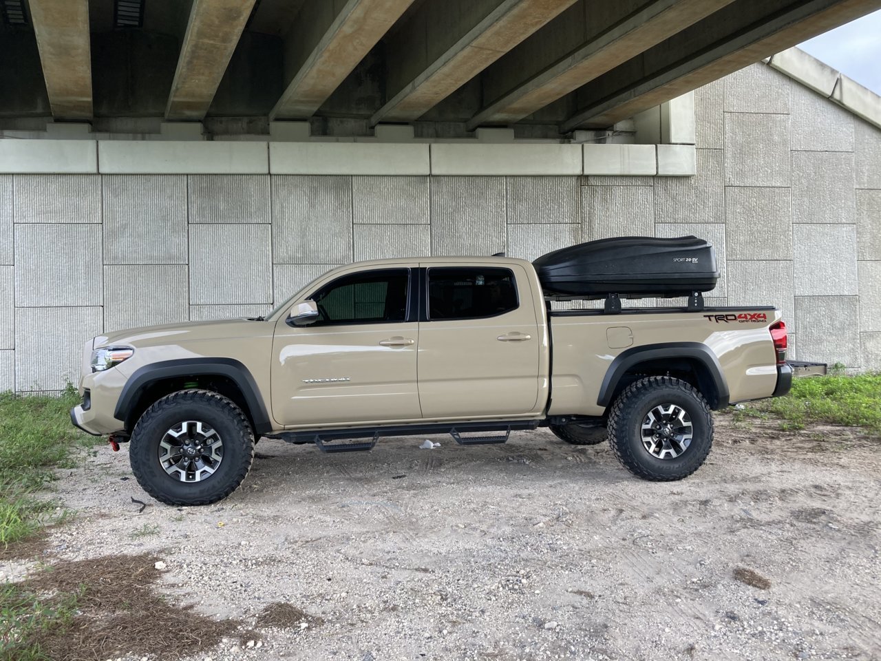

    Im really digging my 255/85/16 KM3 on stock OR wheels. havent had any issues on nor off road... still trying to find the best PSI for daily driving... I do have Ironman 2" lift no UCA
