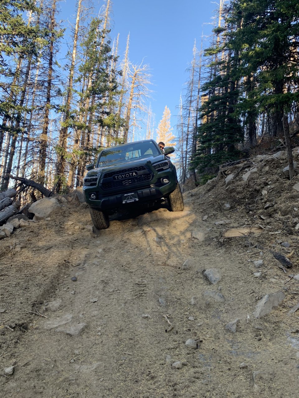

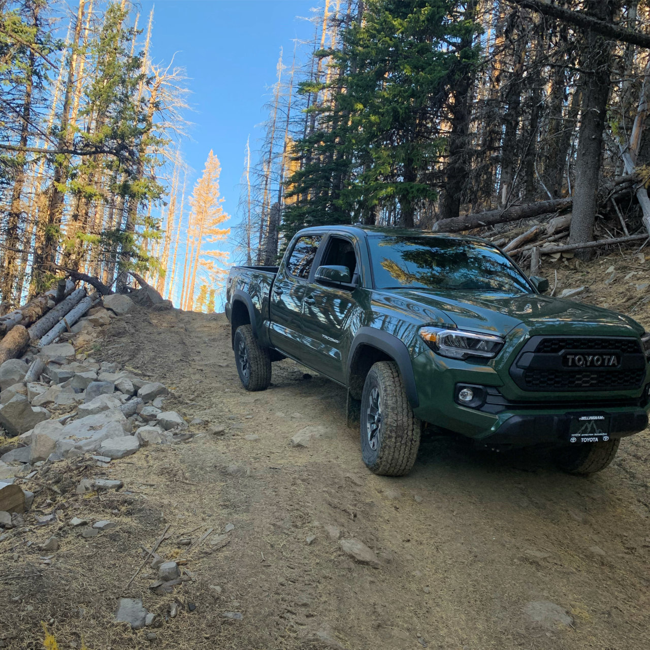

    Totally agree! Put 600 miles on them this weekend between wheeling and pavement this weekend. Love the tires!
    Had a tiny bit of rub twice when going down a steep decline and full turn. Barely noticeable, but checked anyway. Driver side rubbed on the mud flap about the size of a quarter.
    So happy I got these!
    Brkn likes this.

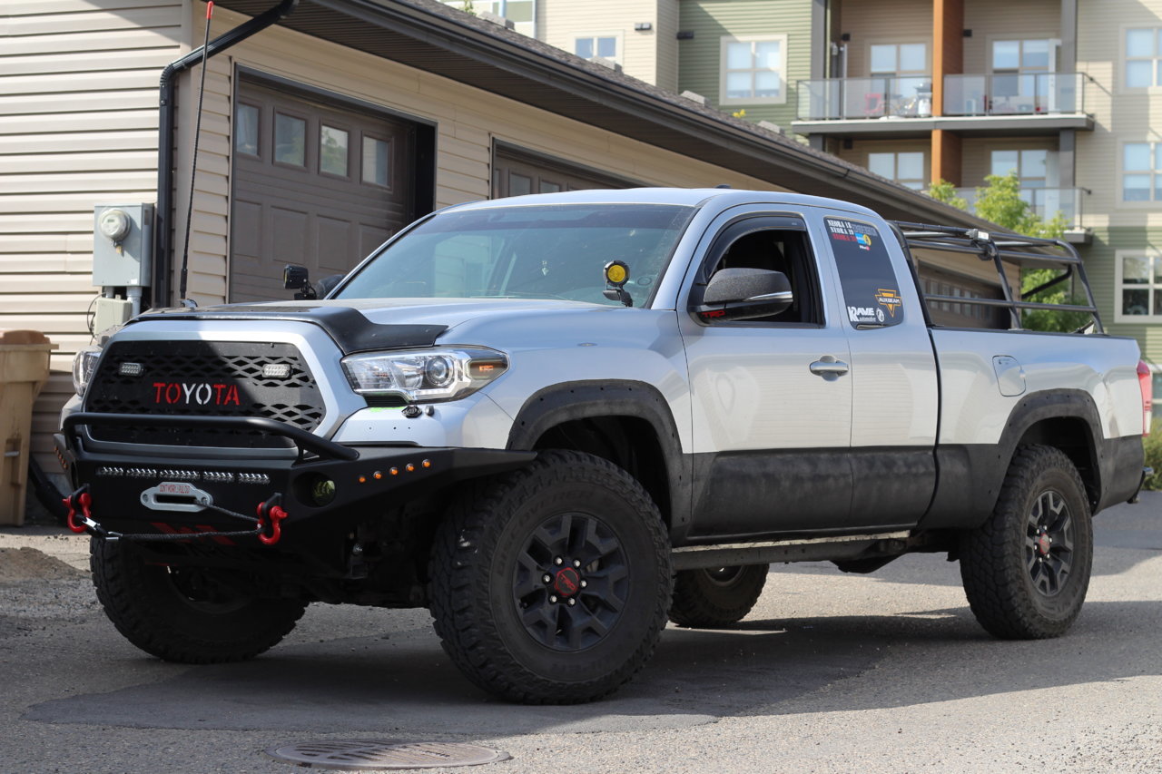

    Just Thought I would post up my taco in the 255 thread here! Second Set Of This size! First was Toyo MT, now the cooper St maxx! Loving the look more of the st maxx the more they are on the truck! Been running this tire size for over 2 years. Loved it stock and even now with my minor 2" lift! Even with my new bumper the look of the "skinny" is still great IMO! Best tire size for these trucks!

    The Cooper ST MAXX works great.
    Ask @supralee about the noise.....he picked up my other tires and we went for a ride.
    TBH we haven't noticed any issue with the tires at all.
    GillyLink and ownubad like this.
