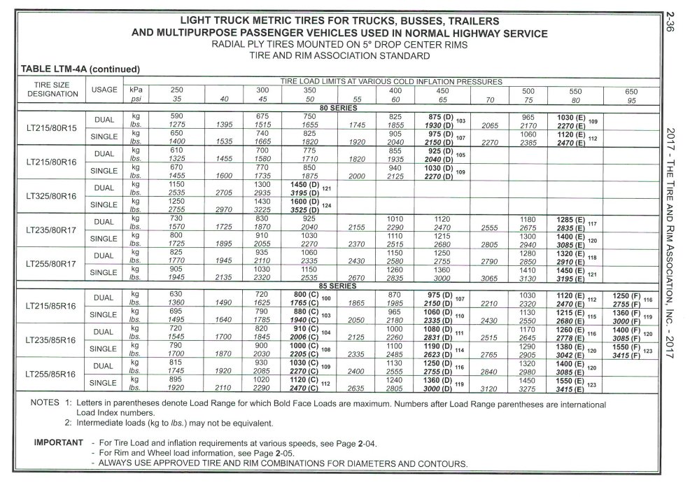

    enduringsnark
    enduringsnark Member
    Jan 3, 2018
    #240185
    16
    The Pines, NC
    '17 OR DCSB Silver
    Not sure if this helps anyone, but Cooper sent me this when I asked for a load/inflation table on their 255/85R16 ST Maxx tires.
    Unrelated but extra datapoint fwiw, usually run mine ~32 psi; never had any rub issues on stock OR alloy wheels.
