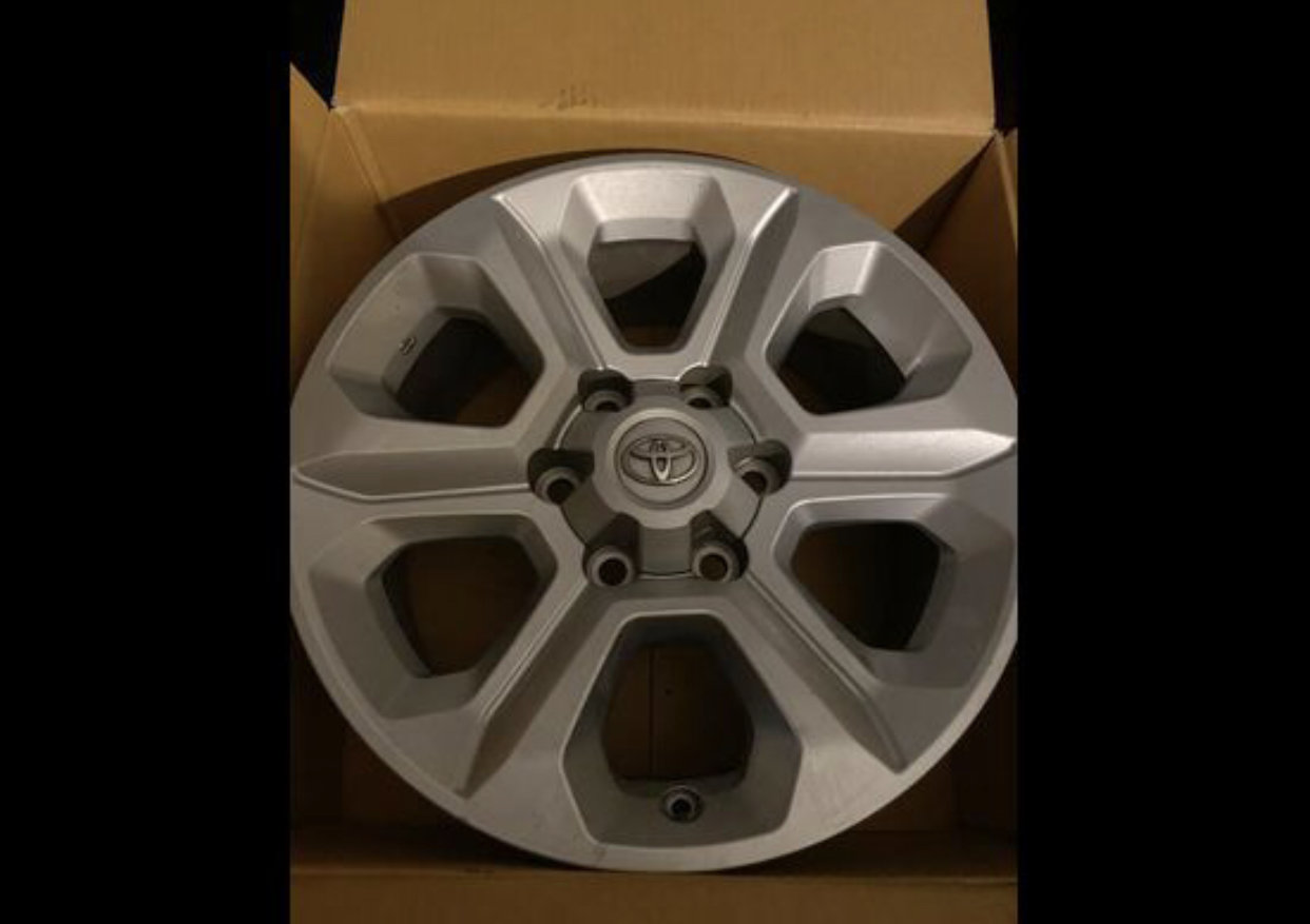

    I have been considering this route, too. There are a lot more choices with a 17 inch rim.

    I’ve been trying to research how the new 4 runner 17” non pro wheels would effect tire fitment. I want to say somewhere I saw that they have a bit more offset but don’t quote me on that.

    I like those, or the 4Runner Off Road wheels.

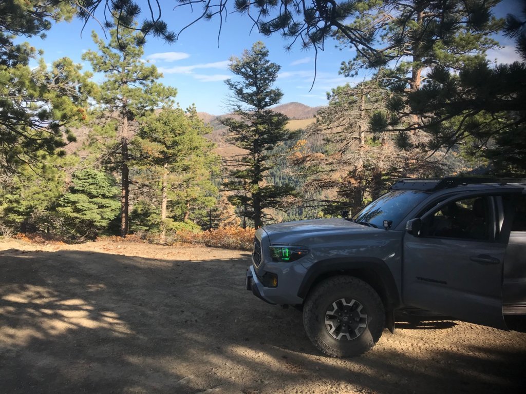

    We went with the 255/85 R16s . Plain and simple, did not want to get other wheels.
    Our mileage is just about the same over 8 tanks. Not from the MFD as that (as far as I know) can't be corrected w/o getting something else.
    Here is what my wife and I figured out....some of this will be anecdotal stuff from the change from stock to ours.....
    1. Little higher on getting into the truck. LOL......
    2. ZERO noise issues. We noticed nothing but we do have a Prinsu and some other mods.
    3. Tires are GREAT! Several trips over 1000 miles of fire roads and places we should not have gone.......(they work) Zero issues.
    4. Subjective....from my standpoint as I already have tons of weight for armor, roof, DB and camping gear.....no changes
    5. Acceleration, perhaps a "tiny" bit getting out of a turn with a stop light, but nothing major.
    6. Pen to paper....this one will be tough. I found that we gained "yes" gained about .2 mpg
    -- I think it is because I drive it a bit different. Not sure but since the new tires are on, I find myself not SLAMMING the skinny pedal down.
    7. Off road.....no comparison....LOVE the tires! I honestly was kind of hesitant on what we had....now I simply don't care. They just work.
    I think that the "Skinnies" we have are perfect for us.
    To the question posed. DD is great with us. Fire roads and off-shoots no issues whatsoever! BUT.....Baja? No experience with that. From prior experiences with the Jeep I found that wider tires work better in sand. However, at our trip in the Great Sand Dunes, we just aired down a tad bit and the Taco did great with the tires....
    Someone else may be better served to say how the different tires you mentioned would work. I will tell you this though....we run a shit ton load of gear in the back of our Taco....last weighed on "Trip stuff" we had 900 lbs in the back and no issues with our tires.

    Front tire clearance from a pic we took Close in front. No issues though
    Another shot for perspective.
    Again no issues. BUT I will say when they are put on go to a good alignment shop/person you trust as when these go on you WILL need to simply blow off the Standard Tacoma alignment.
    The back of the tires will not be an issue whatsoever if on Stock wheels. The Front has about a "quarter" aka the coin.
    The only issue for us on STOCK wheels and NO LIFT was with a HARD turn and going too fast ...operator error....but SLIGHT rub on the passenger side front wheel well.

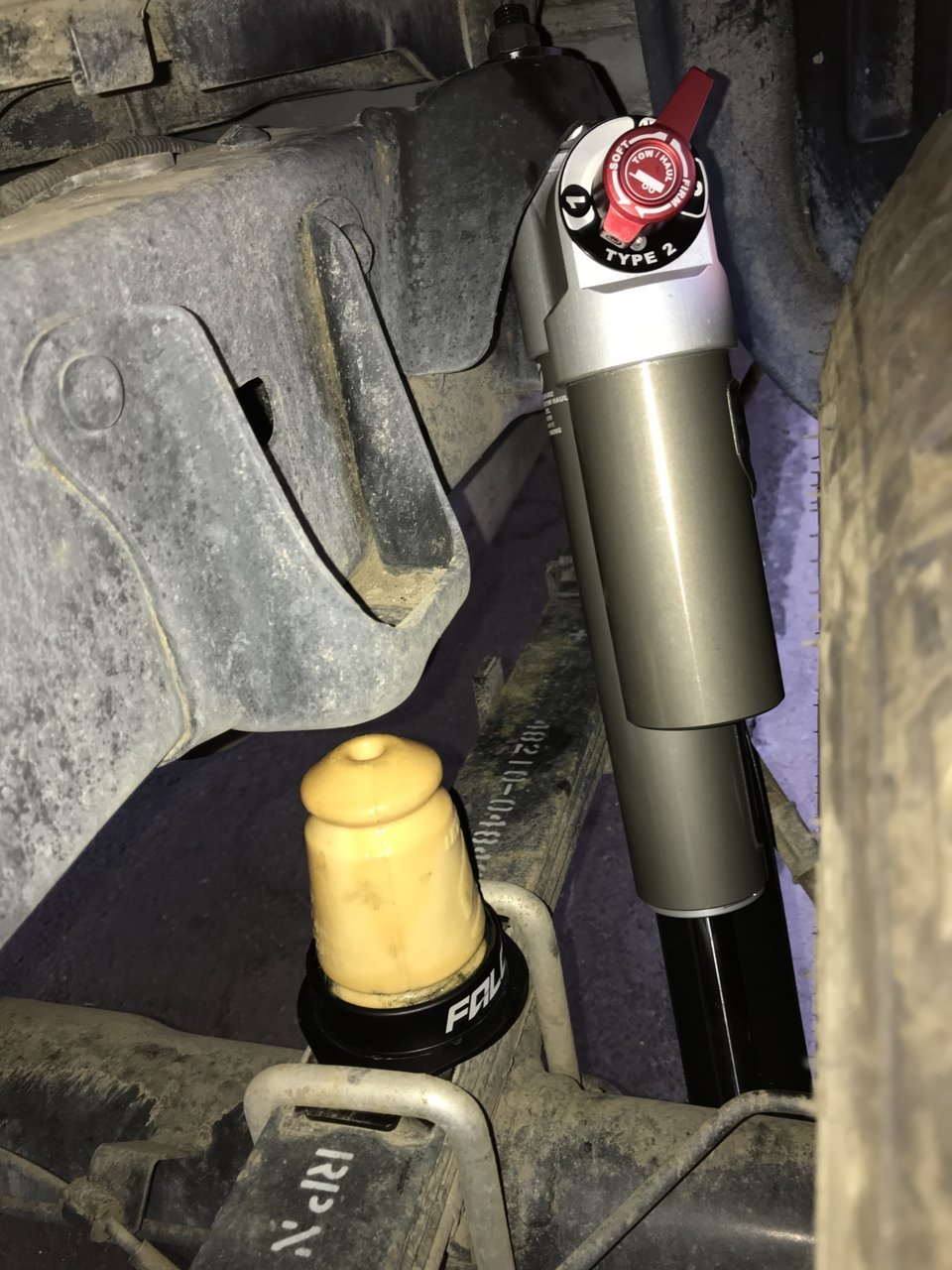

    OK, 2021 Tacoma TRD off-road. I have falcon shocks ready to go on Friday and lt255/85r16 Cooper ST Maxx. Everything should fit with no rubbing but now I either need wheel spacers for the rear Falcon Shocks or cut the shock bucket so they don’t rub a stock offset wheels. If I end up installing the rear spacers I want to install them on the front also, will the tires still fit without rubbing?

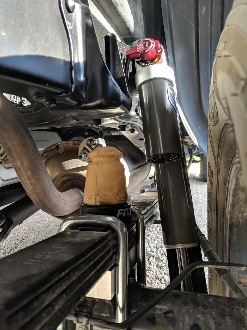

    How would they rub the rear shock bucket with stock wheels?
    Since you know.... They're stock. They don't rub. Unless the image in my head is just wrong

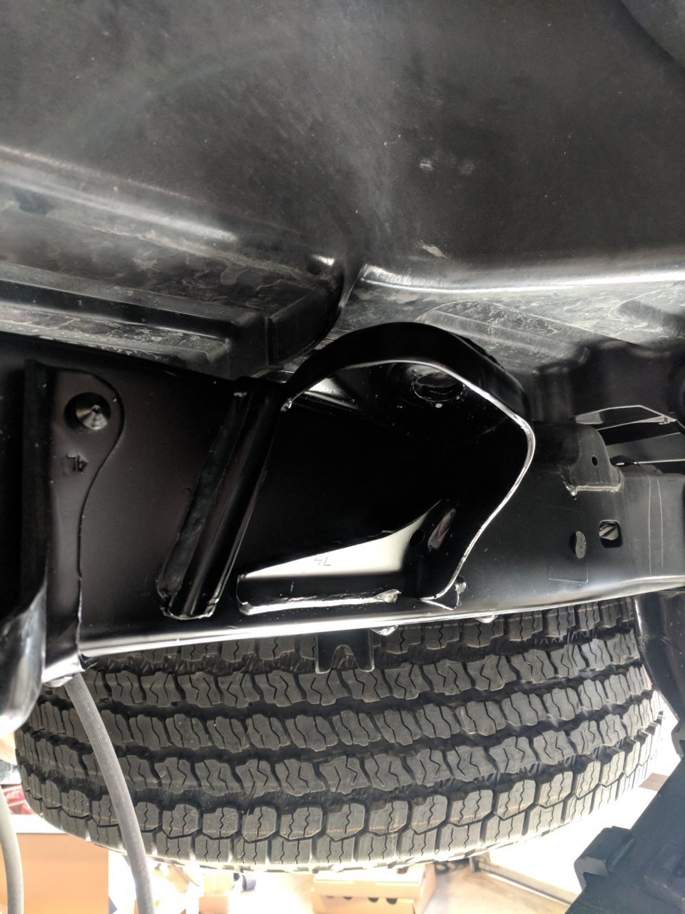

    photos belong to someone else on here, top photo is of the shock bucket cut already, second photo is of how the shock ends up orientated if you have stock wheels and choose to cut the bucket so the shock reservoir doesn’t rub on the tire. Third photo is of a truck with aftermarket wheels with more negative offset and shock installed without cutting shock bucket.
    so I want to avoid cutting and ordered 1.25” wheel spacers but now I’m wondering if the 255/85R16 coopers (not installed yet) will rub on the front if the spacer is used.
