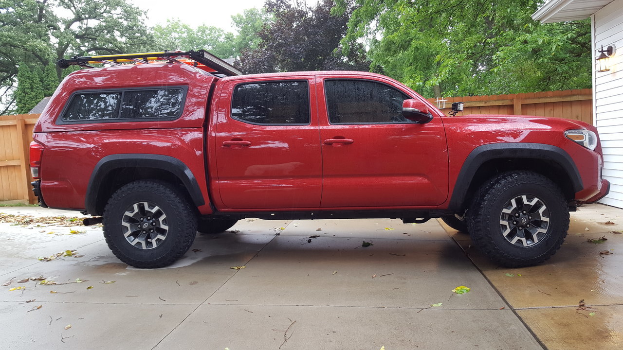

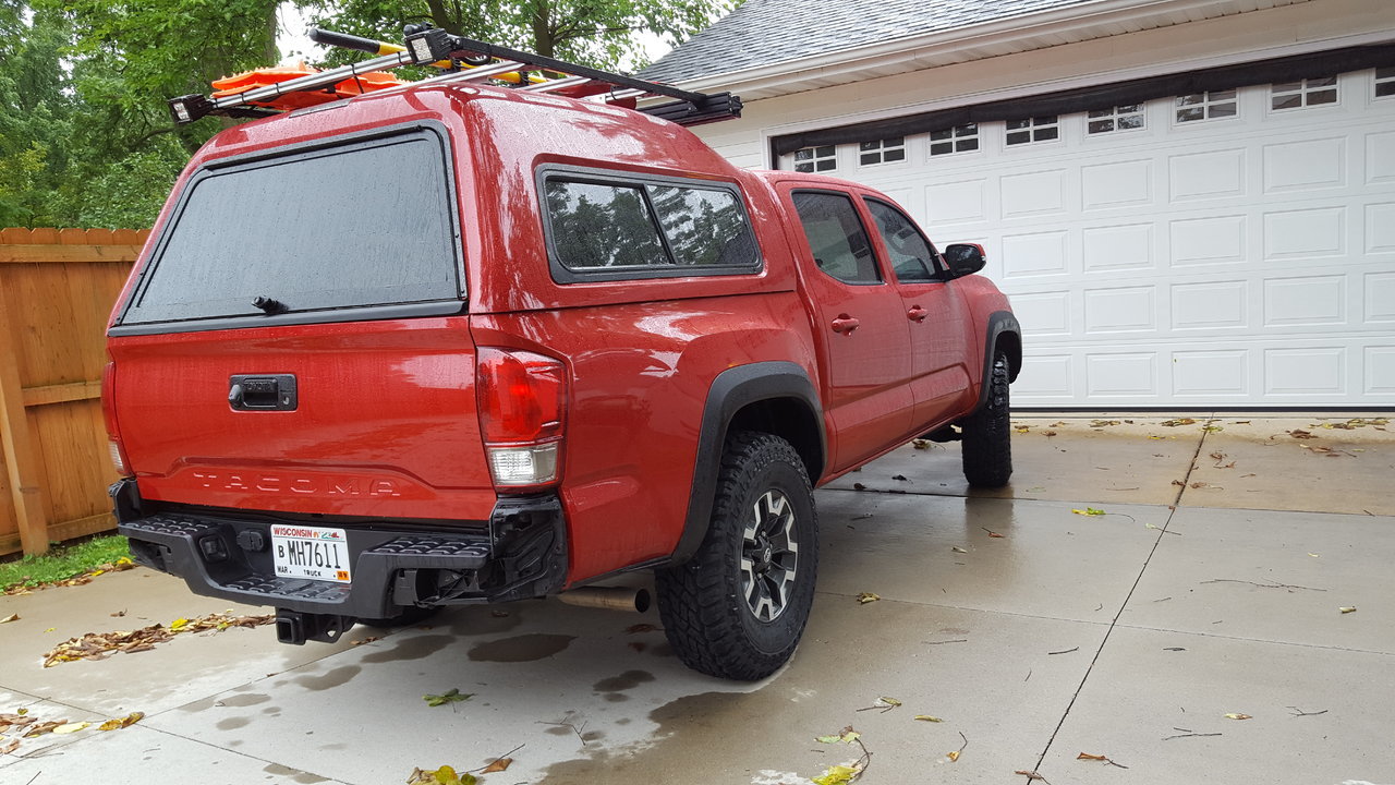

  7. Aug 4, 2017 at 8:08 AM
    #287
    ajmogen
    ajmogen Well-Known Member
    Apr 13, 2016
    #184199
    1,874
    Aaron
    Wisconsin
    OR MT TACO T4R YARIS MT Corolla Hatchback MT
  8. Aug 4, 2017 at 8:11 AM
    #288
    EatSleepTacos
    Mar 24, 2015
    #151688
    59,826
    Randy
    West Valley, AZ
    2017 4Runner
    Really digging that rack set up. Nice work!
    ajmogen[QUOTED] likes this.
  9. Aug 4, 2017 at 8:33 AM
    #289
    Sandytaco14
    Sandytaco14 IG: qstaco17
    Nov 16, 2016
    #202580
    5,641
    Andrew
    North al
    '17 trd offroad 4x4
    Looks sick as tits!!! I don't think you'll be disappointed with the maxx

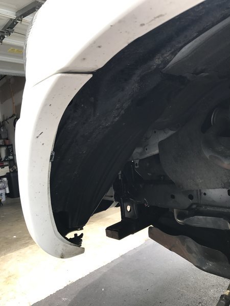

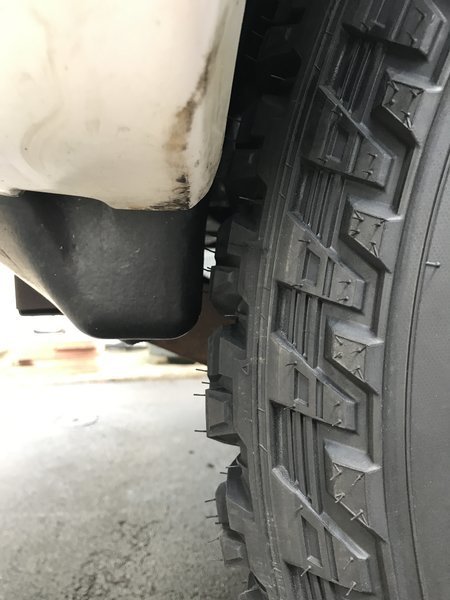

    Undo do the two bottom bolts in the front holding the fender liner. There's also a single body clip to remove too. This will allow you to push back your liner (leaving it in one piece) and ziptie it back out of the way, while still offering protection. Exactly what I did on my truck.

    @Camel89 Here's what I'm talking about.
    Before
    After
    doublethebass and sologeek like this.
  18. Aug 4, 2017 at 12:34 PM
    #298
    Camel89
    Camel89 Well-Known Member
    Nov 30, 2015
    #171087
    448
    Houston, TX
    2016 TRD OR 4x4
    Yea factory OR wheels. I think they're both around 3 degrees. I'll have to find the results and double check.
    I'll probably end up going that route since I really didn't want to cut them.
    I have SPC LR UCAs. And no mudflaps.
    EatSleepTacos[QUOTED] likes this.
  19. Aug 4, 2017 at 12:35 PM
    #299
    EatSleepTacos
    Mar 24, 2015
    #151688
    59,826
    Randy
    West Valley, AZ
    2017 4Runner
    It's probably because you have more caster than most of us can achieve on stock UCAs, and that's what's pushing your tire forward into the liner. Better than rubbing the cab mount though!
    sologeek likes this.
