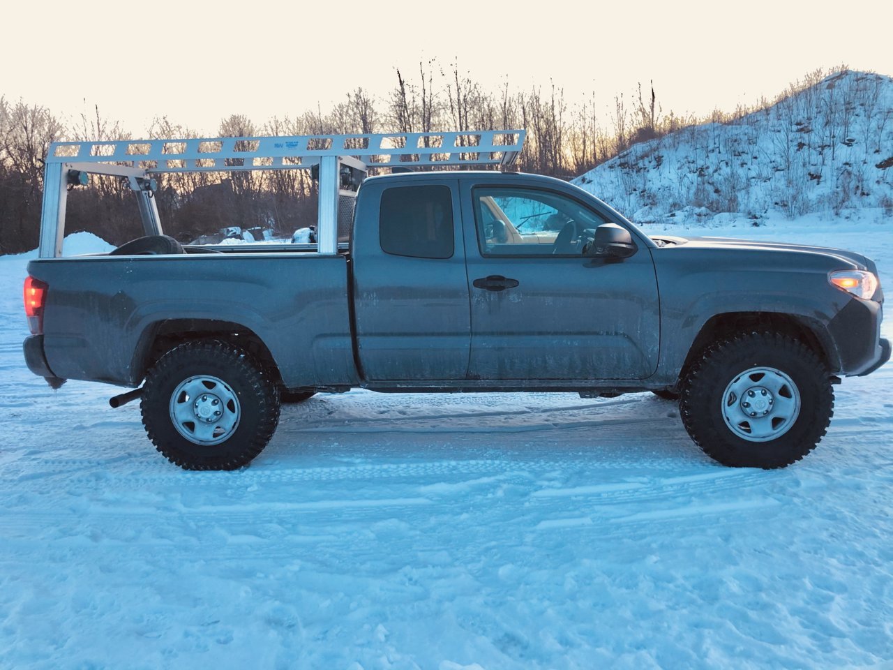

    Hello everyone.
    Posted this in the 3rd gen thread as well but figured I would help out since I took the risk on the tires.
    I have a 2020 SR Access Cab, 4x4, Utility Package.
    I plan on using it for overlanding to alaska/mexico and south america, and based on my experience with the Falken Wildpeak AT's previously, went with a set of
    255/85/r16 Wildpeak MT01s.
    Paid roughly $850 shipped for a set of 4.
    My truck is currently BONE STOCK, and in fact the rear is probably sitting a little lower because I have a ~100 lb rack and ~130 pounds of tires in the bed right now.
    These tires fit PERFECTLY, pics below. Tech installed them no problem, on the STOCK steel wheels. I had ordered a set of 0 offset wheels from BB wheels because I thought I'd need them to clear the UCAs but the wheels that were sent didn't fit at all, and to my surprise the tires fit on the stock wheels. I have a very SLIGHT rub on the UCA at full lock with articulation. I didn't even hear or feel the rub, just noticed it when I looked at the UCA and saw a very small strip where the road salt had been rubbed off.
    So this should hopefully put an end to the question of "will 255/85/r16s fit stock"
    They fit, no rubbing on cab mount, frame, wheel wells, etc. No cutting needed.

    Looks like you’ve had them in the snow! How do they do on road snow? Highly considering those tires but I do live in an area that gets snow

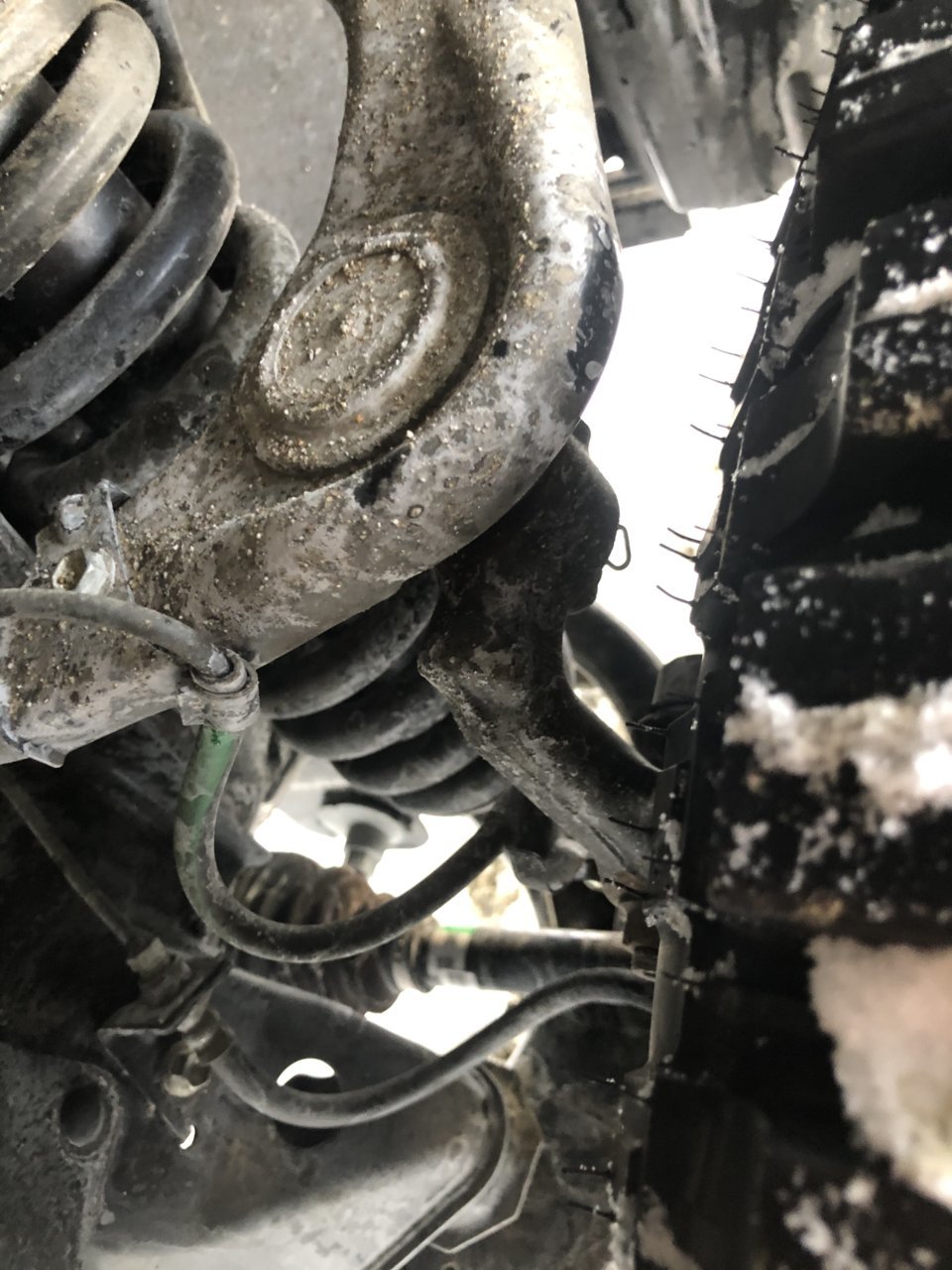

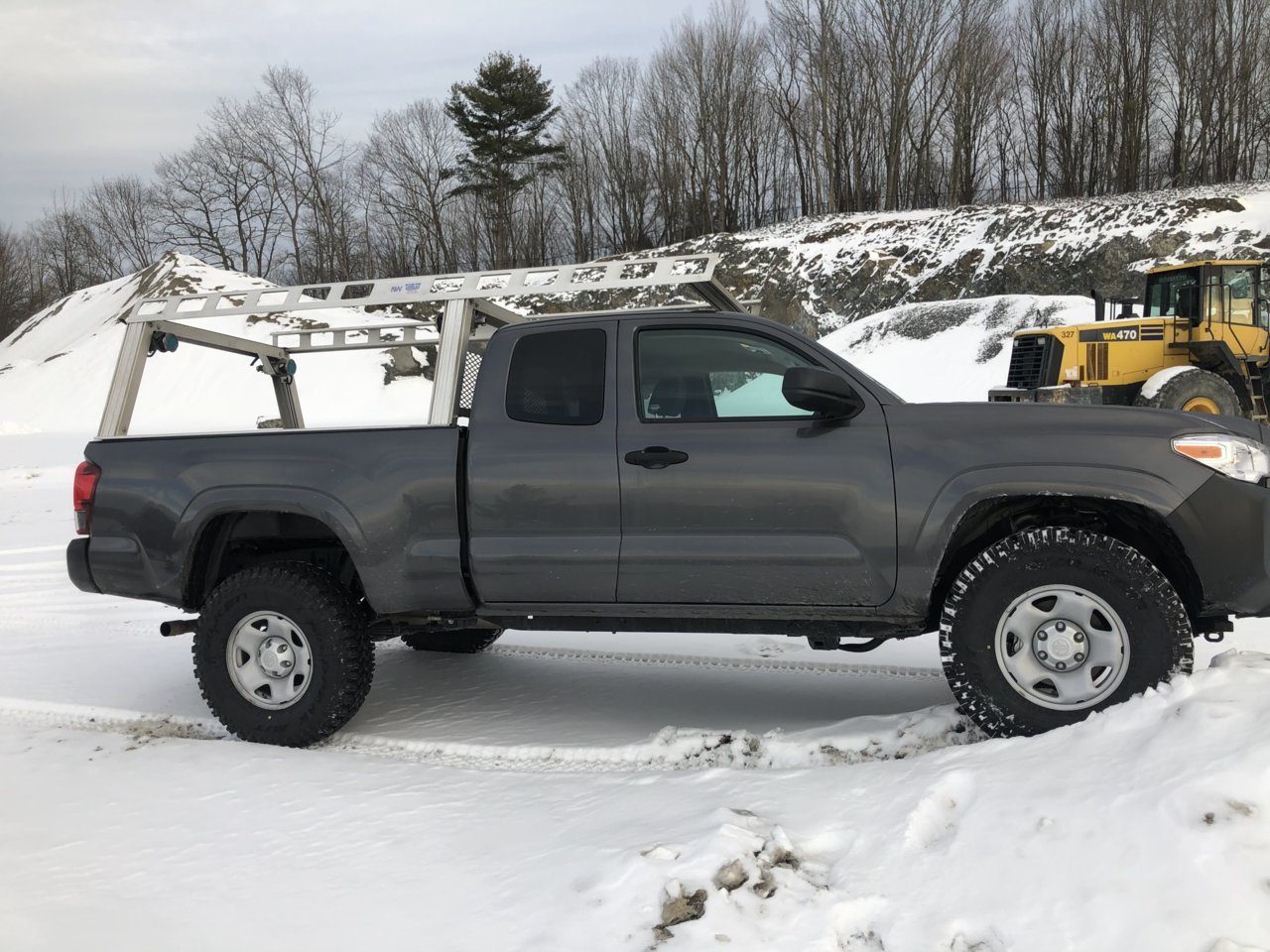

    Also, headed to the quarry and took some pictures of the fitment again with minor articulation. Still not rubbing on the UCA, frame, fender, or body mount.
    again this is pretty minor flex, but should show that they won’t rub hitting speed bumps/potholes etc

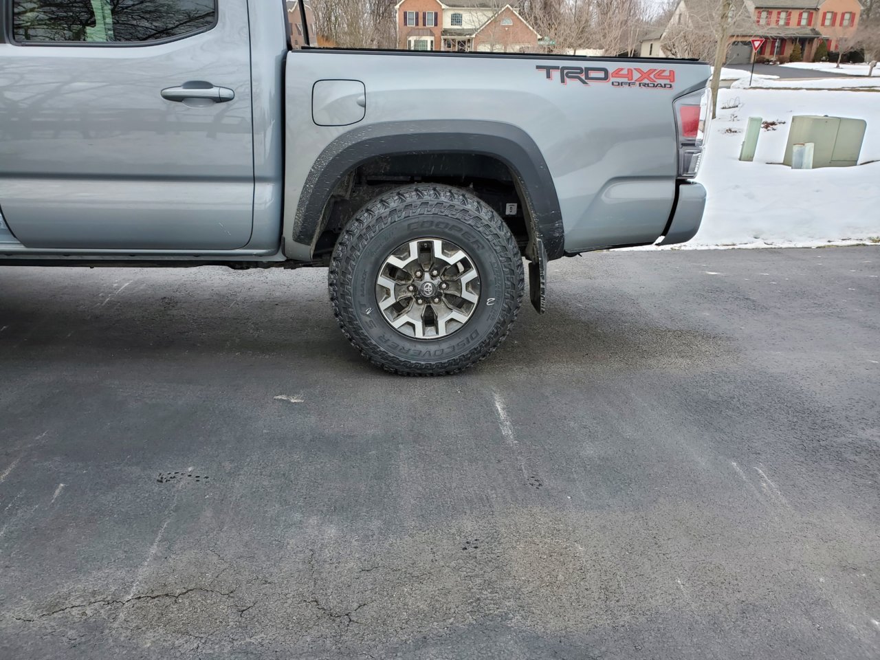

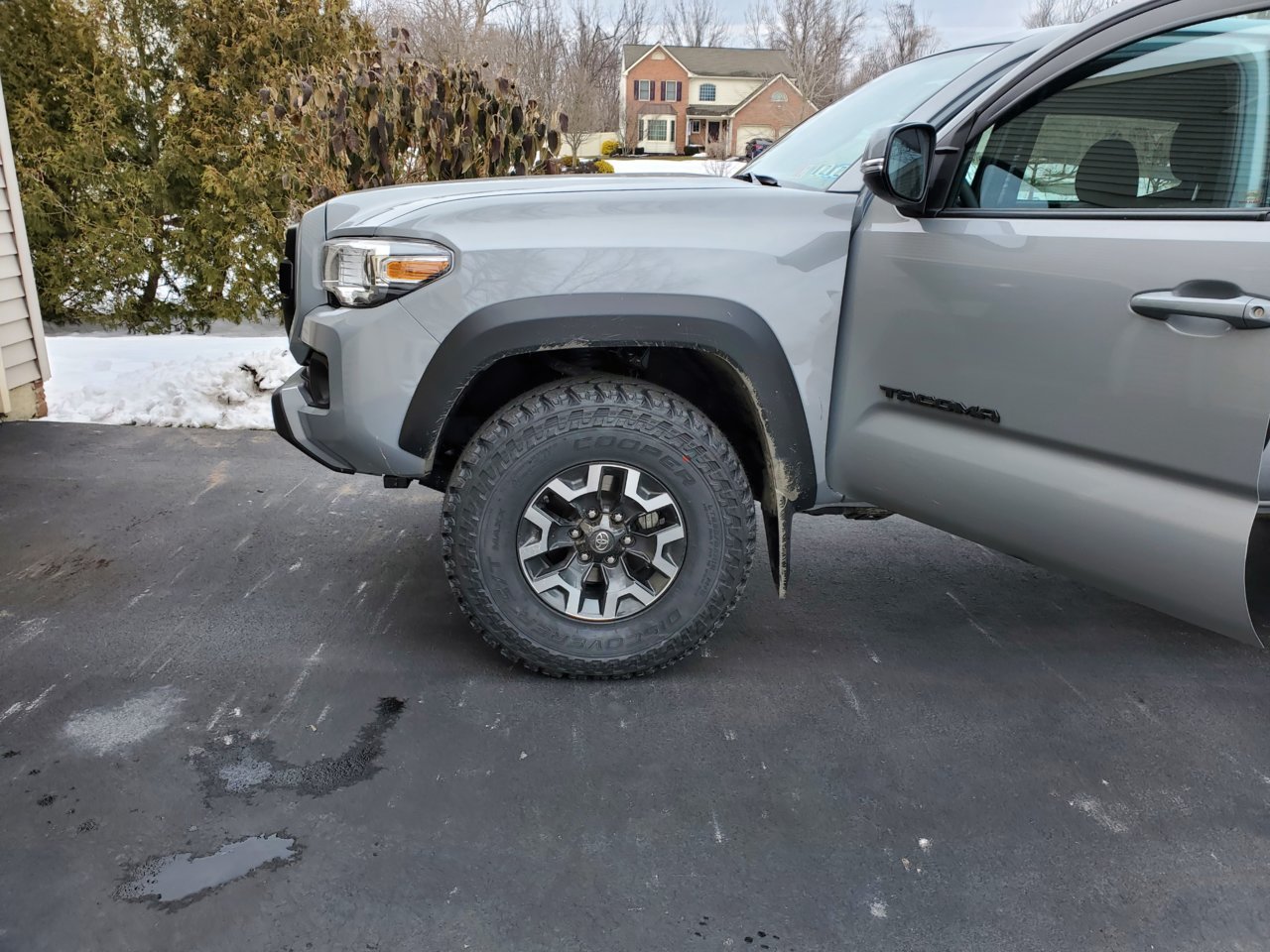

    255/85 R16 Cooper STT Maxx's installed today!
    No rubbing that I could force by turning and going up on my curb (I know it's not super high).
    No noticeable difference in power (the taco is always a slug).
    Braking distance is slightly impacted.
    They are noisier than stock but not that bad (was only up to 55 mph).
    At very low speeds you (coming to a stop) you can feel the tread rumble.
    What I noticed most was going around curves, at roughly 30-35 mph when I go into a curve - the truck feels like it's going to float off. I don't know a better to explain it.
    Anyways - Those are my thoughts

    let’s see a front end shot! I’ve got a cement too and keep going back and forth between doing these or a 2” lift and 285s.

    I'll get the front tomorrow!

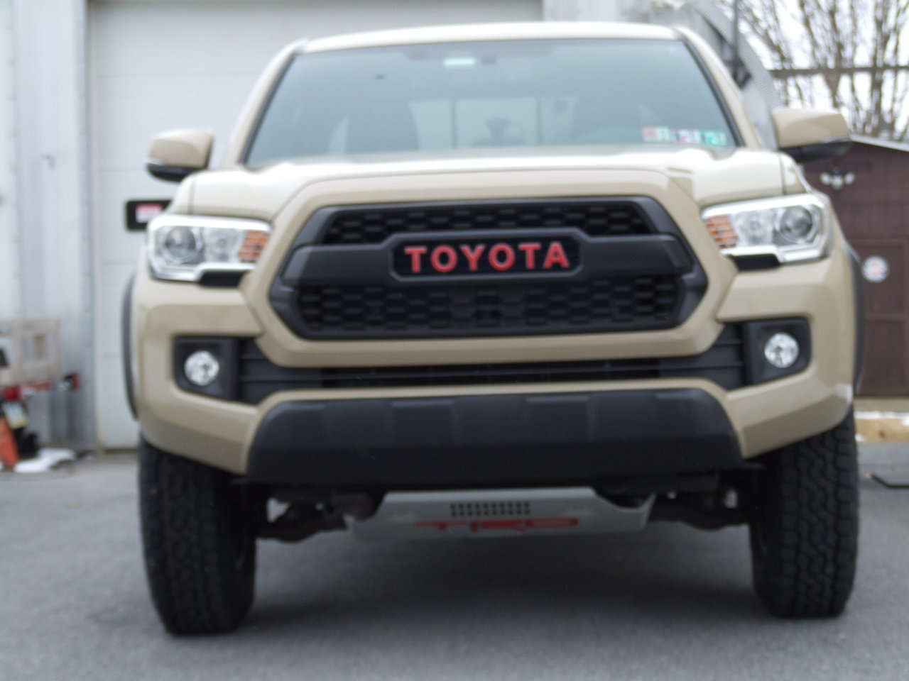

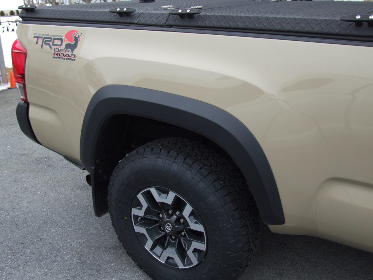

    Followed this thread a few weeks now and finally got a set of Toyo Open Country AT III's in 235/85-16 for my 2017 TRDOR long bed. My original Goodyear's still have a few thousand left on them so I'll run them this summer. They were getting kind of iffy on the snow that keeps coming here in PA. I couldn't get the Toyo in a 255 so the 235's will do. The truck rides quite well on them, a bit of whine but only a little more than the stock GY's made. Rolling resistance is way less then the stockers, speedometer is about one needle thickness off, showing 25 mph while the GPS indicates about 27 mph. No rubbing and a test in 10-12 inches of snow went great, The skinny tires dig right thru soft or hard packed snow.
    Had to wait a few days to hose off the road salt from the snow storms.
    The suspension is the next project as soon as spring gets here.

    Nice! Does having 33” tires on the truck make it feel as though you had a small lift/leveled installed?

    Short answer is yes. But however you come by your 1 inch lift (suspension of tires) - you won't really notice after a few minutes of driving.
