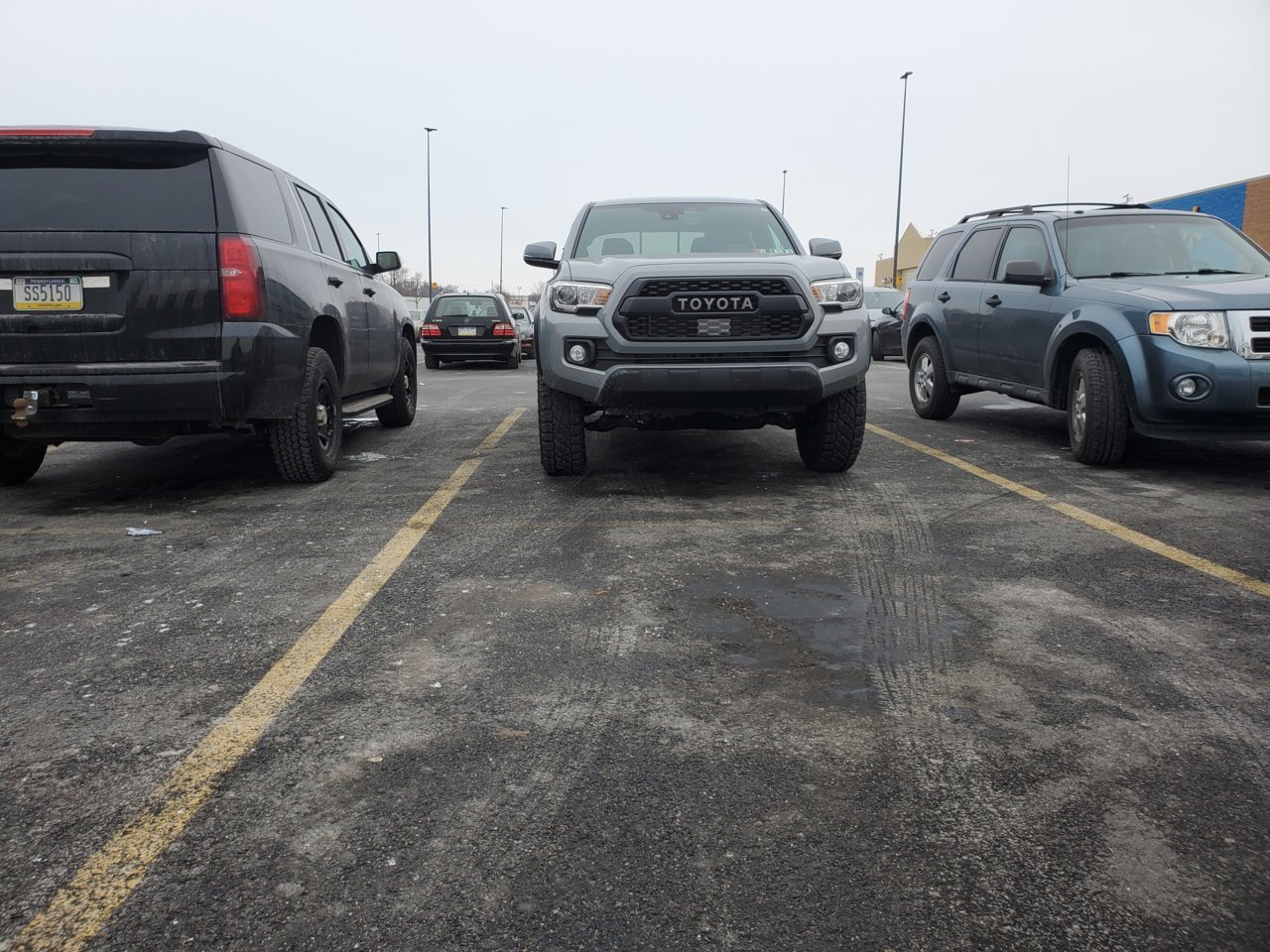

    There ya go!

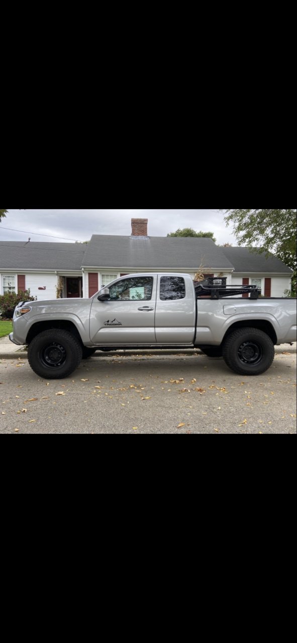

    255/85/r16, 1.5 spacers, ditch lights
    It’s not rubbing on my 3rd Gen, but it’s BARELY not rubbing. I put 1.5” spacers on now and it rubs
    the second gens are around an inch lower so you’ll definitely rub

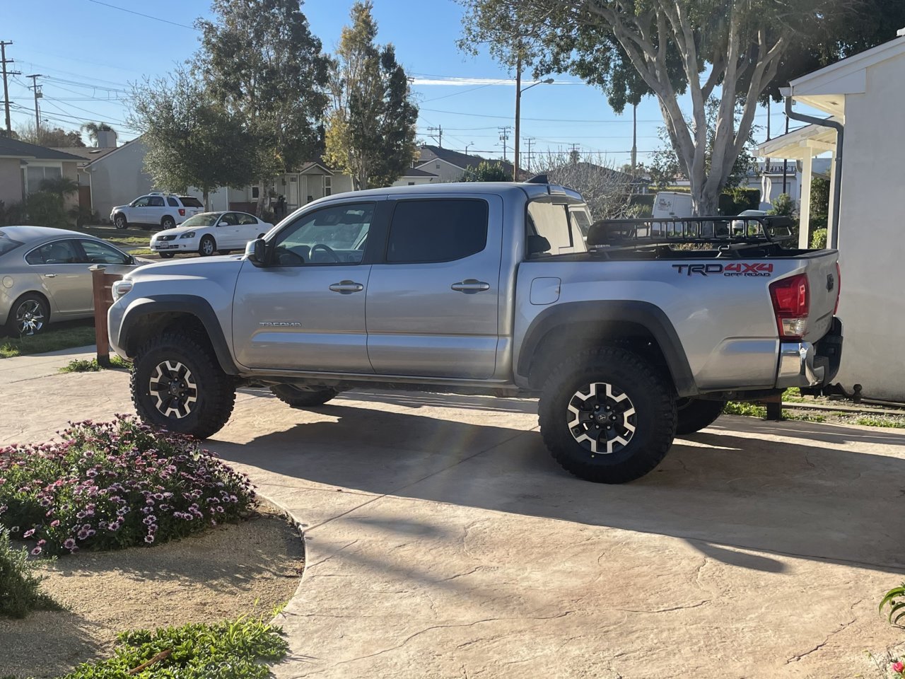

    I jumped on the tall/skinny bandwagon. Not stock suspension though. 255/85/16 Falken Wildpeak M/T on stock OR wheels with 5100’s, OME 887, 2” AAL in the back. Love it!
