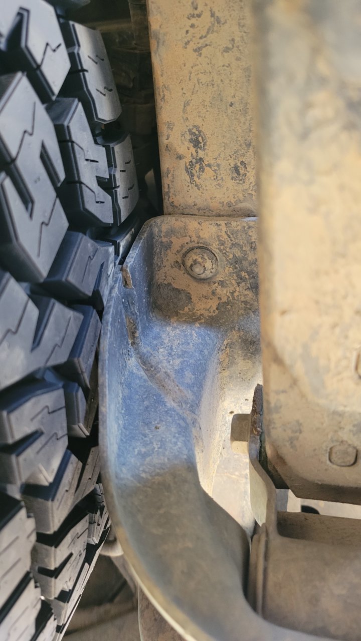

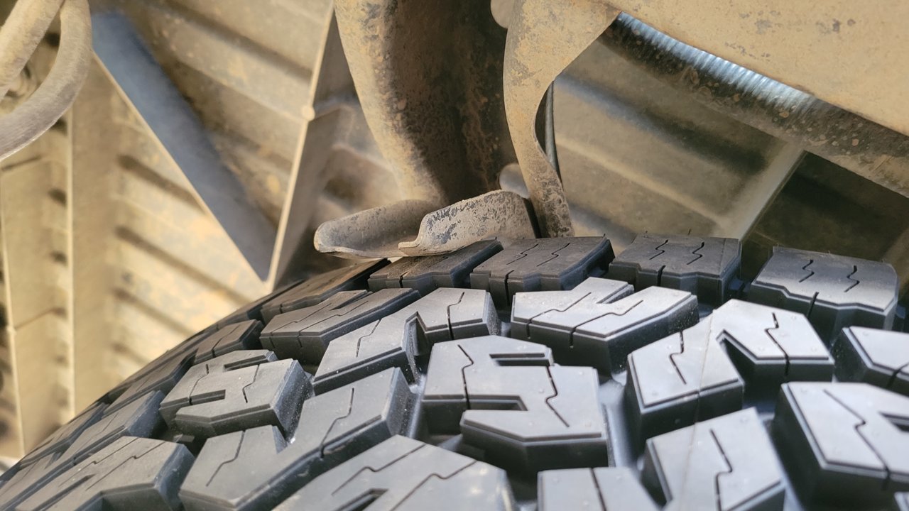

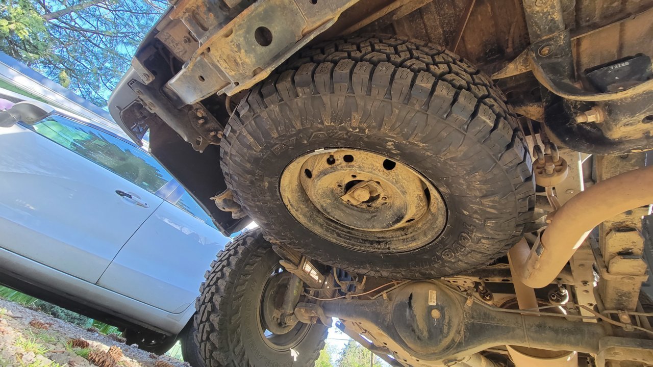

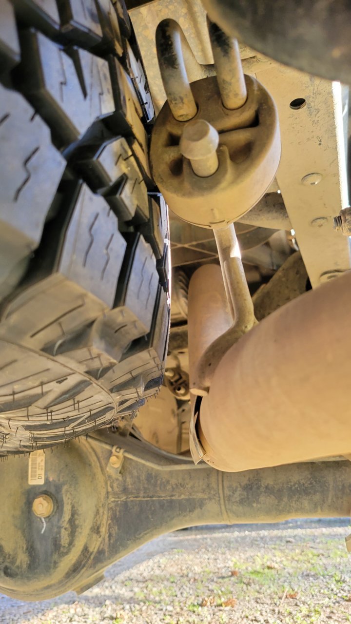

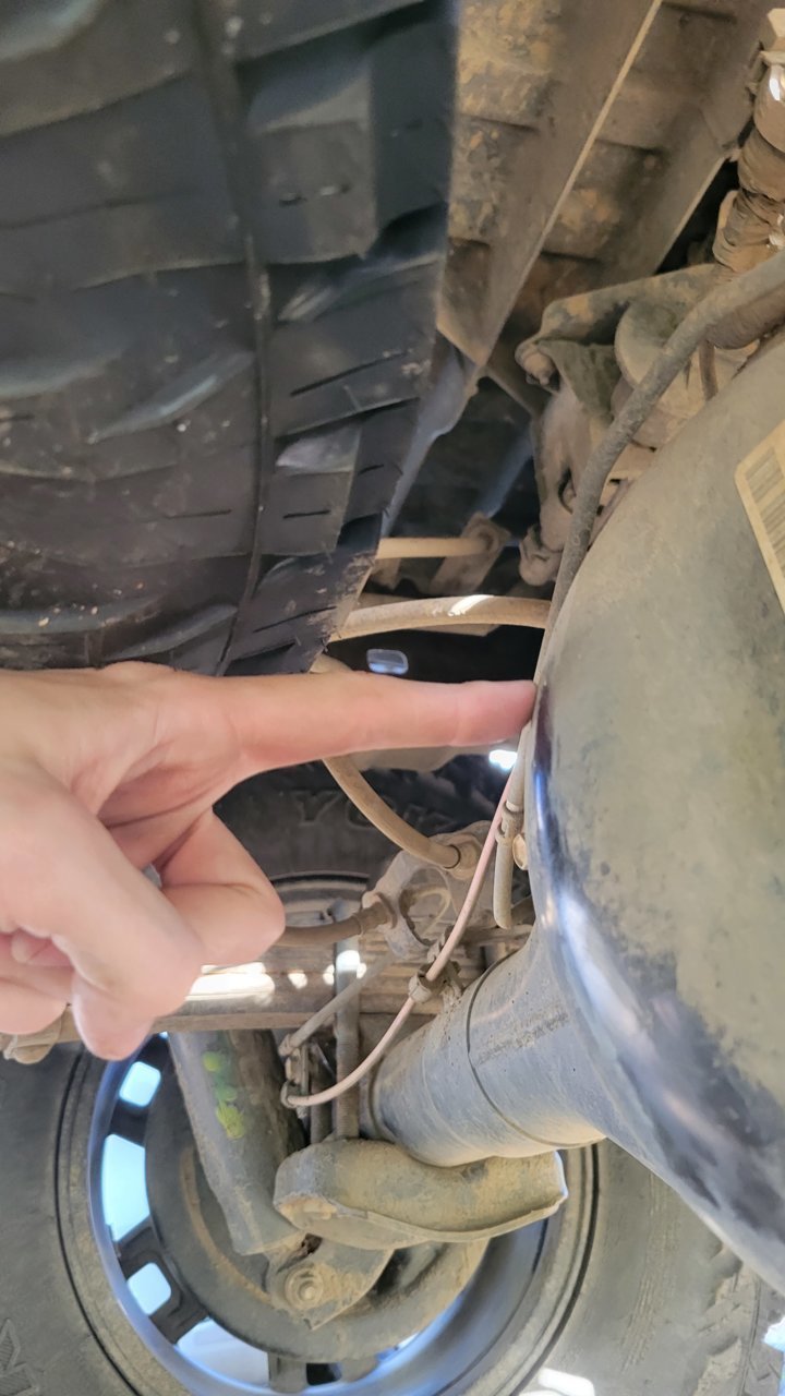

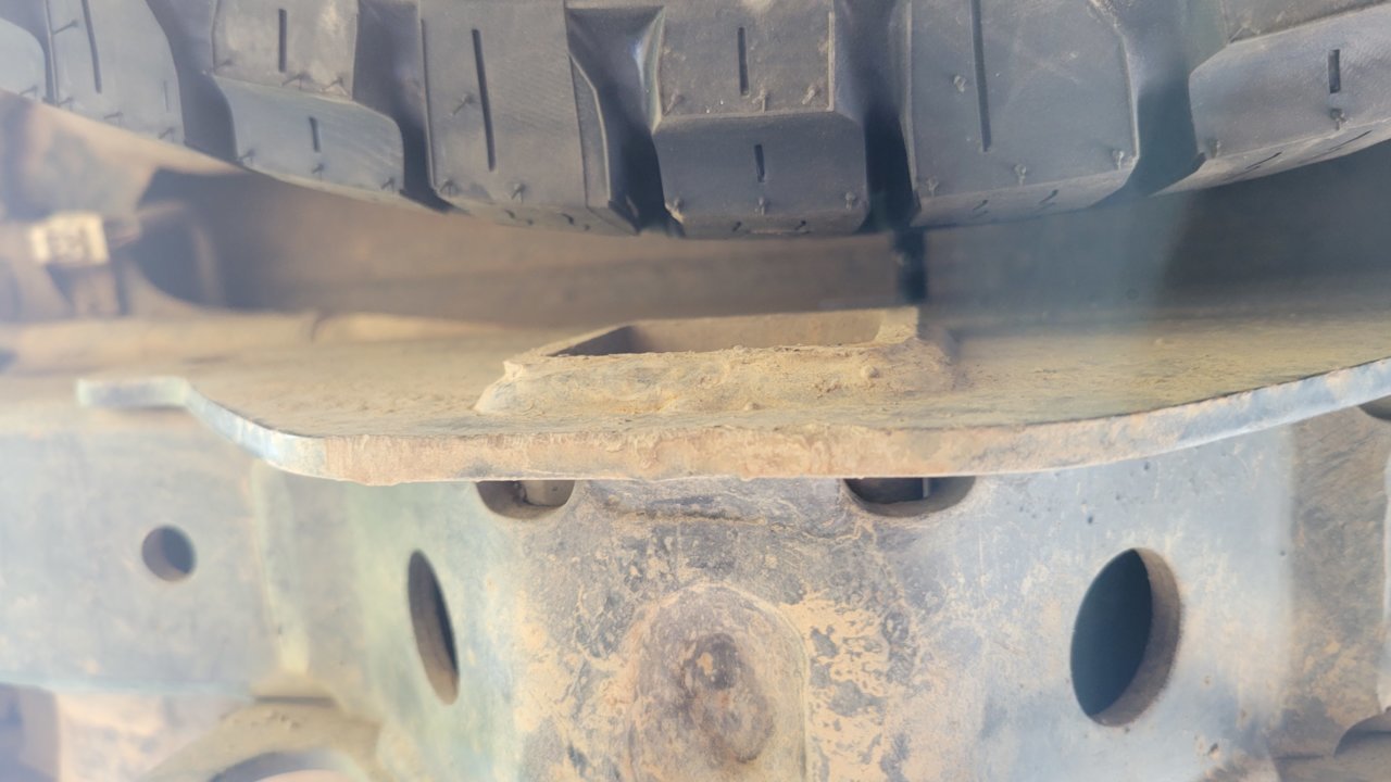

    FYI, got my spare to fit with zero modding. I run 255/85r16 Yokohama Geolandar MTs, spare is actually a 255/80r17 Toyo OC AT3 and completely deflated.

    Nice tight fit.
    I wanted to chop my tail pipe off after the axle anyway so that the tip behind the tire would never get squashed if I were to drop off a ledge and pin it. With it chopped, the final hanger was useless. Off it came!
    255/85R16 KM3 fully inflated, ready for service.

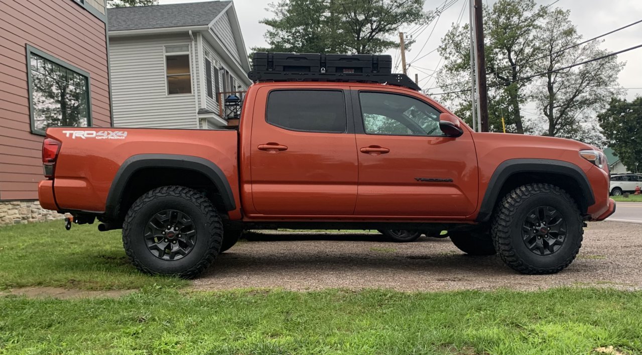

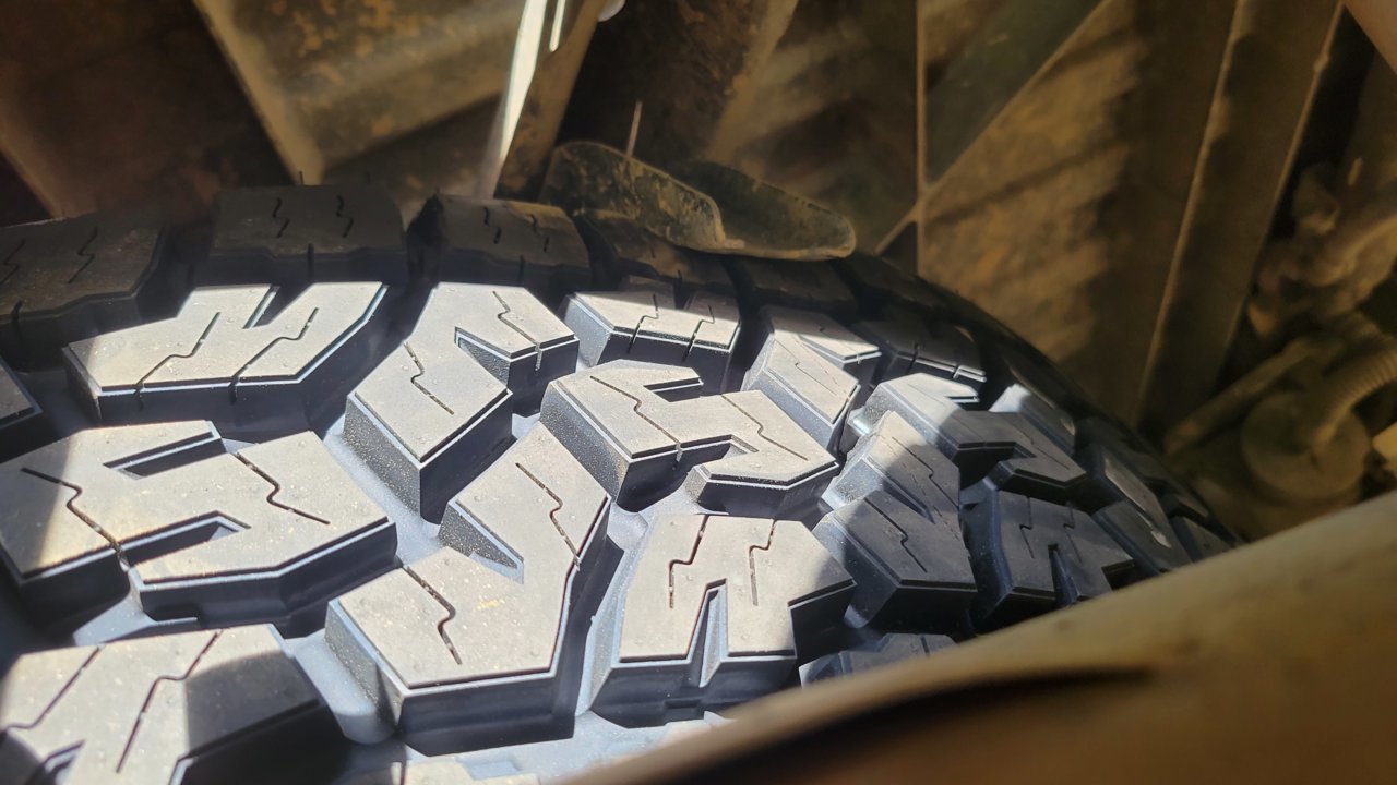

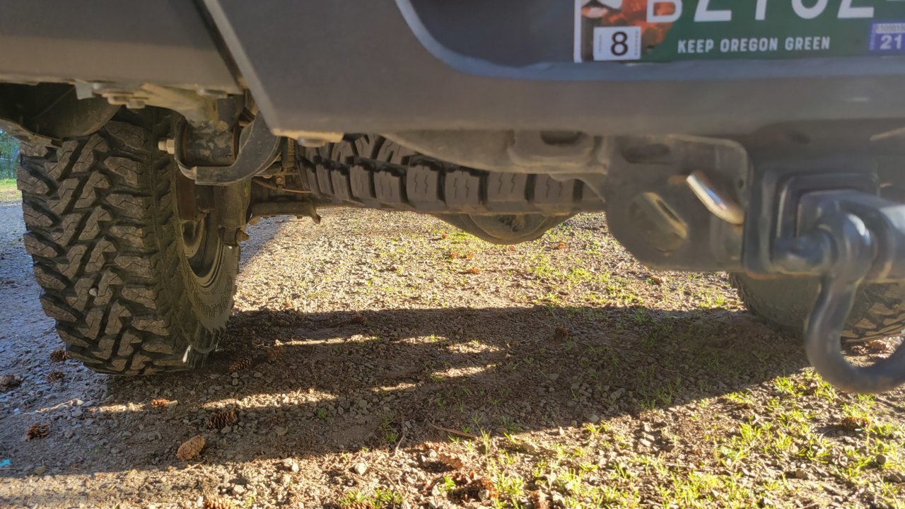

    Just had 255/85/16 BFG KM3s mounted up. Also got the shop to hang the spare. As others have experienced, they thought I was nuts when I said they’d fit.
    Thanks to all who shared info on this.
