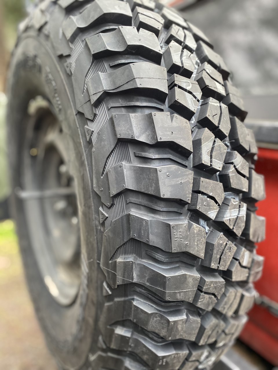

    255/85r16 BFG KM3's on a stock '18 TRD OR.

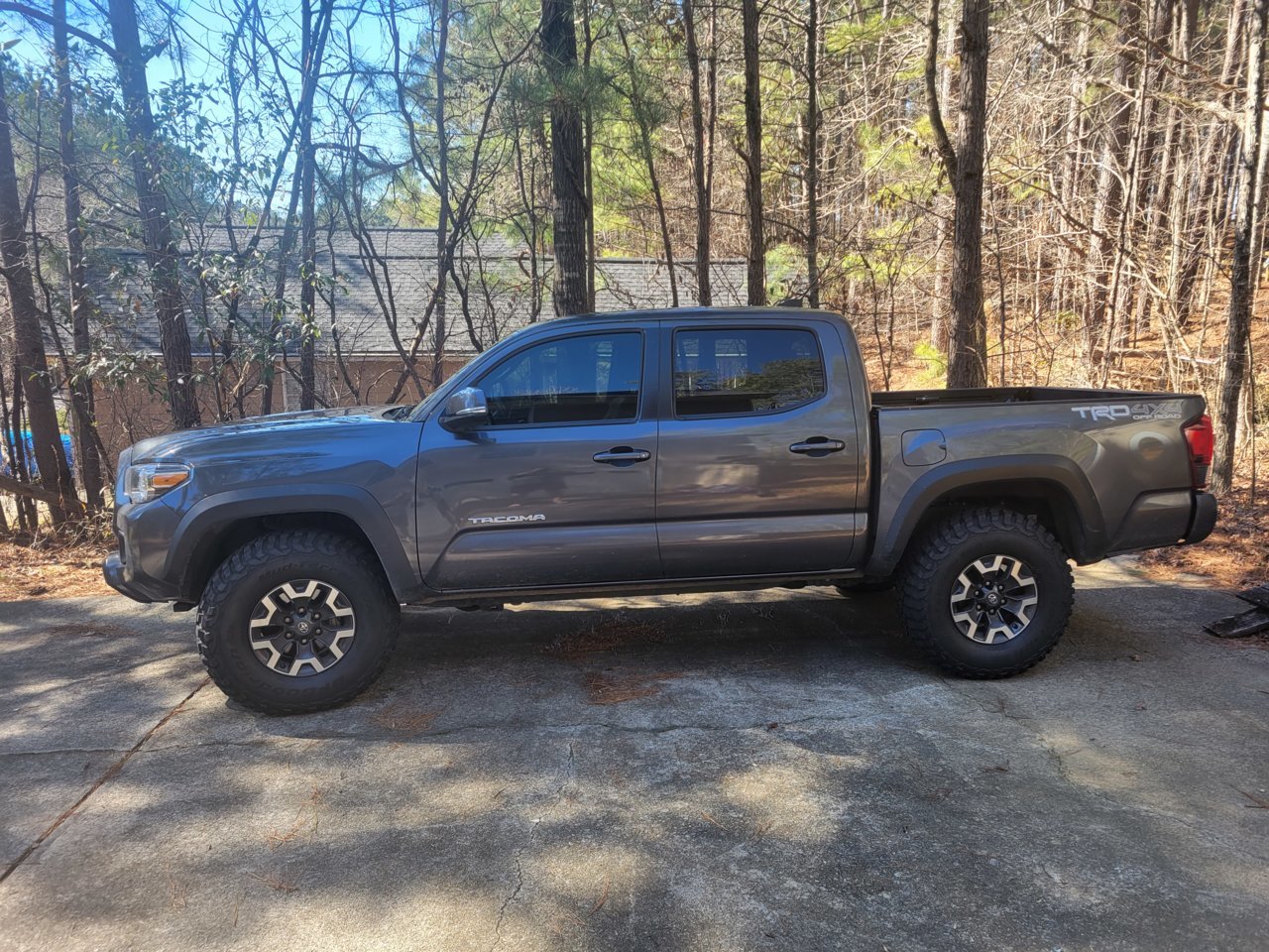

    38F2E687-7559-47EF-955A-D184B26DEA5E.jpg 24433B42-5B61-433A-8EB5-2178E2175371.jpg
    I got a set of BF Goodrich new KM3's and they ride way nicer than my 265 Ko2's. Also I was surprised, the KM3's are not much louder than the KO2.Very happy. Thanks for all the advice everyone.

    how are you liking the 255s on stock suspension? Any complaints? I am looking at getting a set to throw on mine.

    So far I love them. No rubbing and a little extra clearance. The KM3's have been great in the GA mud and are surprisingly quiet for MTs on roads. Really the only downside is I lost about 2mpg on average.

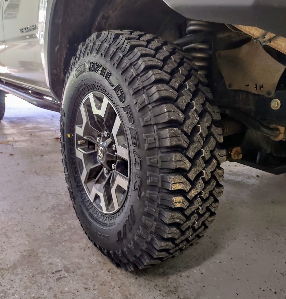

    AM-JKLWO3koUAiR2_GF0OQpiqXjcDPO2dEU2VnPC_d50ed6ac1dfaf33e1dfbbd47e92c3f115b541986.jpg
    AM-JKLUSY8o3tYxi5gYS0tvkXTpRXEZbqu0eU6sh_daa7f7164553fcf5c4fe76230ce4ed15aed7e5c3.jpg
    I've been on them since last September so far so good, I wanted the Toyo MT's for my next set but these were what were available and I had a trip coming up. My previous tires on this truck were ST Maxx that died an early death from sidewall damage, these aren't any louder on the road and are awesome off pavement.
    I've been a true believer in this size for a while now and have run (on a couple of trucks) the Dick Cepek Extreme Country, Mastercraft CXT, ST Maxx, and these Wildpeak MT's. So far TBH I liked the CXT's he best out of the bunch all around, but I would by these Falkins again. Can't say that about the Coopers.
