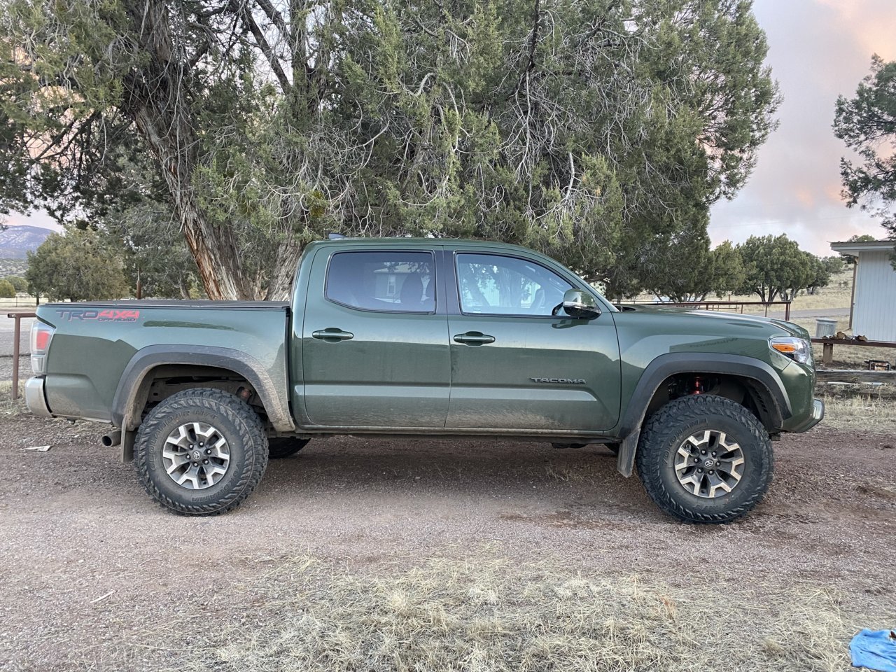

    Ended up changing my mind and going with the geolanders instead. On drive back from the shop I noticed a few things, mostly expected. You can definitely feel the knobs but I’m already used to it. Same with road noise as well. lost roughly 2mpg but I haven’t done the conversion to see exactly what it dropped. Can’t really use cruise control anymore for doing steep climbs above 55mph because bounces around gears too much. When you get into small grooves in the road while going 65+ it likes to pull you in more than the 266/75/16 I’m coming from. Overall I like them so far. 1E84CFAC-75FF-4CB9-81DB-E19710F40421.jpg2B597B37-B4AD-43E8-9128-16A368FA12A6.jpg861659F5-A19B-43BE-87C6-5B381B9FBA8B.jpg

    Looks awesome! Do you have the new TRD UCA’s on your truck? I only have about 2k miles on my geo’s but very quiet for an MT. You don’t get that “wahhhhhhhhhh” driving down the road like a lot of others.

    Stock ucas for the 2022 Offroad is what I’m still running. They could get the faster all the way to where they wanted it but it was close enough I was happy. I’ve also got the Toytech lift on it as well. It’s my first Mt so that’s all I have to go off of. I wouldn’t call it loud, there’s just a hum once you get going.
