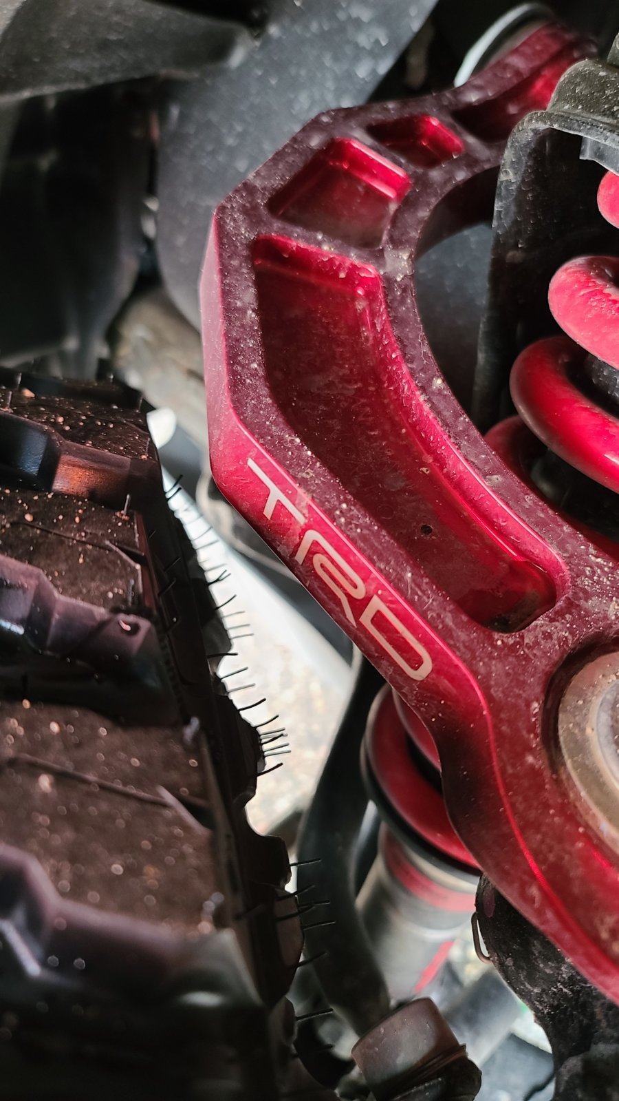

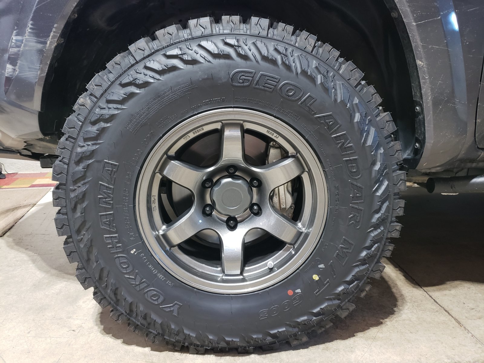

    2022 TRD Sport double cab, manual.
    I can confirm 255/85R16 does NOT clear without rubbing fender liner trim and cab mount with my specific set-up.
    -255/85R16 Geolander MT
    -Countersteer Offroad 16x8 +0, 4.5 backspacing
    -Stock suspension
    -Roughly 300lbs of added statistic weight (bumber/winch, skids x4, bed drawers and fiberglass canopy).
    The fender liner was an easy fix with heat. The cab mount rubbing might resolve upon the "2 inch" suspension lift I'm planning as this will move the alignment of the peak radious of the wheel lower vs the cab mount unless I'm not understanding my geometry correctly.
    I'll report back once installed. Should be with no more that an additional 300 miles on the tires so tread ware can be ruled out as the resolution (i hope it resolves it!).
    I'll add some more photos of the rub spots.

    A lift won’t help you to clear the cab mount. Unless you plan on driving in straight line and to never cycle your suspension.

    When you lift Toyota IFS, you just change static ride height, your wheel still travels through exact range of motion as stock.
    For example: Stock, you’ve got about 4” up and 4” down travel. With a 2” lift, you get 2” down travel and 6” up travel. Your wheel ends up at the same place when fully stuffed.
    If we are talking about solid axles then yes, a lift helps clear larger tires.

    Sorry my bad, I meant to quote @Tazswing
    Carry on!
