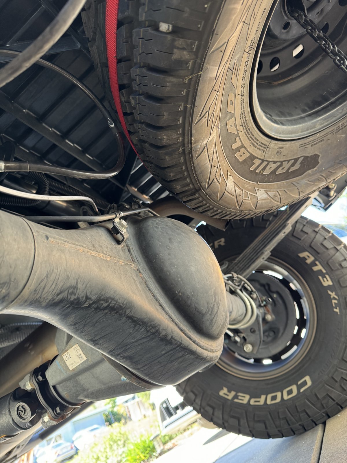

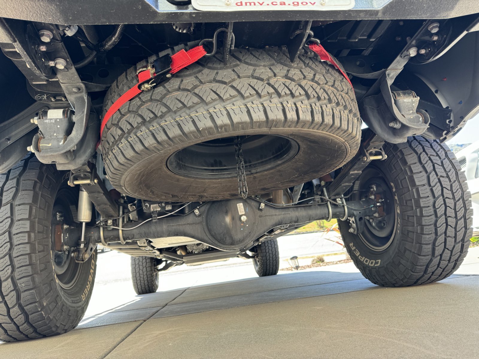

    How long of a strap was it? Looks like nothing to spare, which is good.

    Yes it’s staying there to keep pressure on it against the rear bumper. Spare is deflated as well to maximize clearance and clamping force
    It’s a standard 15ft. ratchet strap. Once secured I cut the excess off
