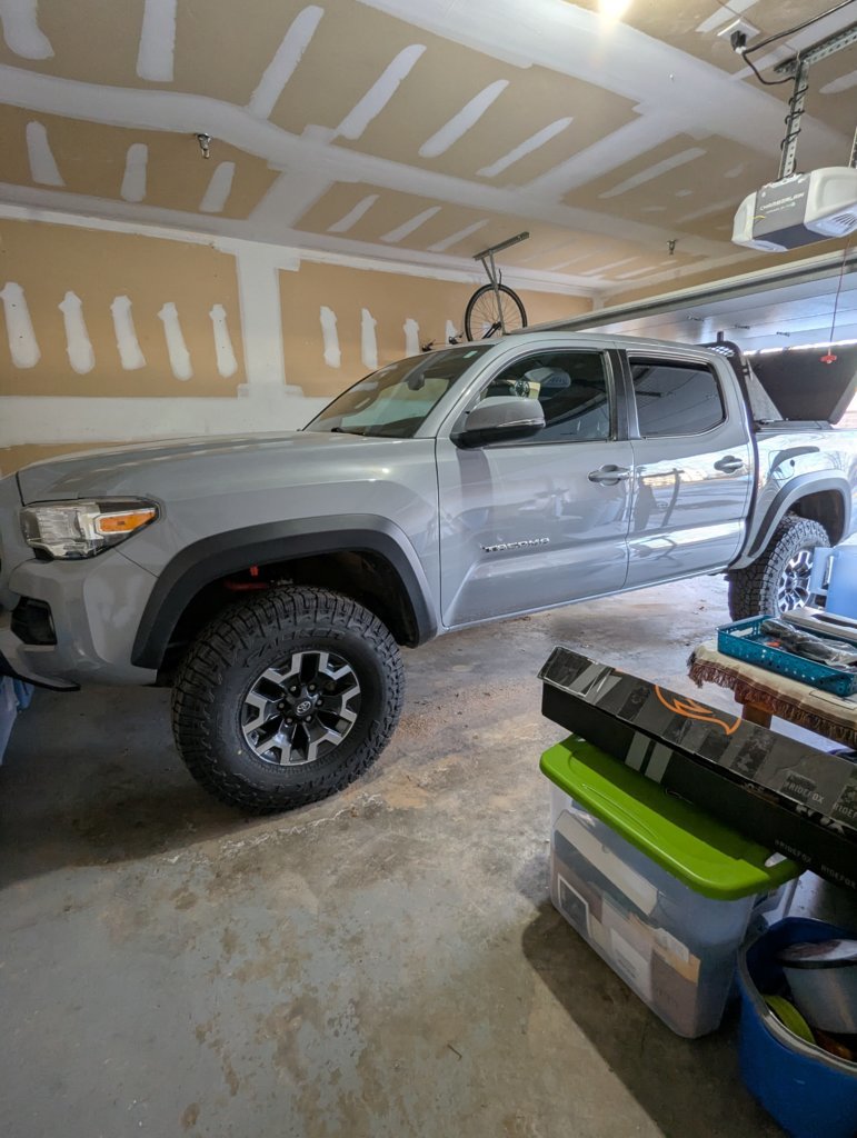

  2. Jan 11, 2025 at 7:49 AM
    #3462
    SoCalTRDOF
    SoCalTRDOF Member
    Jan 12, 2024
    #441507
    16
    2021 Tacoma TRD Off Road
    Working on it!
    Thanks! Yes, that's a hood scoop.
    I'm also considering getting an alignment and pushing the caster to 3.5 to get the wheels a little more forward. The rub happens when I'm turning full and compress the shocks.
    BamaBillENC[QUOTED] likes this.
  3. Jan 16, 2025 at 8:06 AM
    #3463
    SoCalTRDOF
    SoCalTRDOF Member
    Jan 12, 2024
    #441507
    16
    Working on it!
    Just got the alignment. The shop was able to get a 3.2 degree caster (factory was 2.2). I can feel the difference in that there is a little more resistance in turning, but that is to be expected. The driveway scrape isn't happening now, so that is a positive. We will see this weekend when I go to Superstition Mountain by the Salton Sea in Southern California and do some trailing.

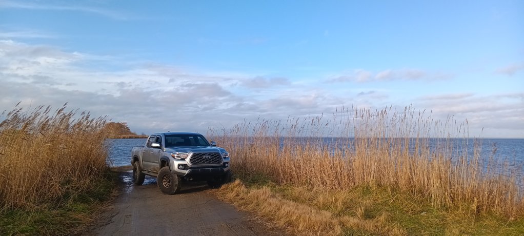

  4. Jan 19, 2025 at 5:04 PM
    #3464
    BamaBillENC
    BamaBillENC "It is what it is"
    Jun 14, 2024
    #451497
    89
    Billy
    Eastern NC
    2022 Celestial Silver DCSB TRD OR 4x4 OTT
    beatadrum and Taco dv like this.

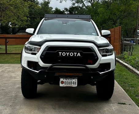

  16. Feb 20, 2025 at 7:02 PM
    #3476
    dleriche
    dleriche Wanee Warrior
    Feb 29, 2020
    #320735
    3,395
    D.J.
    Leander, TX
    2019 White ORD DCSB AT
    This is with an 8" wheel

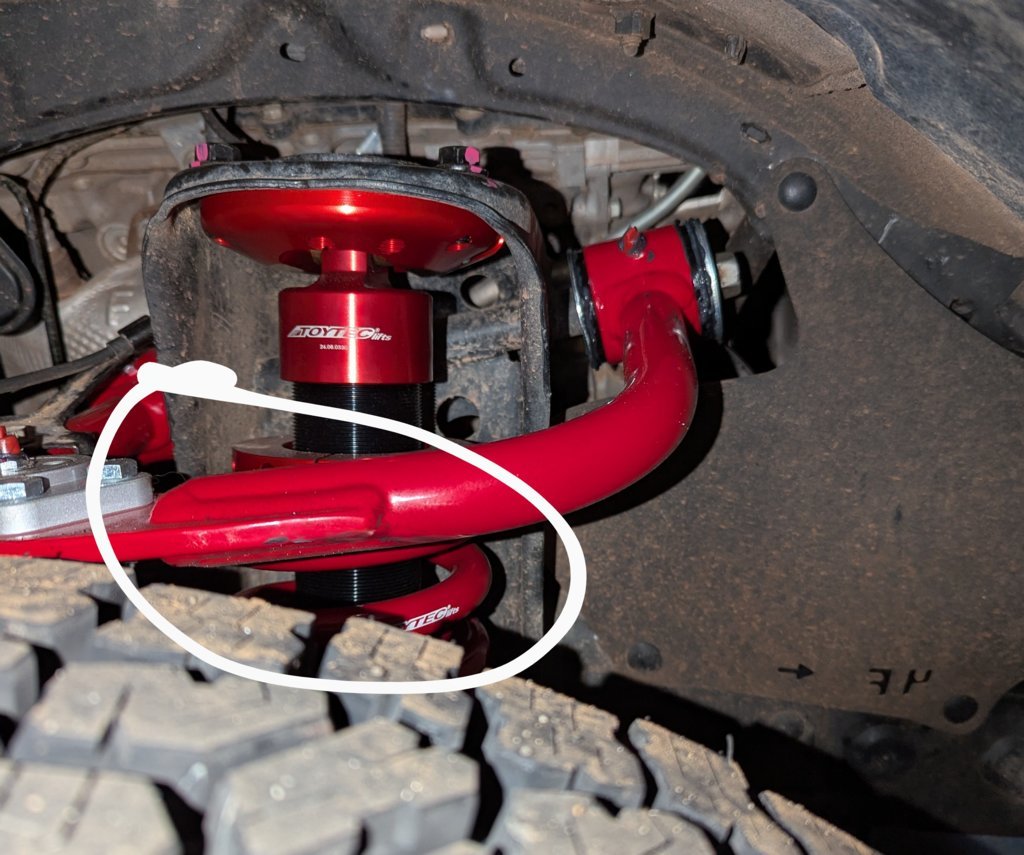

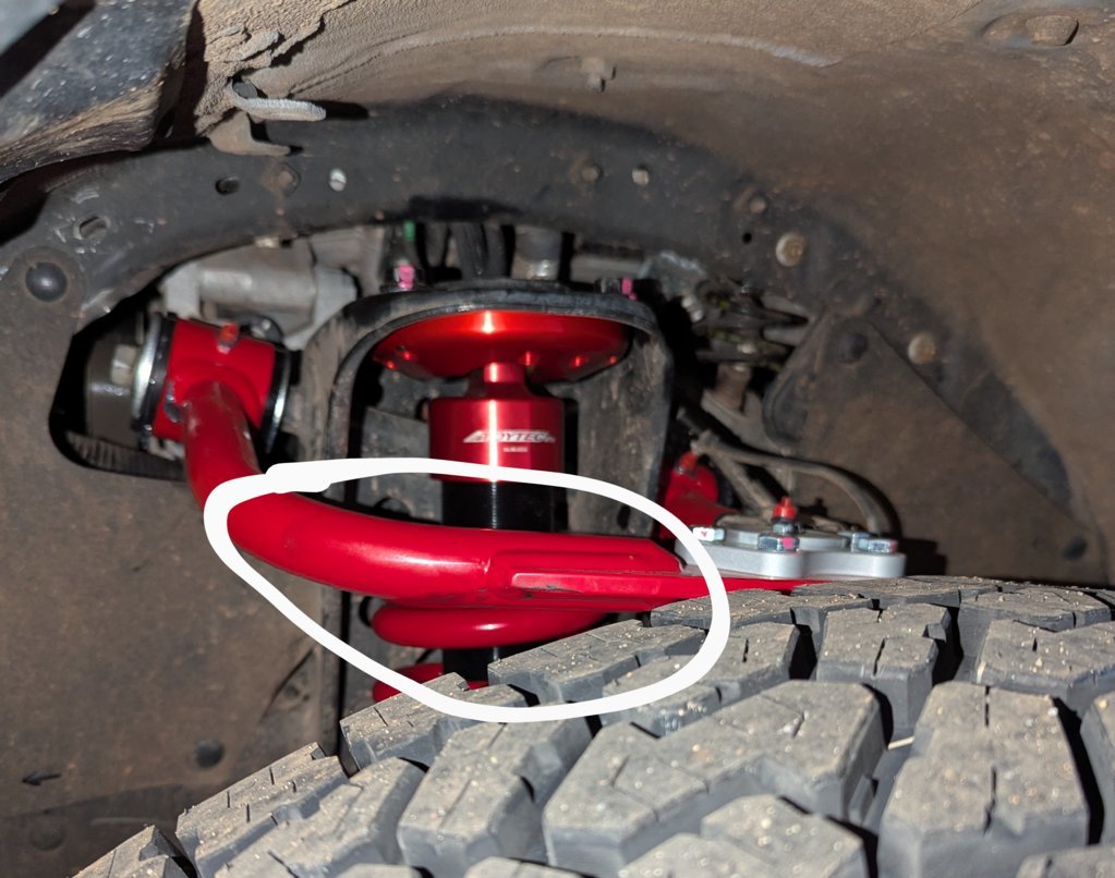

  18. Feb 28, 2025 at 3:19 PM
    #3478
    Doober
    Doober Member
    Feb 20, 2021
    #356784
    5
    Just lifted my '21 TRD Off-road. Super happy with how she looks, but I am getting some rubbing that needs to be addressed. It sounds like @SoCalTRDOF had similar rub before lifting... Maybe others here could help. I was following this thread and it was my main reference for deciding to go with skinnies.
    right now my truck is running:
    Toytec Aluma Series BOSS, set to 3" of lift + single add-a-leaf in the rear
    JBA UCAs (Recommended as a good alternative by the shop, I ended up going with them but kind of regret not just paying the extra for Toytec's UCAs now)
    Falken WildPeak AT4W's - 255/85/R16
    OEM TRD Off-road 16" wheels
    In the attached photos, I am getting rub on both UCAs... Without knowing all of the measurements, I am somewhat surprised I'm getting rub with so much lift. Maybe I need a caster adjustment with the alignment? given that many have had success putting 33" tires on their trucks without a suspension lift, I didn't anticipate issues when installing JBA + Toytec components. But maybe I'm missing something here... Pretty new to this world... Any opinions would be greatly appreciated.
    BamaBillENC likes this.
  19. Feb 28, 2025 at 3:27 PM
    #3479
    Taco dv
    Taco dv Well-Known Member
    May 16, 2024
    #449862
    115
    2020 Tacoma TRD off-road
    Those UCA might be larger than stock. I believe Accutune UCA are less bulky and give more clearance over stock. The amount of lift does not matter. You may be ok with running a 3/4” or 1” Bora wheel spacer. Looks nice though. Would like to see more pics.
  20. Feb 28, 2025 at 3:35 PM
    #3480
    Doober
    Doober Member
    Feb 20, 2021
    #356784
    5
    That's what I'm thinking as well. I'm going to compare them to the stock ones... might be too bulky. Which would suck. But you live and you learn.
    Edit: Maybe I'm thinking of the geometries wrong, but thinking about it again... These tires are skinnier than what I was running before, and I know I've seen others running JBA UCAs with OEM wheels/OEM offset... So I'm not sure that totally makes sense.
