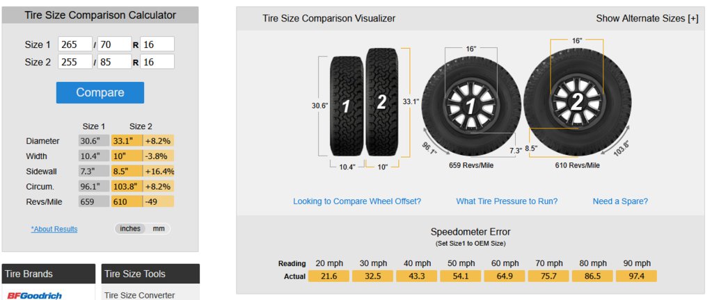

    They maybe skinner, but probably much taller.

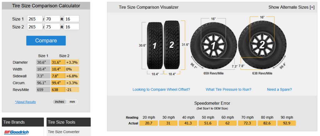

    Kai from Tinker’s Adventure recently made a video that made me curious how tall of a tire you could go with for a 3rd gen using the principles and tips he recommenced
    -skinnier taller tires with higher aspect ratio
    -using wheels with positive offset rather than 0 or negative
    -alignment

    Apparently 255/85 R16 is only available in the KM3 Mud Terrain Tires right now according to the BFG Web Site.
    265/75 R16 is as close as I can find in KO2 KO3 tires.

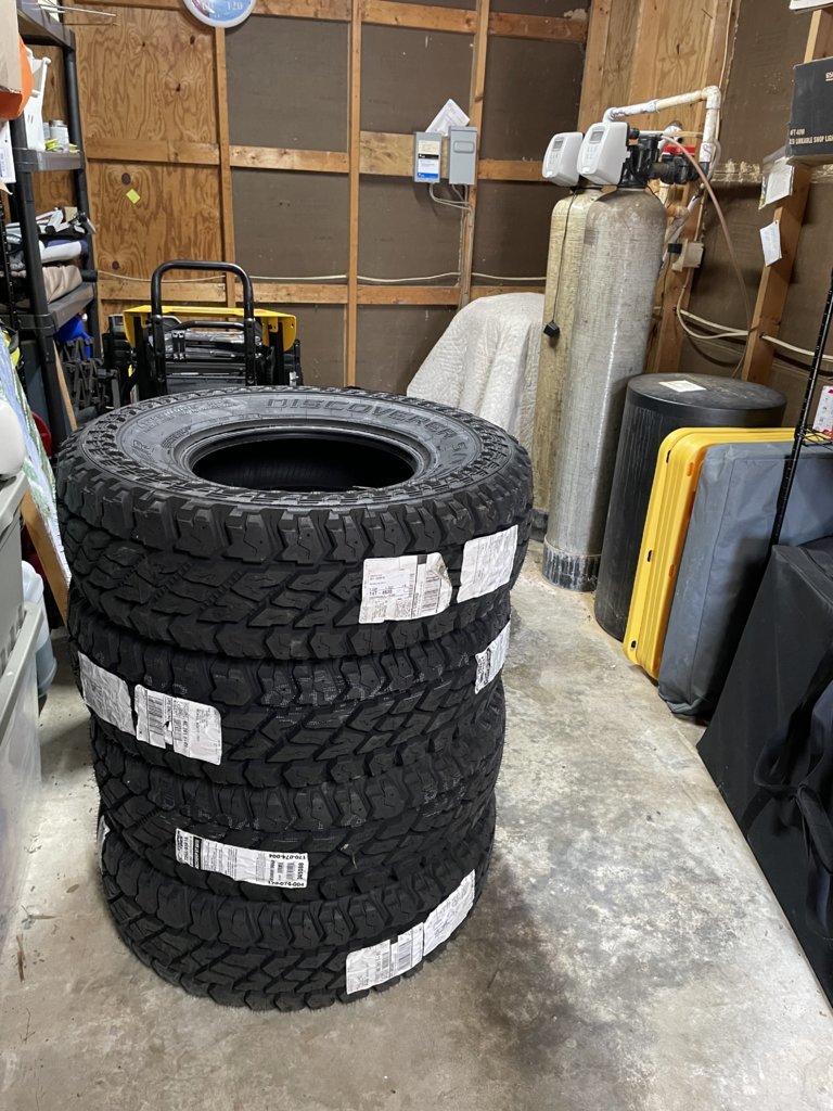

    Morning folks,
    My Cooper S/T MAXX LT255/85R16’s came in yesterday. Getting them put on next week. Thanks for the great ideas!

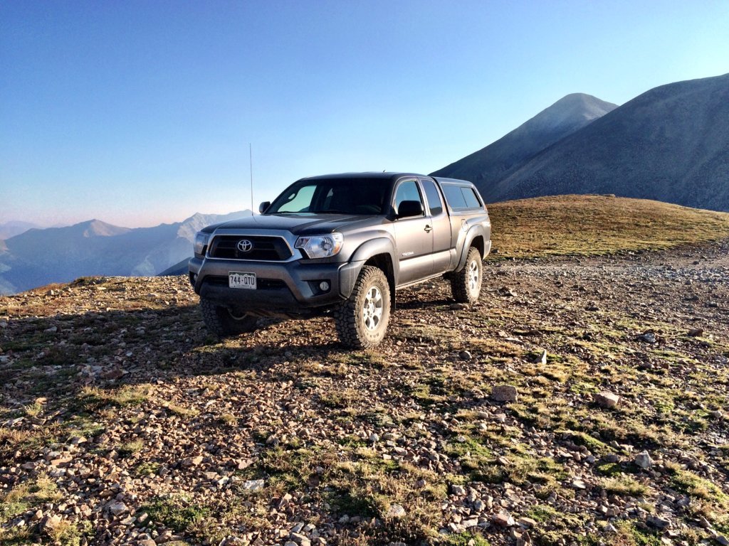

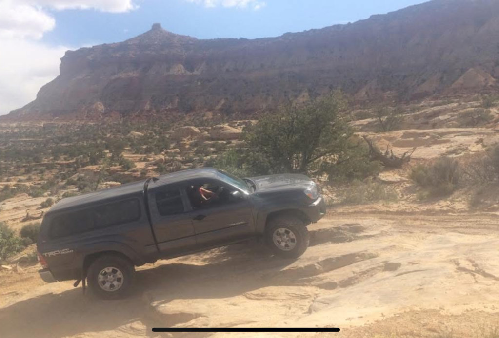

    As soon as I bought (and installed) my 255/80/17 Faulken Wildpeaks and 17" rims, Faulken turns around and sells 255/85/16 tires... :eek:
    I would have kept my oem 16' Rims, but love the looks of my 17" TRD knockoffs, regardless.
    Gobs or clearance as seen in pic#1.
    In pic #2, you can see the height difference with the pizza cutters and 2" lift vs a stock Sport.

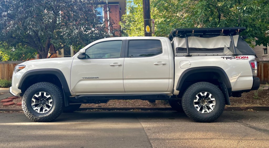

    Rejoined the 255/85r16 club with the AT4W! Been running 255/80r17 for a while and looking forward to a more comfortable ride with the C rated tire. Haven’t had a C rated 255/85 since the Maxxis Bighorn tires on my 2nd gen.

    That top pic is enough to sway me away from BFG ATKO's almost. Would love to stay with them but getting an 80 in C that fits would be the ticket.
