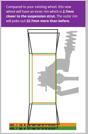

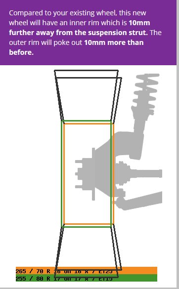

    Alright so here's how I picture it. Yes, the additional rim width will cause your RIM to stick out 1.09" further, but the does not impact the tread position within the wheel well. Thoughts? Picture above on the left shows OP's exact tire situation, and picture on the right shows what it would look like if he were putting his 255s on 17x7s. Tire tread still sits in the same place, regardless of width.

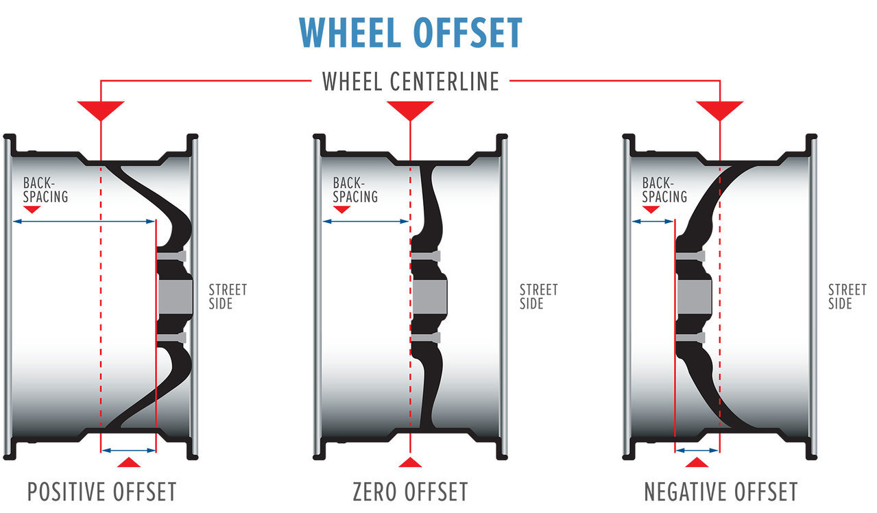

    Again, that's dependent of the width of the wheel. All offset is is how far the mounting holes are from the center line of the wheel. The more negative offset, the more it'll stick out.

    Backspacing and offset are not two mutually exclusive things, and are entirely dependent on one another. I think you're confused, and it wouldn't hurt to do some reading to see if you understand it or not.
    This article and video may help
    http://www.tsw.com/explore/what-is-wheel-offset.php

    Alright before I clog up this thread any further, one last comment for clarity. Using your caculation (and customwheeloffset.com) I see the new value of ~1.09" more "poke out" for the outer most position. Doing some math:
    Your new wheel is 1" wider, or 0.5" wider on each side of the centerline. RIght out the gate, your rim will stick out 0.5" further than before, assuming offset doesn't change.
    Your new offset change pushes the wheel out an additional 15mm, or about 0.6 inches.
    0.5"+0.6" = 1.1" or ~1.09"
    So while your rim might be sticking out 1.09" futher than your previous rim, your tire should only stick out 15mm further than your old tire at the tread. (265 vs 255 width aside)
