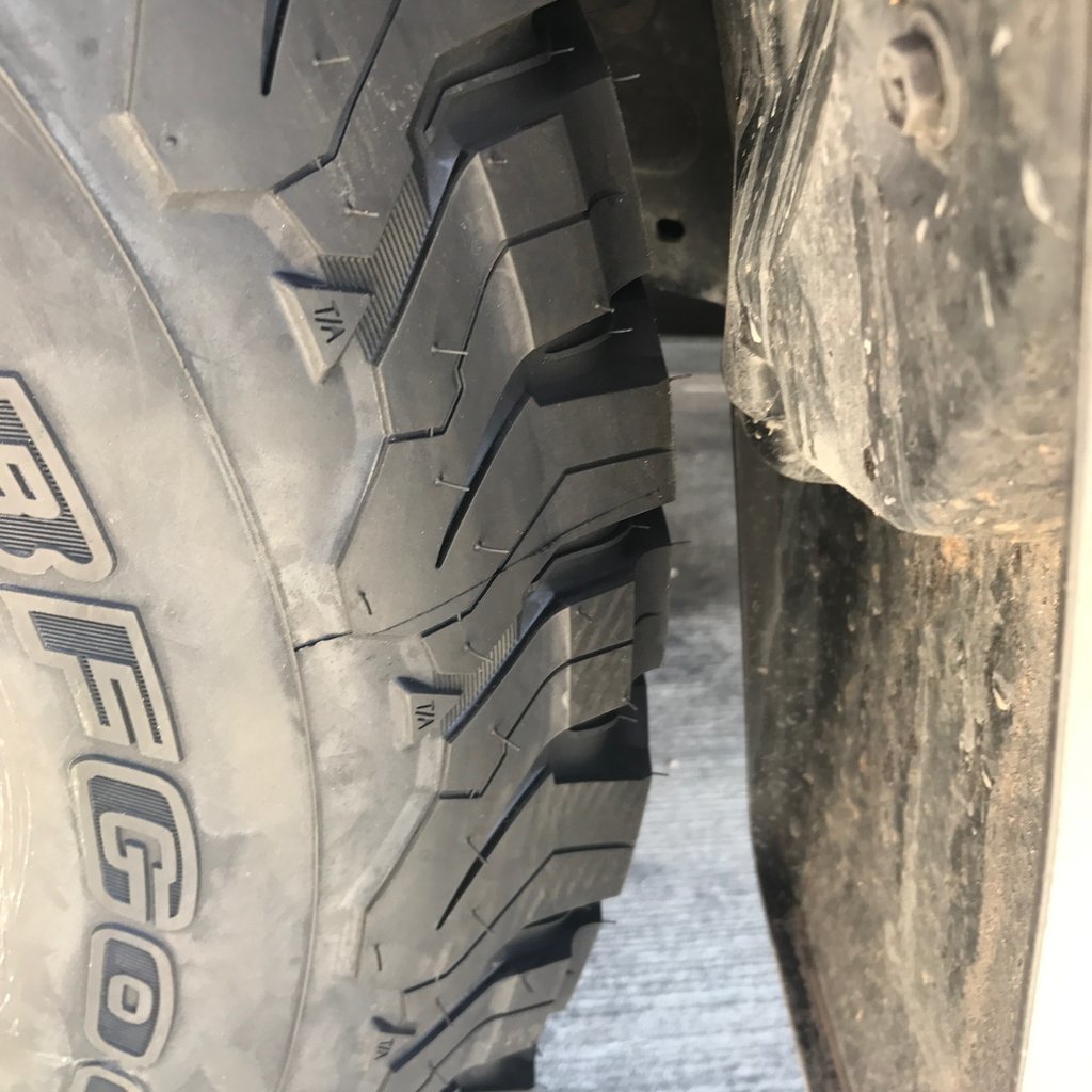

    I put 255/85R16 KO2s on my OR on my OR wheels and they rubbed! Had to go with 265/75R16. The first rub location is at the rear of the front tires at half turn (not full turn). Here's a photo of that location showing a 0.4" gap with 31.5 265/75R16 tires:
    Can anyone else show us photos showing the gap at the rear of the front wheels at half turn on your 33" tires?

    There's a bunch of pictures of that gap in the first post of the thread. JK I'm stupid those pictures are not at half turn.
    I'm more curious about where on earth you managed to find KO2's that are 255s...(those dont even exist on the BFG website) Also, are those mudflaps? @Sandytaco14 mentioned in one of the posts having to remove his flaps because the tires rubbed on those.
    I also just noticed that per your 'mod list' you have skids. That extra weight on the stock suspension may be causing issues as well, especially since the front bears most of that load.

    I rubbed extremely rarely on the flaps prior to adding weight. After adding skids on stock suspension, I rubbed on the time on the flaps. I didn't rub after I removed the flaps completely.

    I studied those but didn't think any of them were photos of this gap *at half wheel turn*.
    Yes, they are, and maybe that's the problem. I thought they were only adding 1/8" but maybe there's more there than I realize. I'll look into it - thanks bud!

    I certainly would. That's exactly what mine were rubbing on. I still have the rear flaps on, but fronts are gone.

    Defineitly think it's the mudflaps, I had the.exact same thing happen to me.

    Um the OP in this thread is of a set of 255/85/16 KM2s. The Discount Tire I went to said they had KO2s in 255/85/16, 265/75/16 and 265/70/16. Apparently they don't make a 255/80/16 which I might have gone for. They test fitted a 255/85/16 for me but it rubbed on my mudflaps (I didn't bother getting a photo) so we went with the 265/75/16's. Now, is it possible that I asked for KO2s but they substituted KM2s and I didn't notice for the 30 seconds it was in front of me? Yes, that's possible. Goto Discount Tire [https://www.discounttire.com/store/tx/san-antonio/s/1682] and ask for a KO2s in 255/85/16 and see if they tell you "yes, we have them in stock".
