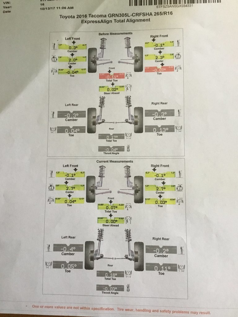

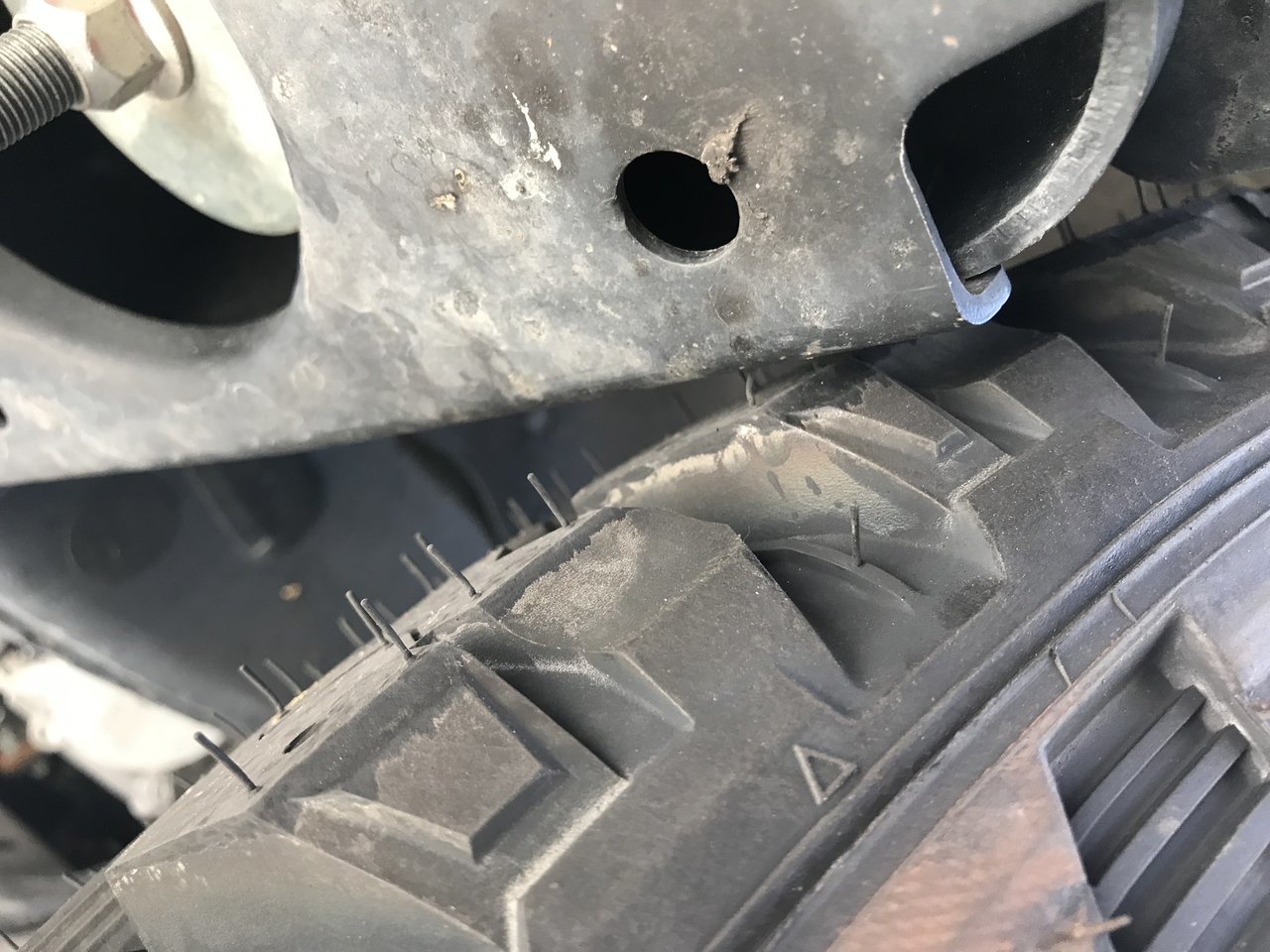

    Mine rub the cab mount with 3 inch lift with uper control arms, with and without 1.25” spacers
    Probably do my cab mount chop tomorrow or friday.

    What's your alignment look like? You could get a lot more caster and push it forward without having to chop anything.

    That's why I was curious to see what his alignment numbers are. He should be able to get a lot of caster, pushing the wheel forward away from the cab mount. Doesn't make sense otherwise.

    I had it aligned the other way with the lower arms adjusted forward but it wandered all over on the freeway. I have the SBC adjustable upper arms.

    Huh, weird. I only have 1.56° of caster and I clear the cab mount with ease. I remember reading somewhere that there's a way to gain caster, but your wheel is moved backwards, which didn't make sense to me. Maybe that's what's going on. Either way, if you're cool with a CMC then it doesn't really matter.

    I have the BAMF chop plates and a nice mig. Not too worried about it. Its lame that Toyota doesn’t just put the cab mount back farther or change the design a tiny bit.
