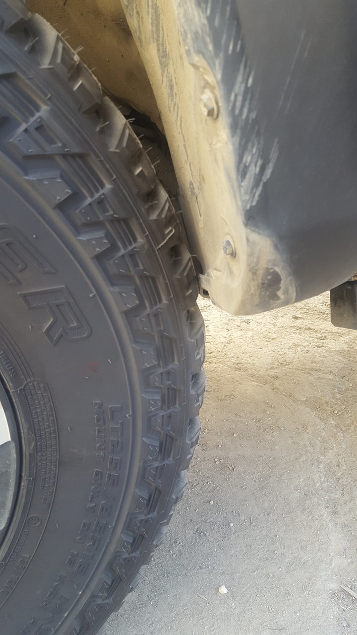

    How in the hell are you guys not rubbing without cutting? I've got an aftermarket suspension, skids and just bought a set of 255/85R16 and I rub in the same spot that Jedi5150 was. Trimming my stuff tonight. Maybe I need to think about getting 700# coilovers? Supposed to hit the desert next weekend and I'd like to have my shit kinda together...20171030_093506.jpg

    What wheels? Any spacers? What's your alignment like?

    Maybe the weight from the skids is pulling you down?

    Stock wheels, no spacers. Alignment specs are as follows. I'm not an alignment guy, so I have only a rudimentary understanding of what these numbers mean. Thanks for the quick response!

    Alignment looks pretty good, likely just the added weight

    I'm really not sure then. Are you only rubbing the plastic? That's an easy fix with a fresh razor blade.
    As far as the skids pulling you down, that isn't an issue. When the wheel gets pushed upwards into the wheel well, extra weight and lift has nothing to do with whether you rub or not. If everyone is able to run these on stock suspension, and not rub while turning and hitting bumps, then you should be in the same boat regardless of extras.
    My guess is SOMETHING with your alignment is the culprit, but I'm not savvy enough to know.

    Ill let you guys know once I find out. For now I'm going to clip the plastic and see what happens...

    I figured it out! I'm an IDIOT! After looking closer, I noticed that i only had about 1.25" showing between the adjustment ring and top of my coil over. I jacked up the front of the truck, cranked on the ring till I had about 1.75" showing and ended up with another inch of lift. No clearance issues now and still have 3/8 of adjustment before I exceed the recommended preload!
    Note to self: Don't let the "Pros" do the same half assed job you could have done yourself!
