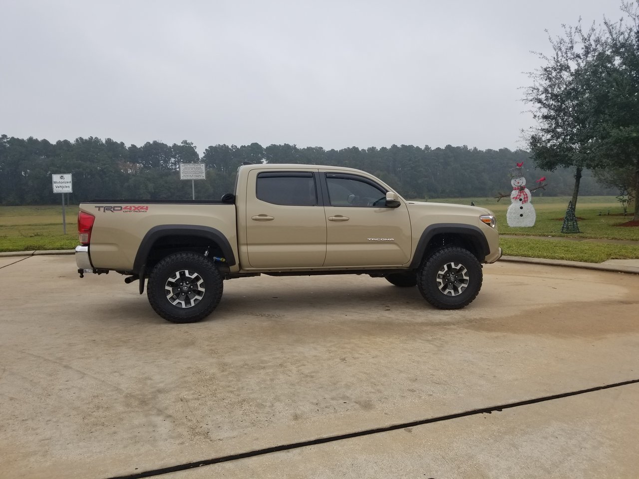

    Here is alignment and clearance photos.20171204_135003.jpg half turn closest it will be to cab mounts
    20171204_134952.jpg CV angle for anyone curious

    interesting, I gained about 1.5 inches on 4/5 settings. I am still on stock tires and stock UCA's

    I was shooting for 2"-2.5" I have read other getting more then the 2 blisten claims as well.
