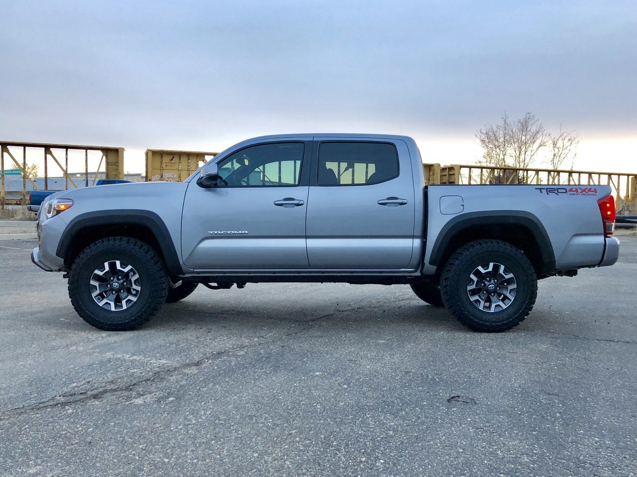

    Had the 255/85 16 ST Maxx mounted today. I was thinking of them as temporary until I could do a lift and some 285/75’s, but they actually look to be the perfect size to me. Definitely ride a bit more stiff than the stock tires. What pressure are you guys running with these? Tire shop set them all to 42 psi.

    That's probably the best number for MPGs, if you want it more comfortable try 28 psi. Your MPGs might take a small hit but for some the comfort is worth the expense! All up to what you wanna get out of it. Btw, with 255/85s on stock 7.5" rims you should be able to air DOWN without worrying about popping beads off. I've heard of people running below 10 while wheeling without popping beads

    MPG is running a distant third to looks cool and comfy. I’ll give 28 a try. Thanks for the info.

    If you run too low you can also fuck up your tires with uneven wear. Best bet is to get some chalk and do the chalk test to get the most life out of your tires.

    Thanks. Dropped to 36 today. Ride feels much improved. I’ll try the chalk test and see what it shows.

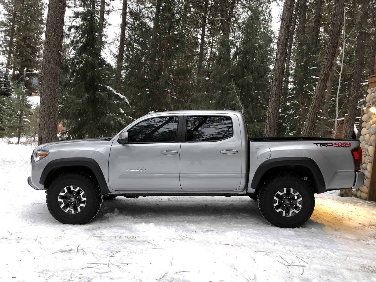

    Got them on some snow today. Icy / packed snow on the highway and packed plowed road to the cabin. ST Maxx are pretty sticky. Supposed to get 8” over the next couple of days. Can’t wait to see how they do.

    Those look great on your truck :thumbsup:
