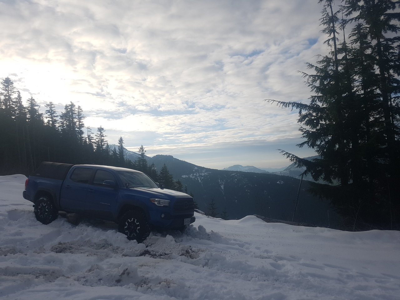

    None... :(
    Well at least you will be if this damn snow actually starts falling at a decent rate. It still feels like a really low snowpack on the west coast of Canada, but my hopes are still high!

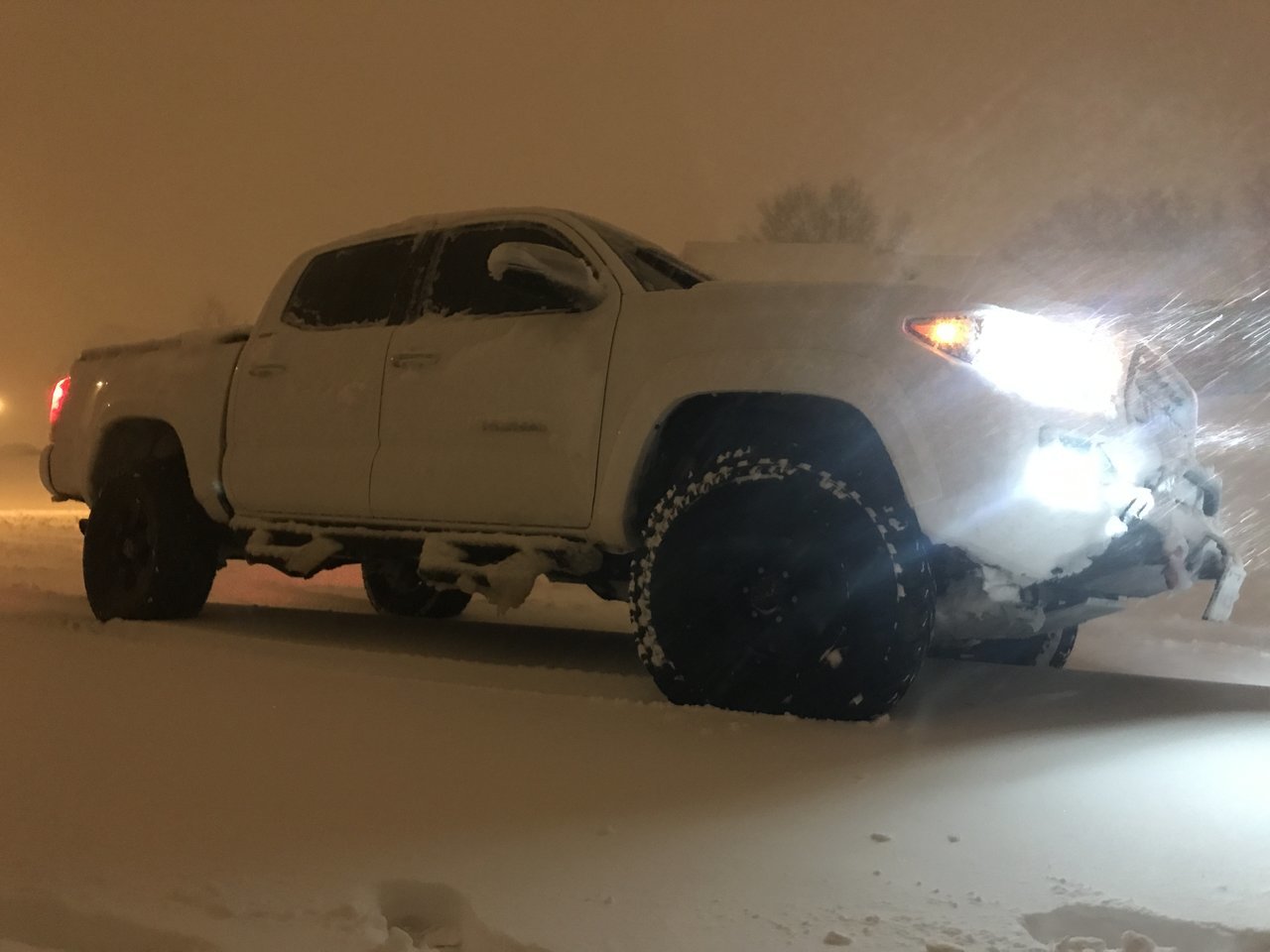

    Can't really complain on st maxx in the blizzard we had 14inch of snow and didn't get stuck and drive well on pavement.
