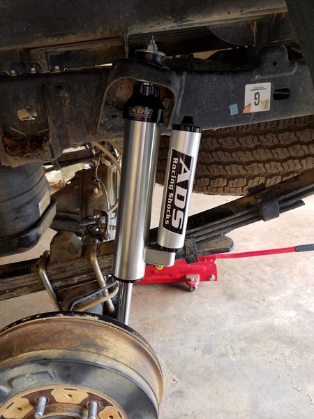

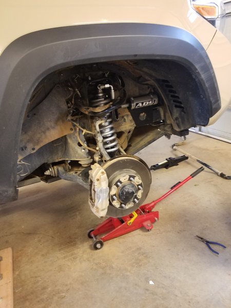

    I believe this kit is technically a 2g kit. I did gain nearly 3" in the front because of the sag. Regardless with a adjustable coilover you could set the preload to your liking and I wouldn't want more than 2.5" over stock. The reason I chose ads (other than the 18% Off group buy) is they actually focus on the on road ride quality too. Since this truck spends 99% of its life on road, and I wheel more than most. Also, they are a small company with an impressive amount of their work done in house. It says proudly made in the USA in about 13 different places on these shocks:D

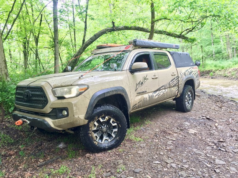

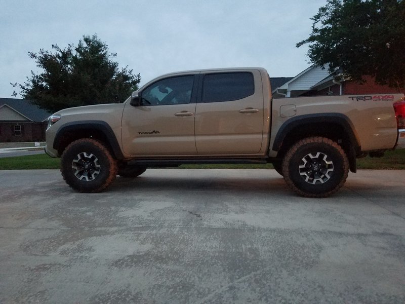

    1) 255/70/17 would almost certainly fit because thats smaller than the stock tires (per the TW tire size calculator). If you had an issue fitting those, it would be because of the wheels.
    2) If the lift got the wheel wells up high enough that the tires cleared the sides and didn't get pinched (I'm probably explaining this like an idiot- check out photos 3 and 4 in my original post, where the tires are pretty close to the plastic- thats what I'm talking about) then you should be ok. Depending on how the lift is set up, even the tiniest outward shift of the UCA might cause issues too. I'm fairly certain that as the truck sits I'm just barely clearing the UCA all the time.
