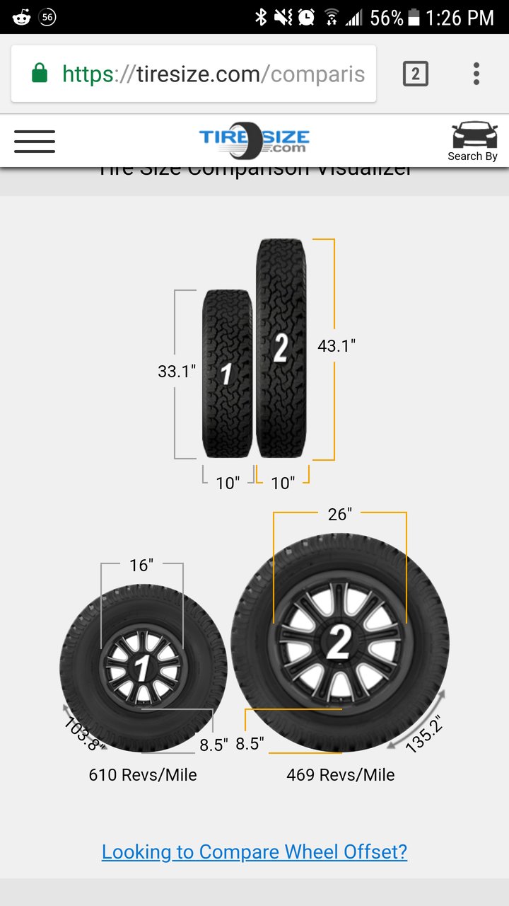

    Well a 26” wheel is probably your problem

    Our trucks use the abs system. Mpg and mph and miles are correct regardless of tire size.

    However a 43" tire would be fun!

    So would you say he’s getting even less mpg than the truck states? Or more? Lol
    Right, they’re obviously different. I just didn’t fully understand what those differences entail. Especially because they’re 12lbs heavier.

    He's getting more miles per tank than the odometer is reading, so higher mpg. Bigger tires have less revolutions per mile, than the smaller truck tires do.

    From a stock 30.6 to a 32.8 inch tire is aprox +7.25% which you should add to your per tank total miles and then divide by your total gallons. Computer mpg and vehicle speed is reading low due to the larger tire. Mine is off around 4 mph at 60 on computer is around 64 on GPS.
