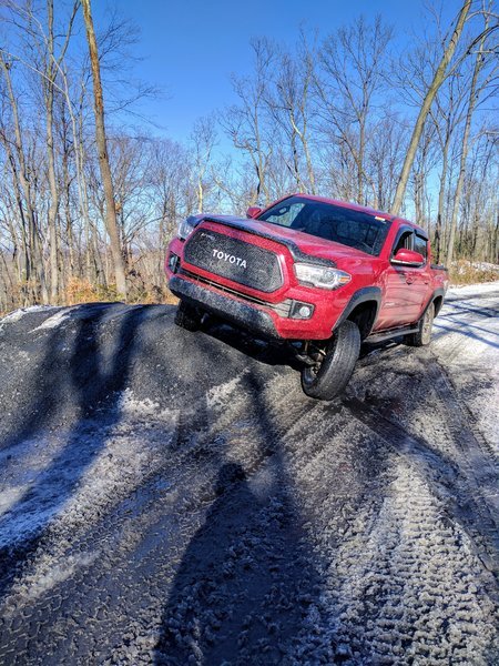

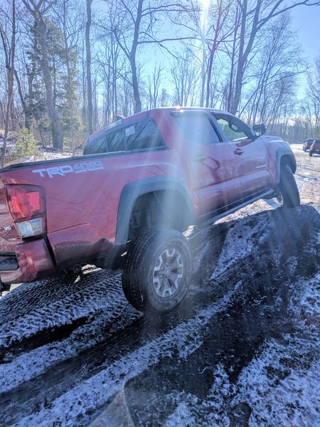

    Got any "non-action" shots?

    I'm installing 255/85/16 today. I'll post before after pictures.
