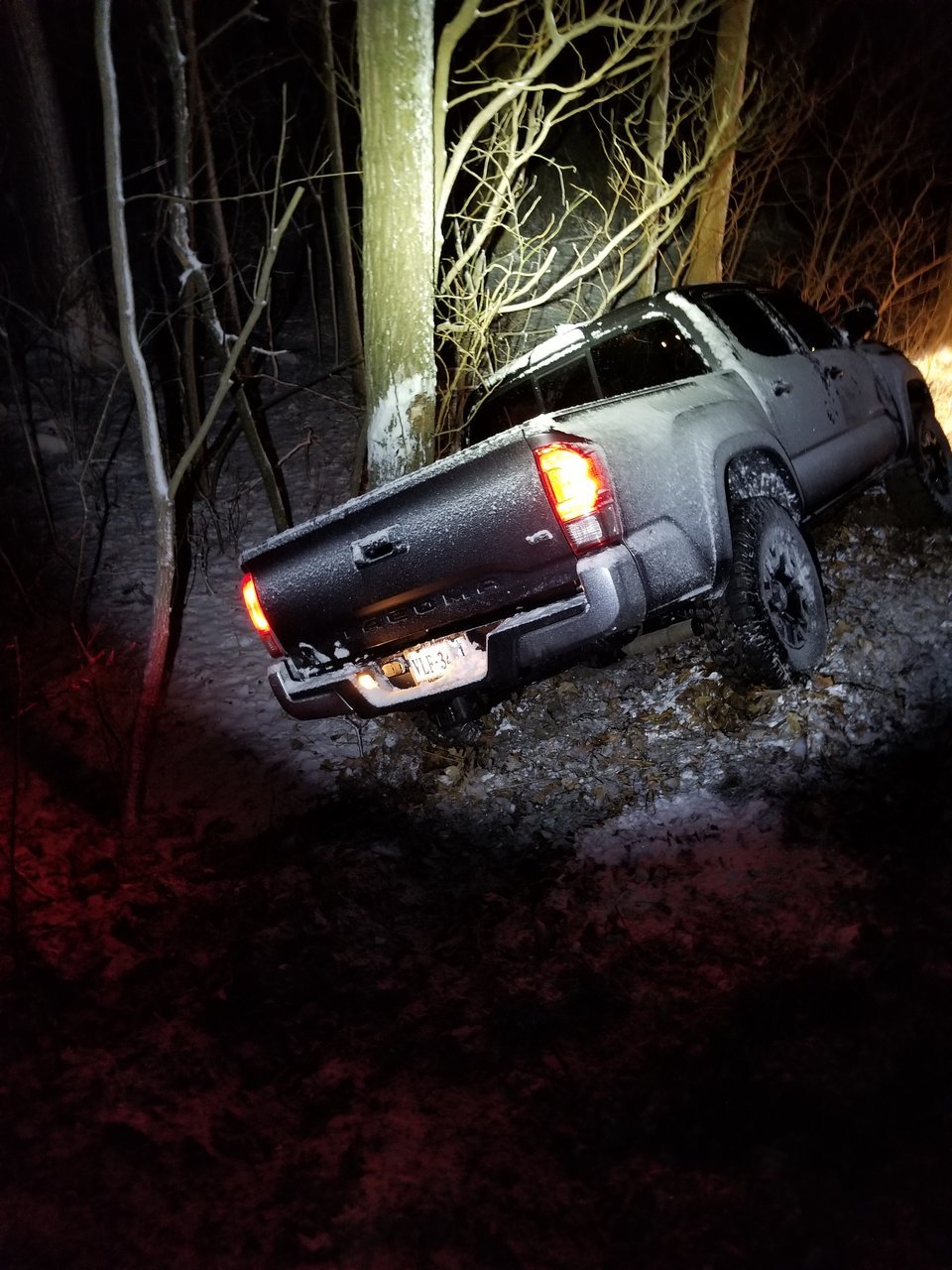

    this is my old truck with 255s and no lift. When I get the lift on the new truck, and the tires on, I will post a pic bro. But yeah, heres my old wrecked truck.

    minus your truck in a tree, its so pretty, psyched to go tall and skinny
