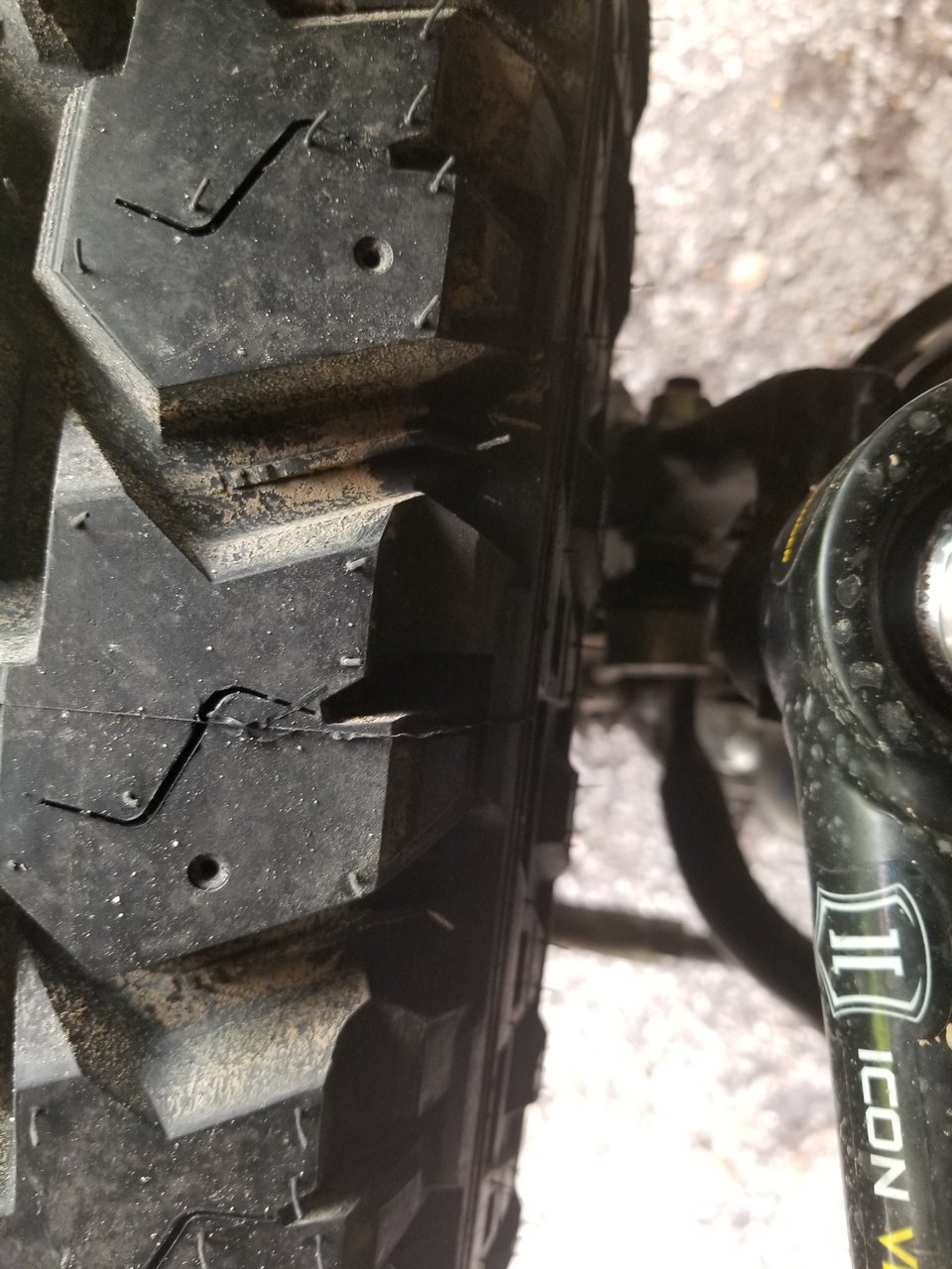

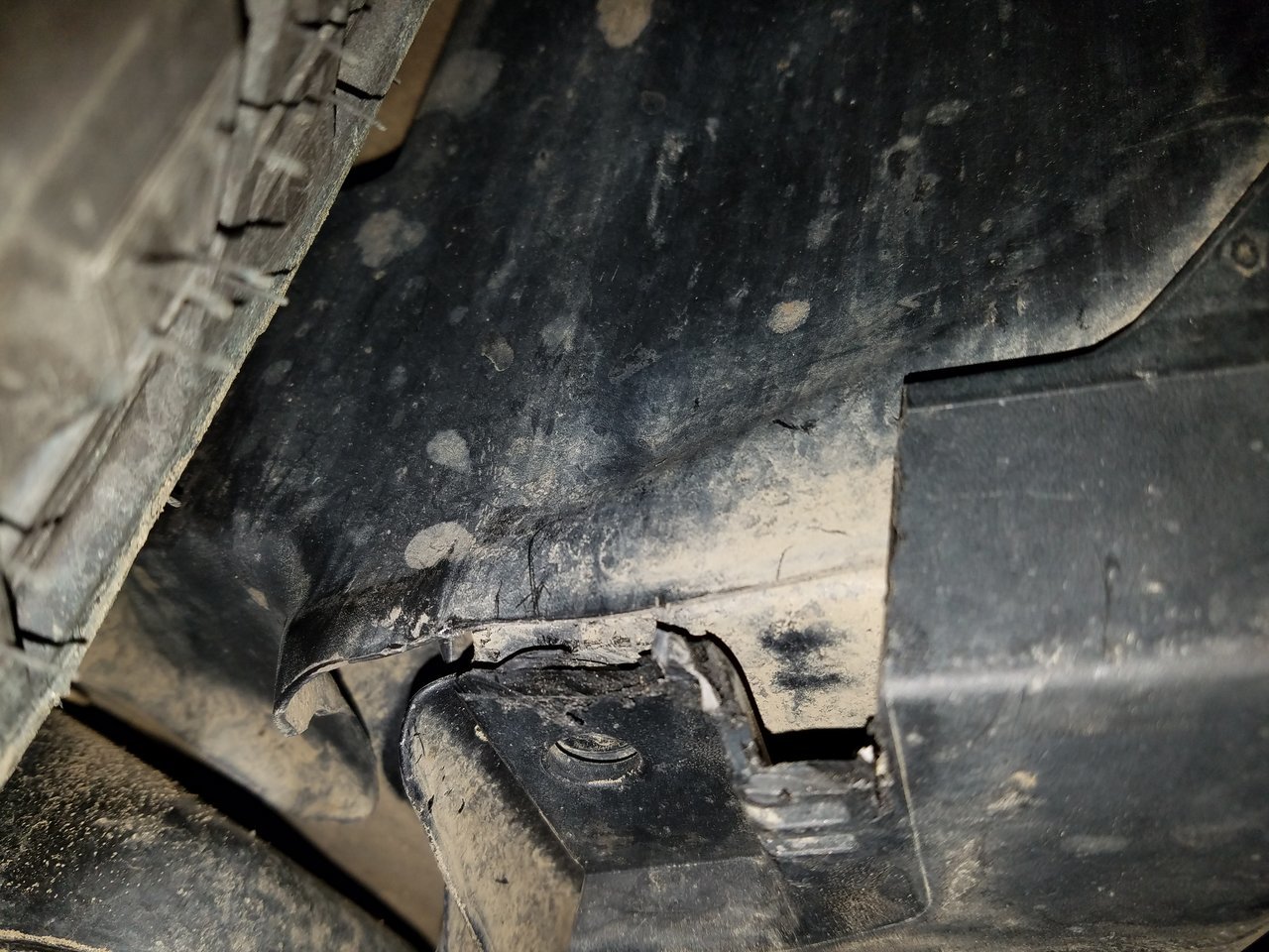

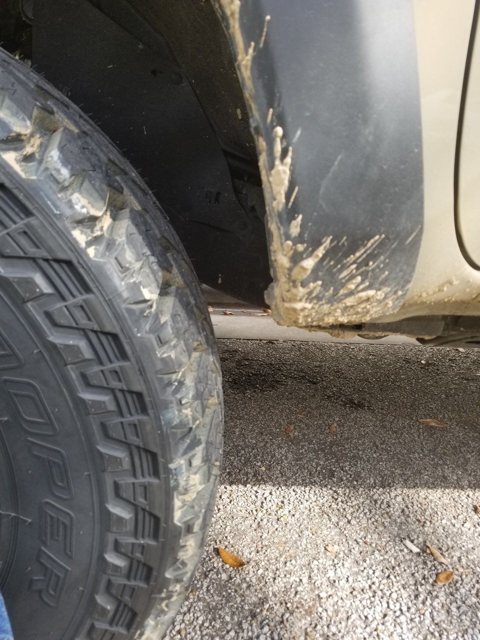

    Hey Guys, went romping around the neighborhood and let the tires mark where they are rubbing. Looks like its mostly the fender flare bottom piece but no the fender liner. Also, it looks like a half inch of the cab mount is getting rubbed.
    Correct, I posted the setup a few pages ago. I have Icon 2.5's up front with resi. JBA high Caster UCAs. with a net 2.1" lift. I have G2 1.25" spacers installed.
    New game plan, going to trim the plastic with a Dremel. As for the cab mount, If its really still rubs after I'll do a CMC. Just need to find a local place to do it that doesn't charge 400 (4wheel parts and Rebel Offroad). I'll let you guys know how it works out.

    This is the most I had to do. I still get rubbing on the cab mount driver side when I hit dips and turn at the same time. After trimming the plastic, I couldn't get the passenger side to rub doing all sorts of weird crap. good luck Ivanza!
    I think the major thing here is that I got the JBA UCA's which are different from stock and other companies. It sits different and on their website it says minimum 4.5 BS for any tire sizes larger than 32".
