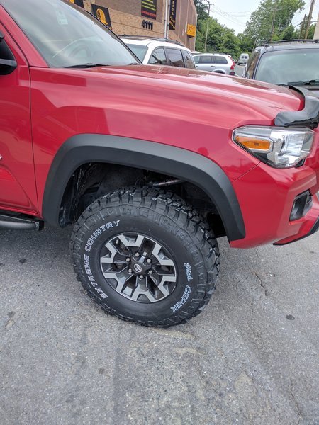

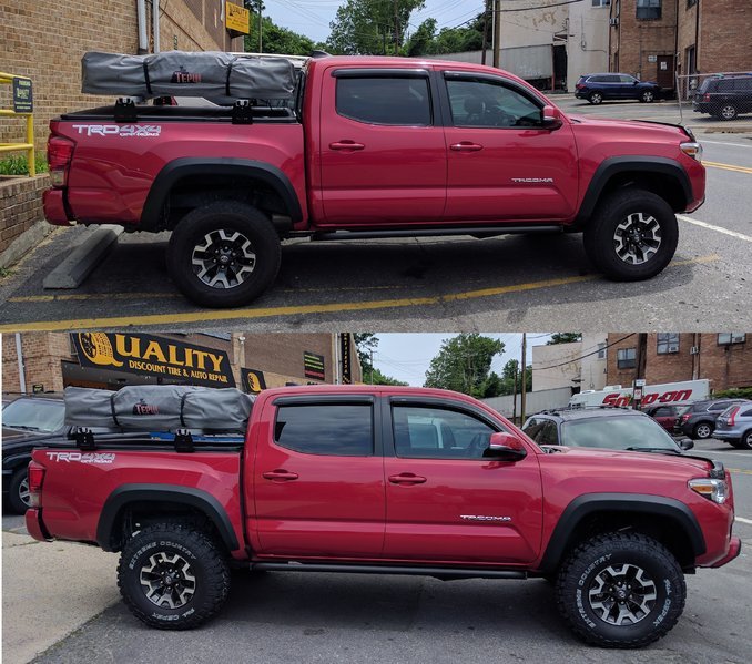

    Top - Before, Stock tires, 265/70/16, GoodYear Wrangler Kevlars
    Bottom - After, Dick Cepek Extreme Country Mud Terrains E Rated 255/85/16

    Nice!!!!!! Looks sexy.

    More pics of the new Dick Cepeks. Honestly guys, look up reviews on these tires. I got them for $171 a pop when they were on sale. When I looked, there was only 1 guy with anything bad to say about these tires and from his youtube video, the signs of wear looked like he had a suspension problem. Anyways, my review after driving 7 miles in them:
    I got up to 45 miles per hour (Maryland local streets).
    Noise - I was listening to AM talk radio at volume 10 and did not notice the sound.
    Power - Could not tell a loss in power.
    Steering - No difference.
    Smoothness - I felt slight vibrations due to knobby knobby tire treads, not like the slick goodyears.
    Satisfaction - I am super happy right now.
    Offroad - I am going offroading with @Mobtown Offroad this Saturday to test it out!
    Rub - No rubs to report.
    MPG - No noticeable difference.
    Keep in mind, my shitty review is based on 7 miles of driving slowly.

    That looks sharp, definitely fill out your wheel wells! Way to go whites out too :thumbsup:

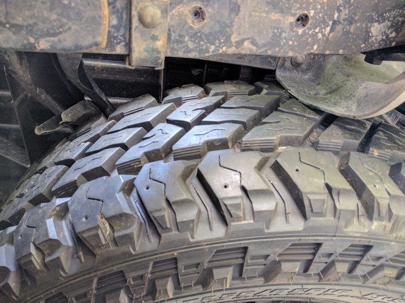

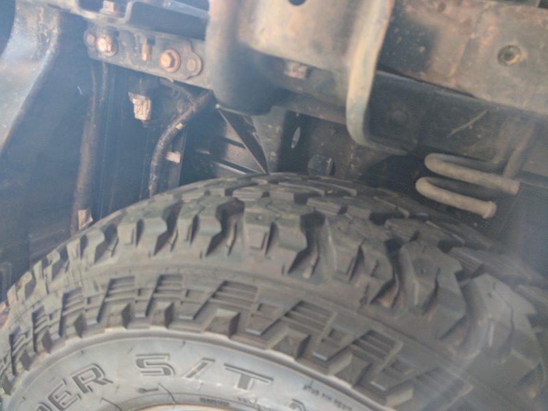

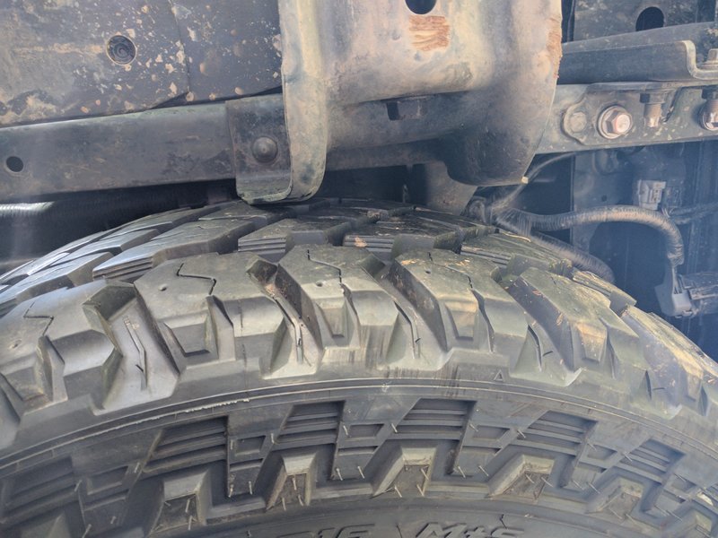

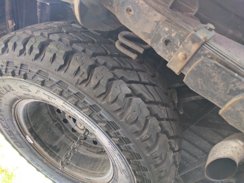

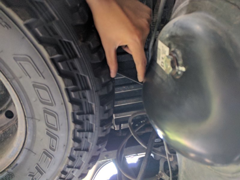

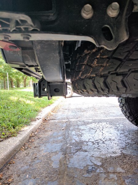

    Also, pretty relevant important info, look at pictures for fitment of the larger spare tire now. My spare is actually a Cooper STMAXX 255/85/16. I did not have to hammer or bend any brackets, just slowly raised the tire and shifted it back away from the front brackets. There looks to be almost 2-3 inches of clearance from tire to rear differential.

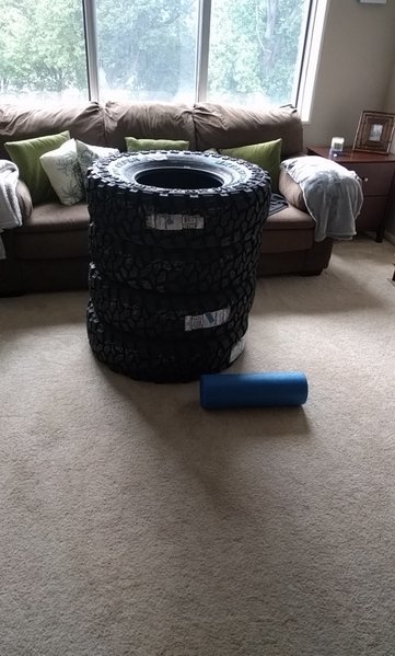

    mine are stacked just like that in my 2nd bedroom haha

    When I took my original spare down it had two decent indentations on the sidewall (two parallel lines). Didn't look great so I've been worried about damaging my new tire even if it would fit under there.

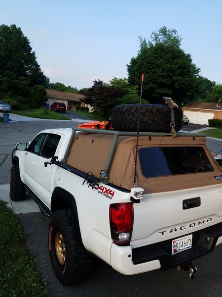

    keeping it in the bed of a short bed takes up alot of room. Ask @90yota

    Working on it.
    It does. You can however secure it in a number of different ways to accommodate additional cargo. It will also fit back up underneath if you do a little tweaking. I have also been looking at the receiver mounted spare carriers as well. Lots of options out there.

    It gets in the way.. my temporary fix till rtt takes that space
