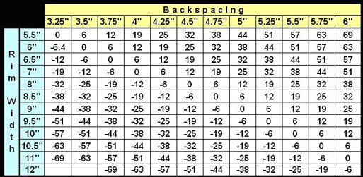

    Here is a nice chart to help with offset and backspacing

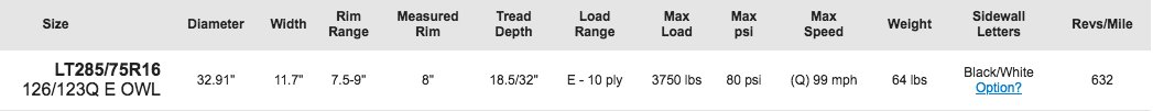

    With a 16 x 8 wheel; you would need 0 offset and 4.5" backspacing
    With a 17 x 8.5 wheel; you would need -6 offset and 4.5" backspacing
    With the JBA UCA's I would look into a wheel with the above offsets and backspacing. The width of your tire will also come into play. Looke for as tire that has an approved width for the appropriate wheel to fit.
    For example: The Cooper ST Maxx in 285/75R16 should not go on a stock offroad wheel (16 x 7, +25 with 5" backspacing) according to the specs. Minimum should be a 7.5" wheel. This would also help avoid rub on suspension and body/frame components.
    Hope this helps out some.

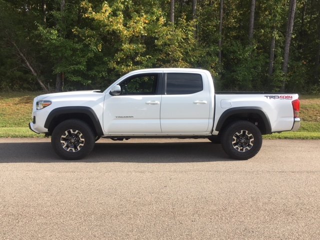

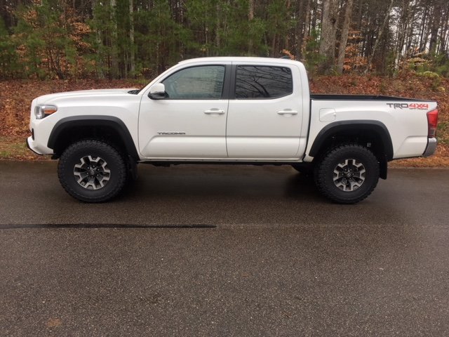

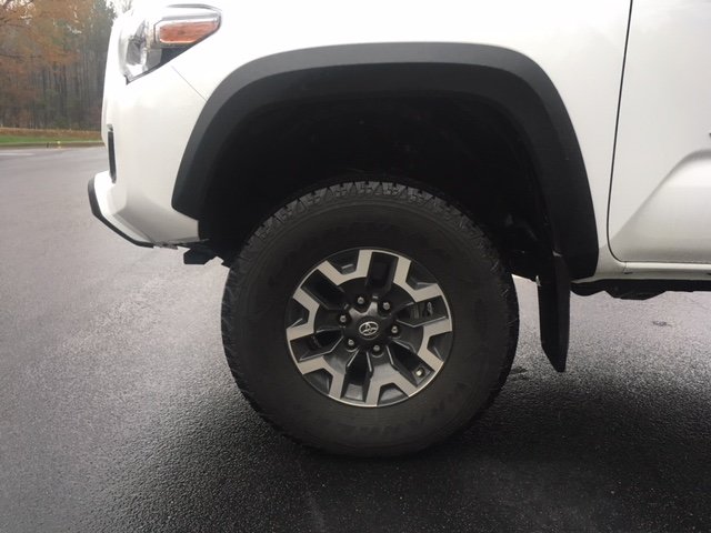

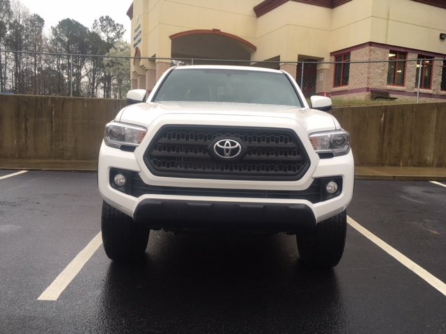

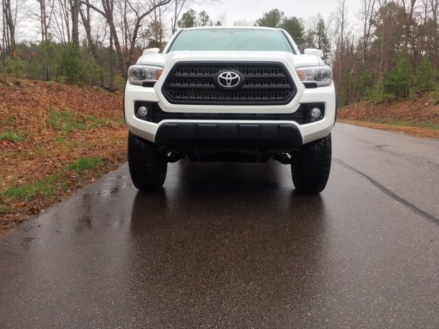

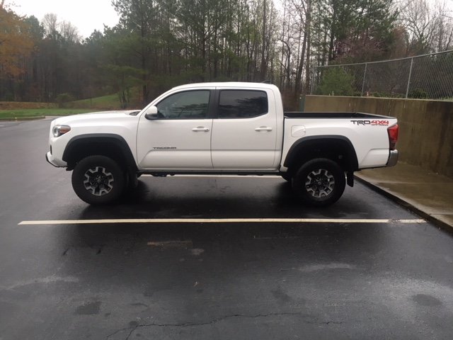

    There you go....Aaaaanold!
  16. Mar 7, 2018 at 3:55 AM
    #1216
    chipcall61
    chipcall61 Well-Known Member
    Aug 26, 2017
    #228076
    85
    North Carolina
    2017 Toyota Tacoma TRD Offroad
    2" OME Bilstein Lift Cooper ST MAXX 255 85R16 TRD Pro Grill OME Bedmat Weathertech Liners all around
    Above: stock suspension and stock 265/70 R16 Goodyears
    Below: ARB OME 2.25" suspension lift and 255/85 R16 Cooper ST MAXXs - no rubbing, no trimming, spare fits up with room to spare.
    Love it!
