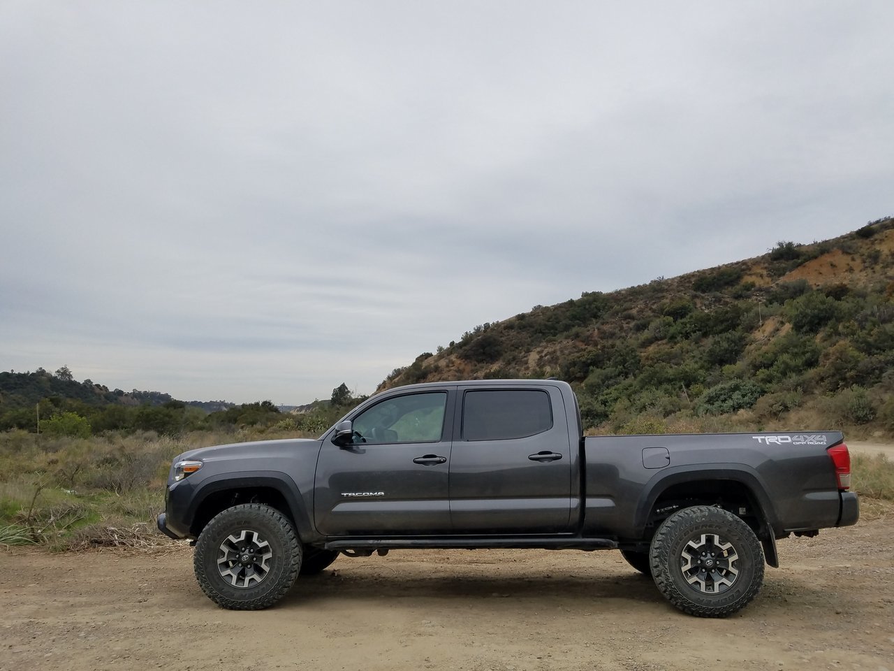

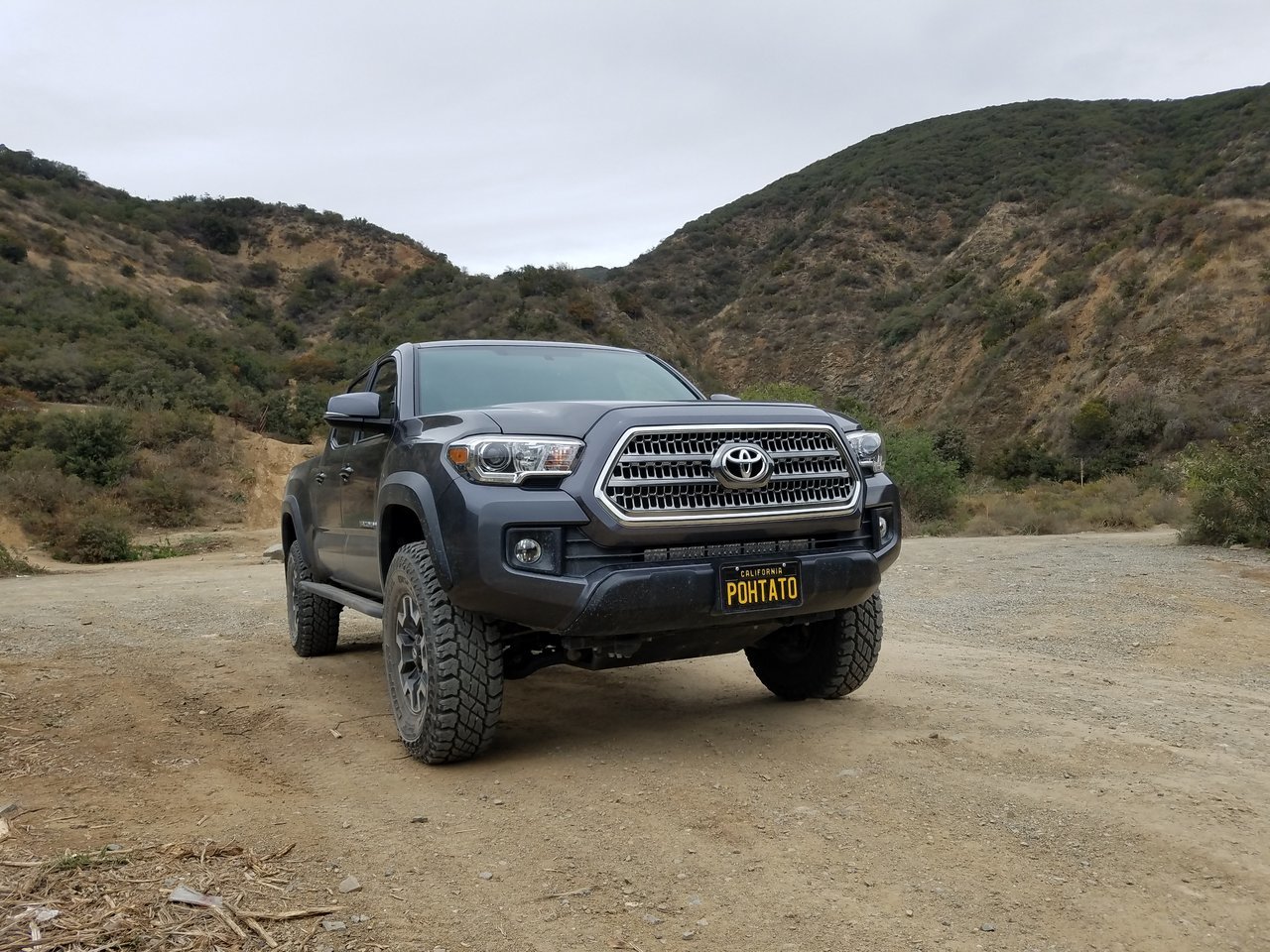

    Here's my money pit:
    Icon 2.5 vs with resi front and rear.
    Arb dakar leads
    JBA std ucas
    And st maxx tires that rub the hell out of my cab mount.

    Your caster looks visibly low. With the UCA you should be able to adjust it higher and move the tire forward in the wheel well and away from the cab mount.
    Hairy Taco, ajmogen and Cpngo[QUOTED] like this.

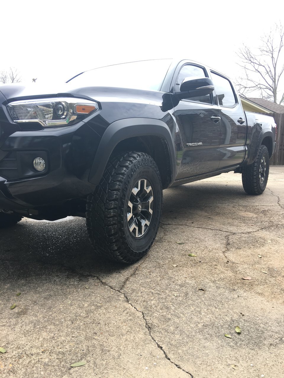

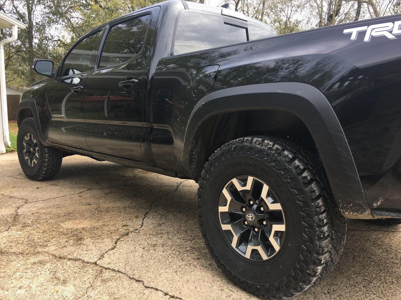

    Put Cooper ST Maxx 255/85/16s on yesterday. Truck is bone stock.

    I love them so far. Took a short trip down some mud roads yesterday. They did great. Low noise, good road manners. Only thing I noticed is at interstate speeds, it’s not quiet as stable feeling in crosswinds.

    I’m at 34 currently. Now when I was headed home on the interstate, they were at 44, which is quite possibly why they were so squirrelly. I haven’t been back on the interstate since I lowered the pressure. I’ll know for sure this weekend.

    What caster would you suggest? Currently at 3.0
  9. Mar 7, 2018 at 6:06 PM
    #1229
    Sharpish
    Sharpish Well-Known Member
    Jan 4, 2016
    #173981
    3,832
    Brian
    Victoria, British Columbia, Canada
    2012 Tacoma TRD OR 4x4
    My bad, that's a good number. It's curious you would rub with +3

    Was hoping you would say 4 hahaha

    I’m not sure what rubbing you are referring to. Maybe that backspacing will cause rubbing, but factory wheels don’t have any rubbing issues.

    Gotcha. The aftermarket wheels may cause rubbing. I can’t speak on that. I have stuffed and flexed mine with factory wheels and haven’t had any rubbing at all. I’m sure someone on here is running the setup your asking about.
