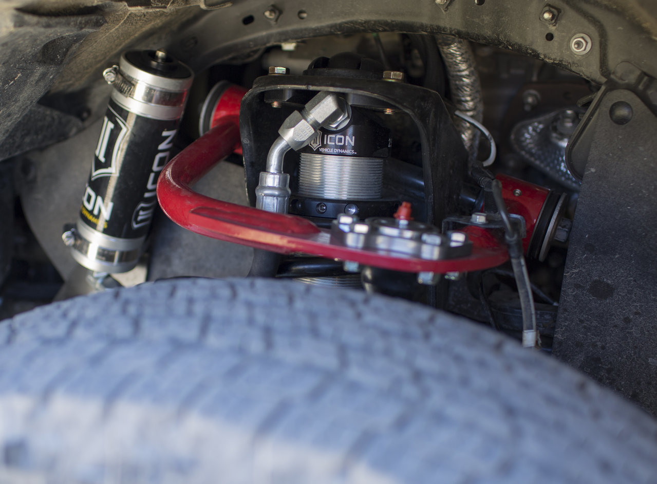

    The lift gods do not shine upon me. When I had a 2" lift with the JBA's I was able to get the tire to rub all the way to the center of the tube. This is with the stock OR wheels. Marlin suggested spacers, now I have about 3/4" between the UCA and tire at full lock. But also I am rubbing my cab mount. I need as spacer thats more in the middle or a wheel with less BS. Gonna try and do the CMC this weekend.
    Will post results later.
    Btw Anyone have their wheel hub center to fender measurement? I'm wondering if im not lifted as much as I should be.

    What do you mean “center of the tube”, and what size spacers do you have now that gave you the 3/4” clearance to ucas? You’re talking wheel spacers I presume?

    When im talking about the tube, I mean the tube used to make the UCA. In the photo above its the portion just before the ball joint (to the left). I used 1.25" spacers suggested by Marlin.

    Gotcha. Thanks, that’s really helpful. Very few folks with the JBAs. Is the 3/4” clearance an estimate or did you measure? I want as small a spacer I can get away with...
