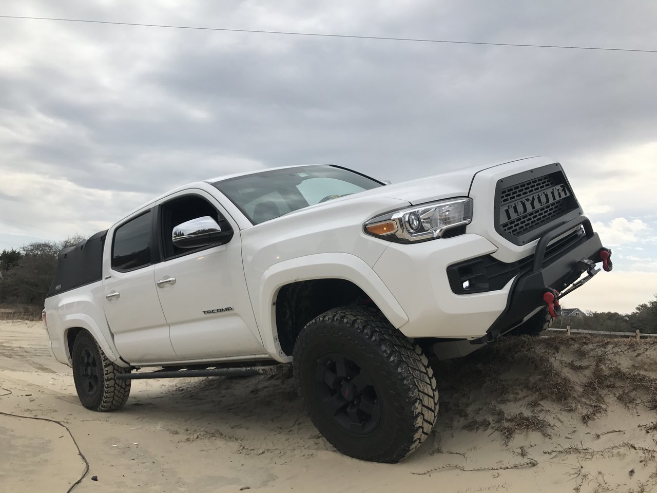

    Here ya go!
    https://www.tacomaworld.com/threads/the-skinny-on-skinny-tires.529656/
    I've never once rubbed before or after my lift and even before or after my CMC. I've tried flexing it out as hard as I could and at full turn...
    Good luck
