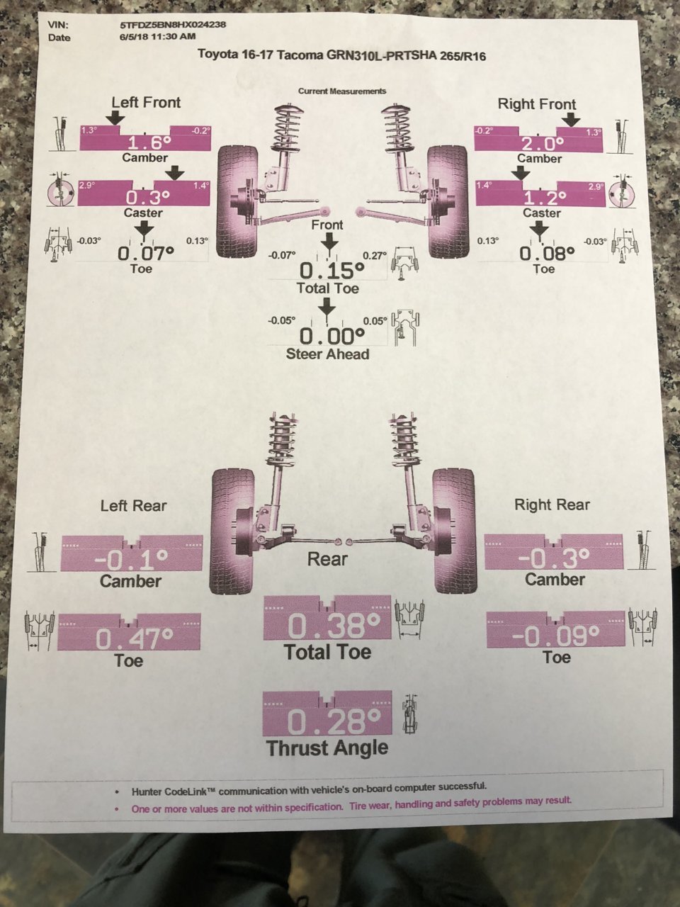

    That's a horrible alignment even with stock UCA.
    Try another shop.

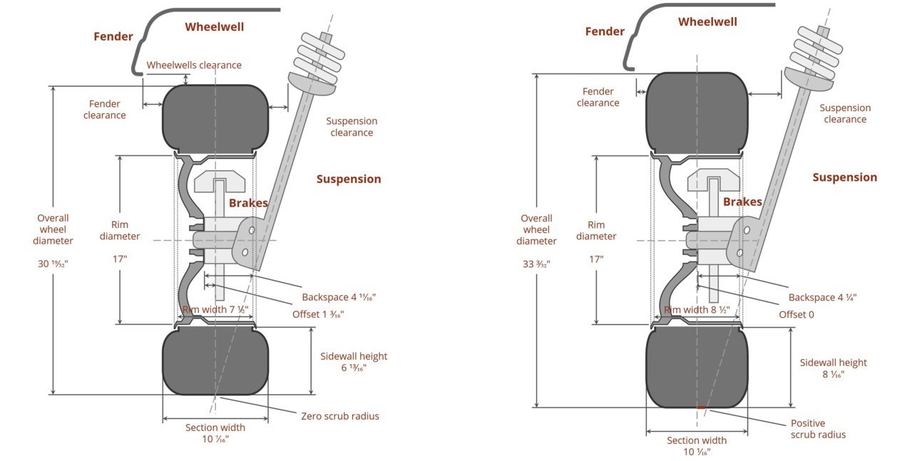

    Read the entire 72 pages of thread, and didnt find the answer....maybe someone can help.
    I would like to run the Icon Rebound 17x8.5 wheels 0 offset with the 255/80r17 Cooper ST Maxx tires on a stock 18 CCSB Taco Sport. It looks like the tires will sit on the wheel well...so what would I have to trim or do to make them fit? Should I pick a different wheel?

    8.5" is very wide for a 255. Honestly 7" is best and 8" is pushing it.
