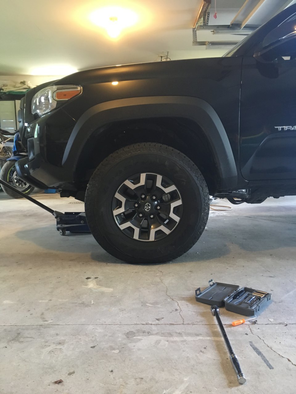

    Put on some Dick Cepek Extreme countrys over the weekend. Had my mud flap rubbing on the tire but I think a quick zip tie took care of that.
    Here are ssome comparison shots of the 2

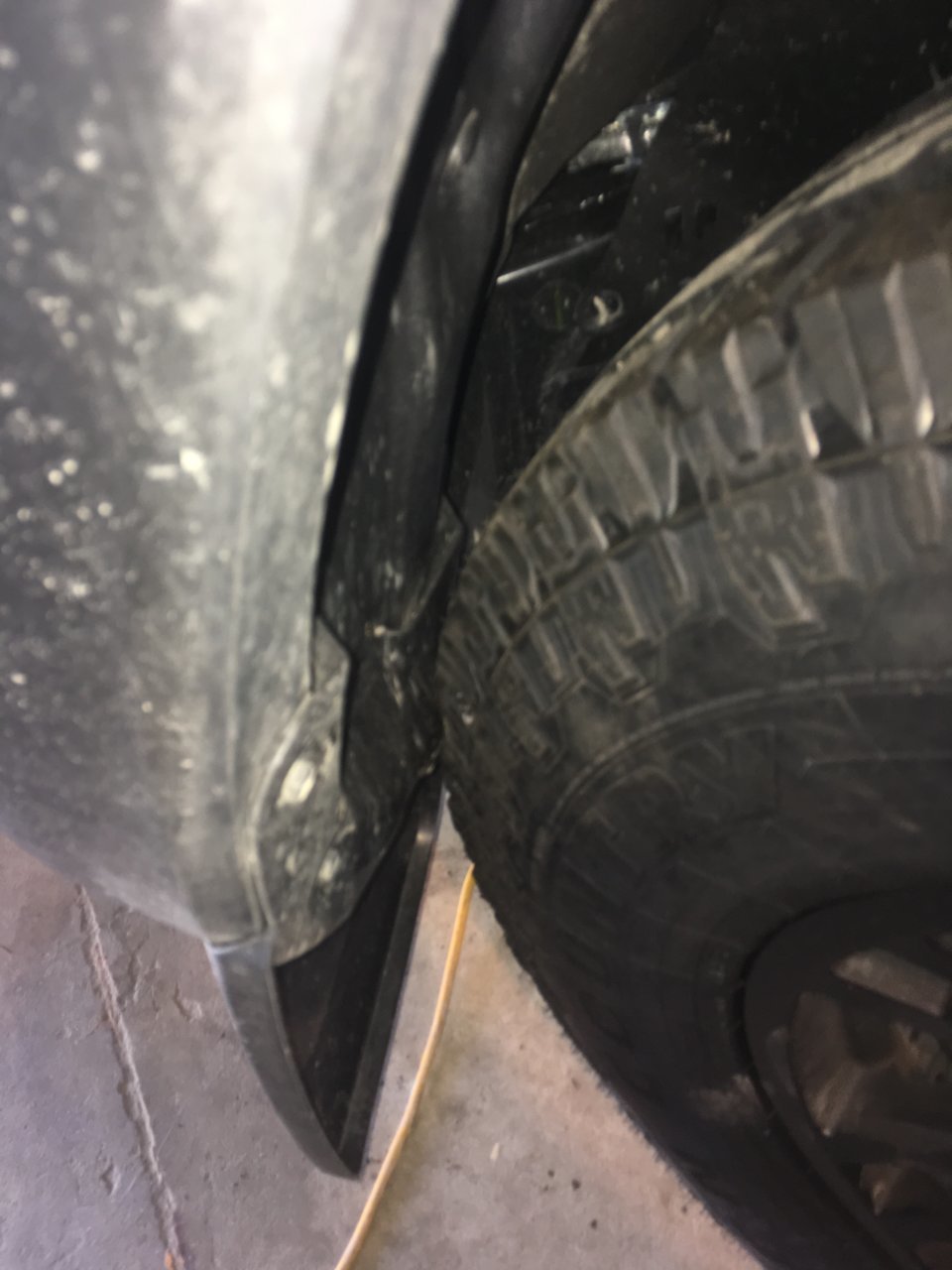

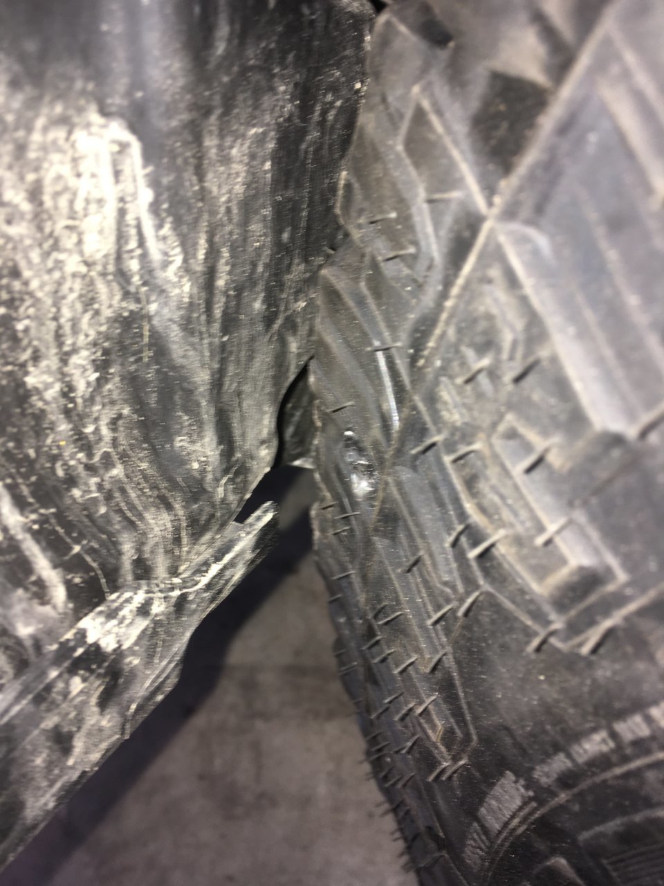

    Here's pictures of the stock wheels vs. 4Runner TRD Pro Wheels. Sorry in advance for my camera skills.
    Here's where the new tires would rub stock mudflaps if you kept them on:
    Here's where the new tires would rub if there were no mudflaps. This is plastic that could easily be trimmed. The little overhang you see there needs about .5" taken off of it for the tires to clear. This only happens on the passenger side.
    Lots of clearance from UCA. I believe a smaller spacer wouldn't have an issue clearing if you wanted a more aggresive stance. I will update on that though, because that's a mod I am interested in doing. Next comes 6112's and AAL's.
