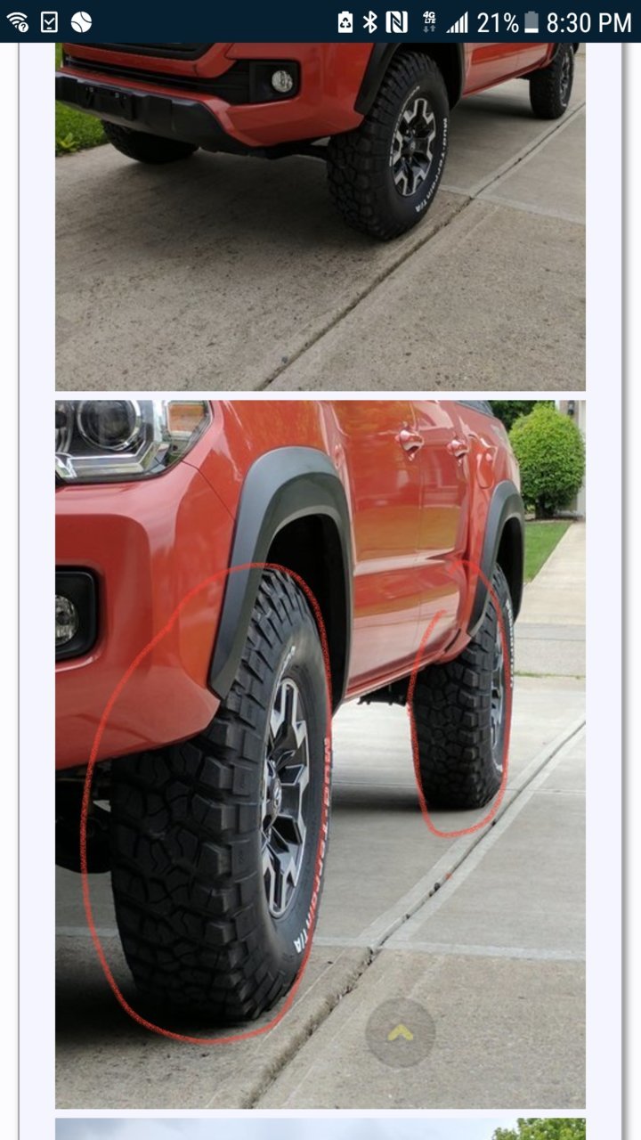

    They look skinny in pictures or when you're specifically looking at them to see if they're skinny, but just natural observations they don't really look that much skinnier than 265s. I mean, its like 1/2 an inch in reality.
    I can confirm my 315s are visually wider, though.
