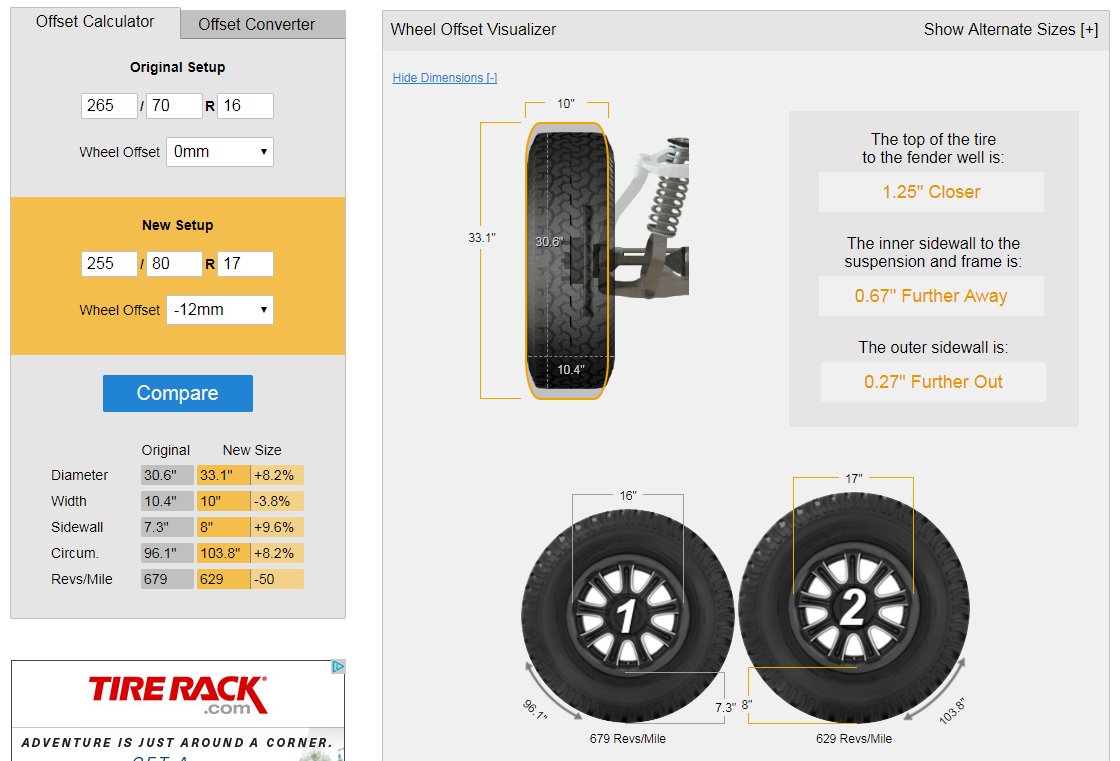

    And in case you have seen this, it's great for when you are contemplating different size tires...

    I feel like you can look at this all day long but you'll never know if the tire looks good on your vehicle.

    LOL...there is certainly some truth to that...but it's better than nothing...:thumbsup:

    That's an awesome tool.. someone should sticky that.

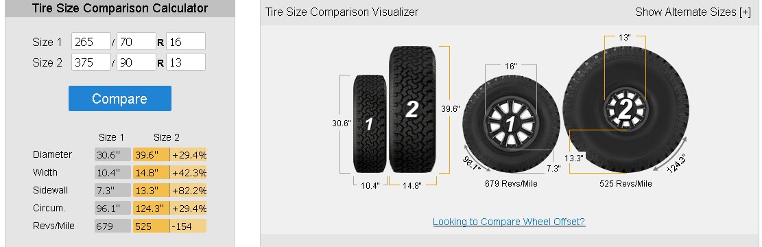

    Hmmm.. I think I figured out what tires I want to switch to, can someone confirm if they will fit without a lift?

    Nice, I had not seen that...though I do like the way the one I posted shows you the width view....

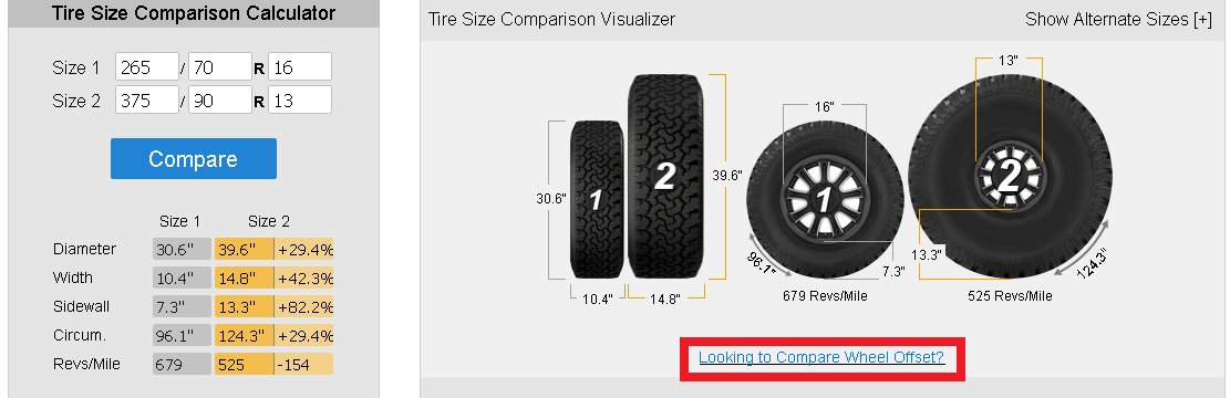

    It was staring you in the face.... see red box.

    I was referring to the link to the TW tire size calculator, not the offset calculator from the other site I posted...I've seen that.

    @speedtre thank you again, this is going to help me make a sound decision.
    I've been looking for this tool, now I can figure out what size without having to chop anything.

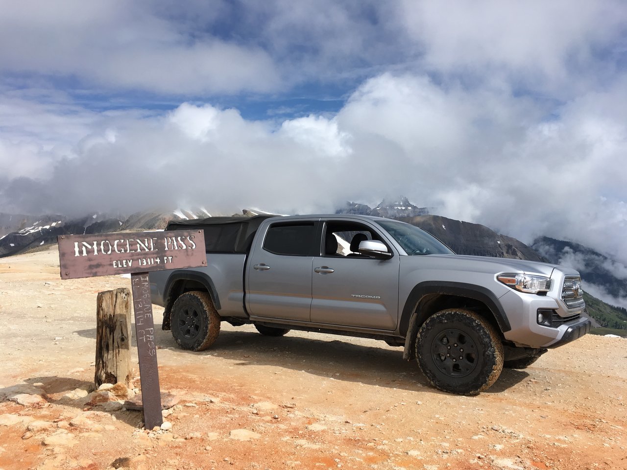

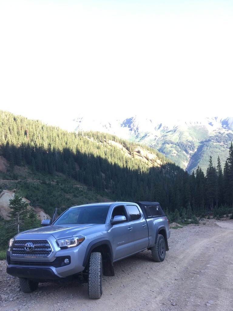

    Here are some pictures of ko2 235/85r16 on a 2017 four door long bed. These were from my 2011 single cab and I wanted a 10 ply tire for my trip to Colorado. So far I think I like them on this truck too. Also the last picture is with the stock size on driver side and 235/85r16 on passenger side.

    How is the handling compared to stock? Can you take corners just as fast? Excellent pics man.

    The only difference in handling I notice is that the ride is alittle harsh compared to the stock tires. That's because the 235's are E rated and stocks arent. By harsh I mean you can feel the bumps alittle more in the road. I feel like I can take corners just as fast, but I drive it like a truck and not a sports car with any size tires.

    What about when airing down.. are there any noticeable characteristics?

    Mpg changes?

    I did air them down to 18 psi for the alpine loop, imogene, and Yankee boy. Made for a pretty smooth ride. I didn't notice any difference really, maybe a little easier to turn the steering wheel that's about it. As far as mpg goes I haven't had them on this truck long enough to know. If it's anything like my 2011 I will lose 1 mpg over the stock tires.
