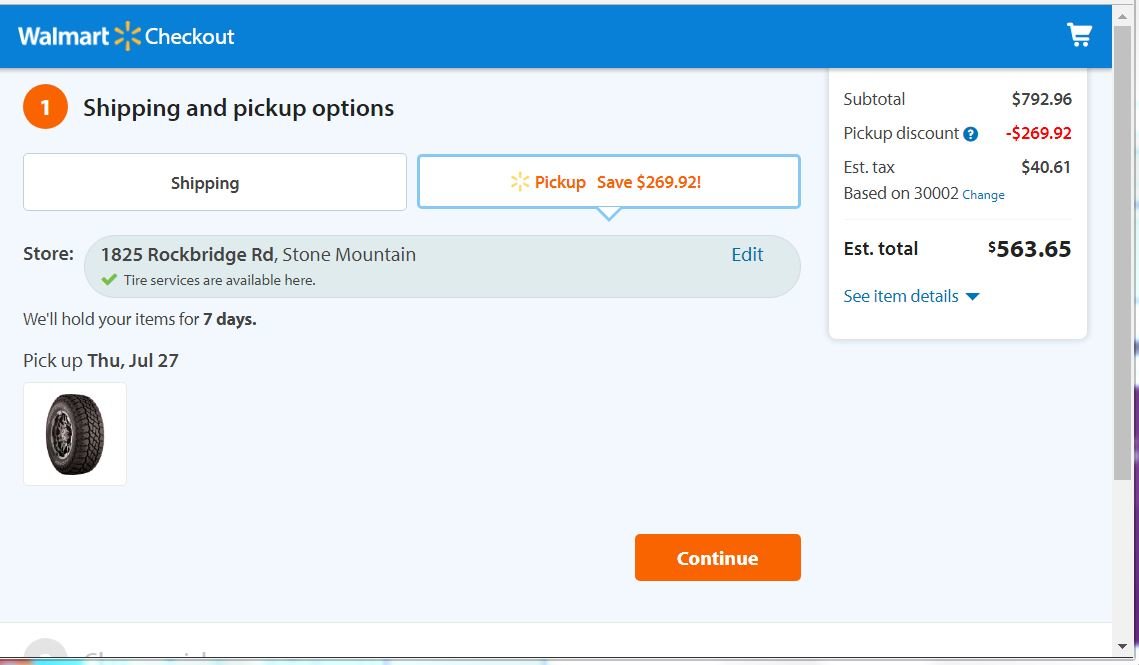

  17. Jul 21, 2017 at 6:55 AM
    #177
    speedtre
    speedtre Well-Known Member
    Dec 21, 2015
    #172822
    549
    DirtySouth
    '17 DCLB TRD OR AT 4x4
    FYI....I just did a search on this size and I found that right now you can get 4 of them from Walmart for $523.03 +tax if you pick them up!
    https://www.walmart.com/ip/Cooper-Discoverer-S-T-Maxx-121Q-Tire-LT255-80R17/47406806
    BloodyTaco[QUOTED] and Governor like this.
