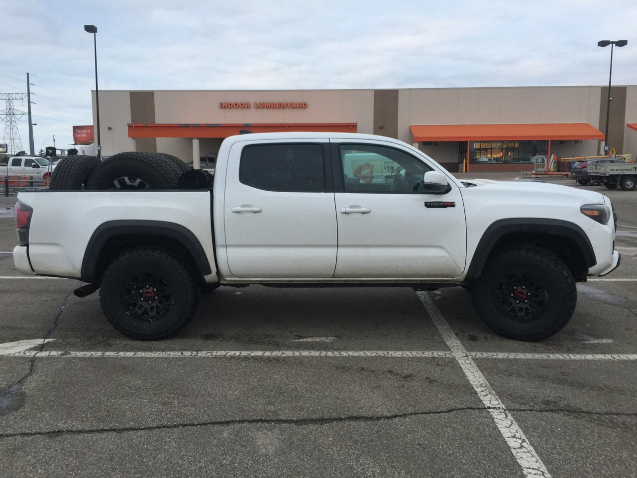

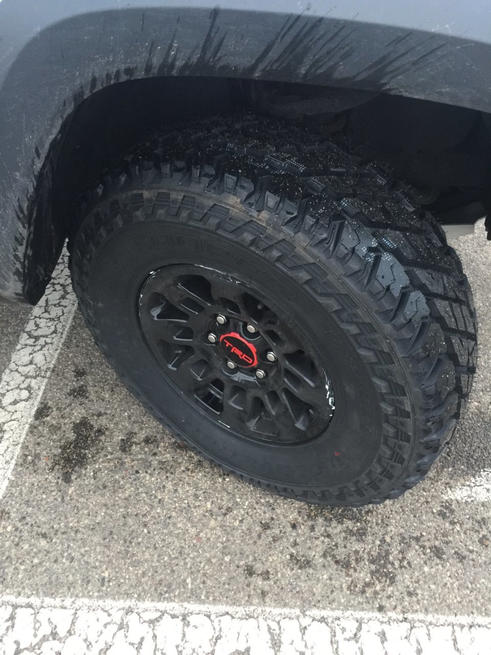

    Got my 255/85/16 ST Maxx installed this week......I've got a stock TRD Pro suspension with OEM TRD Pro wheels......no rubbing at full lock (haven't been at full stuff yet) and they ride quiet and track straight. Really happy I pulled the trigger. Spare tire fit no problem.

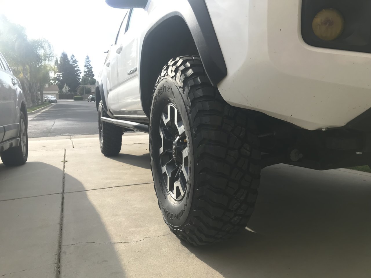

    KM3’s released2 weeks ago. Not much feed back on the size yet. I bit the bullet and am giving them a shot. I loved my ST Maxx’s last season

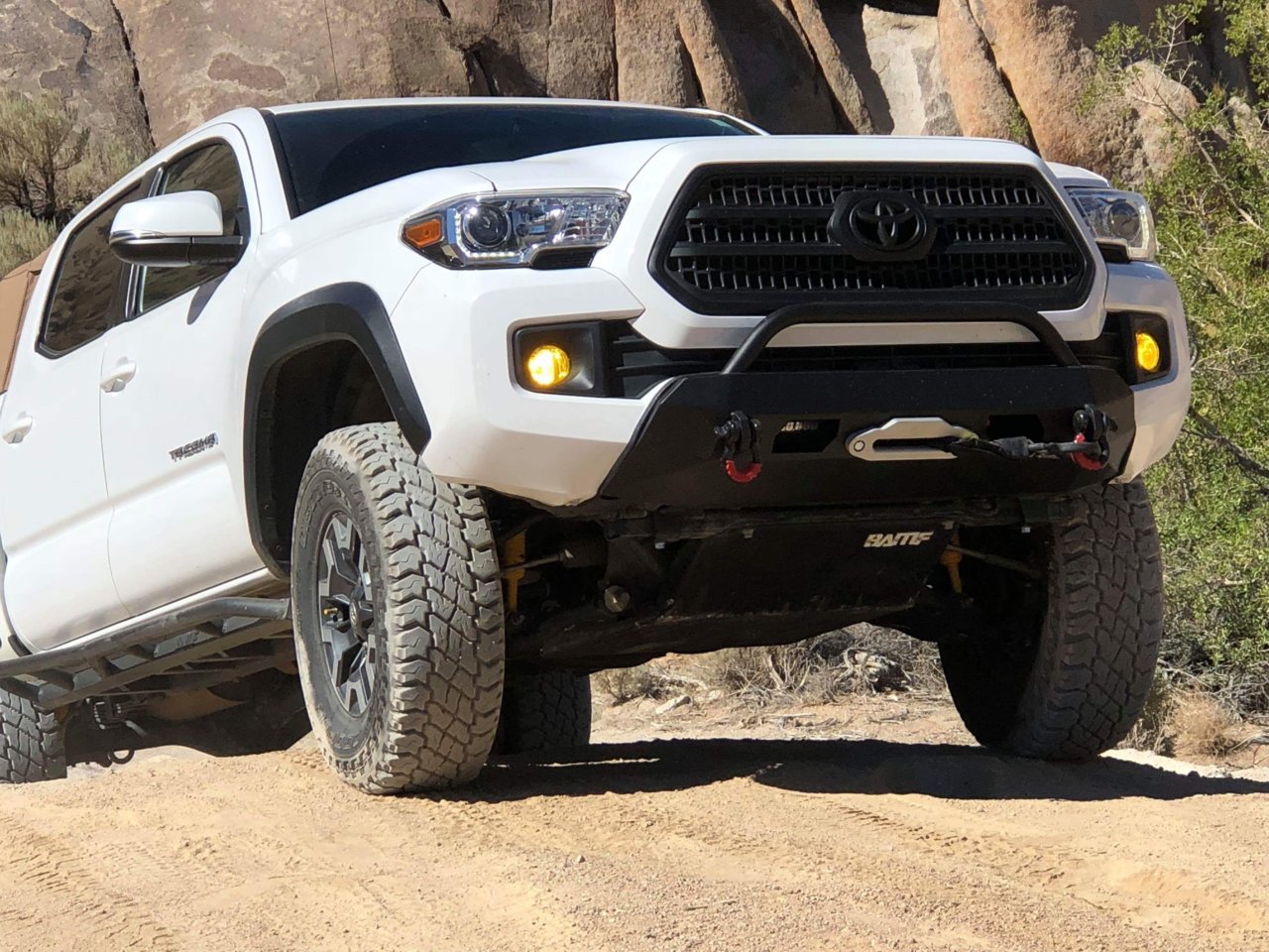

    265/75/16
