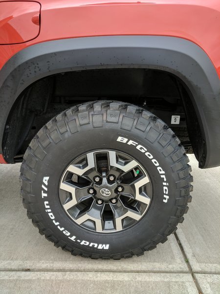

    Well, I jumped on the bandwagon today. They look great and seem to drive well (so far).w7RygFuPdV50ZBMPOZ_DUkfOL5mdIHp3JMtHym7i_0a1b64e73a7bfe21ece1a2d65f635675a030c46a.jpg
