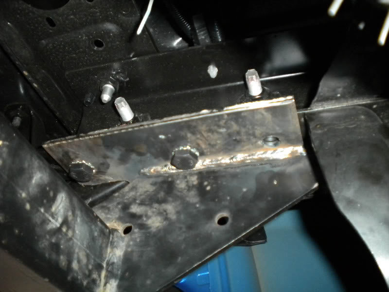

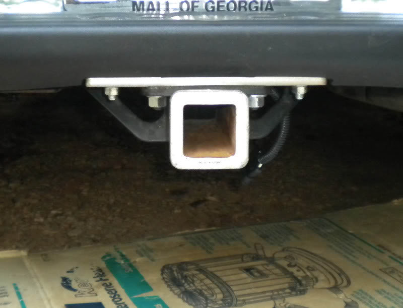

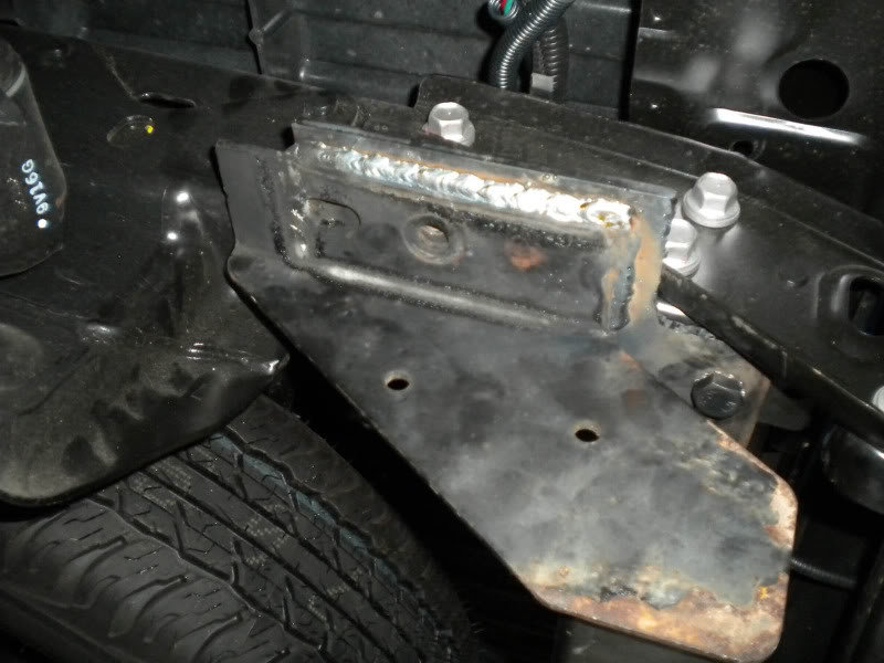

    I had a Gen 1 Reese receiver in the garage that came with my '99 Tacoma when I bought it new, so I took a look-see, and decided to give it a try. It definitely is not a bolt on (the Gen 1 receiver is wider than the Gen 2 frame rails), but with some help from a friend, we cut out some adapter plates and welded them to the receiver. I was going to do a total bolt-on adapter, but he preferred welding the receiver to the adapter plates. We then bolted the unit onto the truck, using the existing holes for a receiver. My friend wouldn't charge me anything, but I also help him out whenever I can with his auction site stuff.

    View of driver's side looking in:
    View of driver's side from middle of truck. Still working up courage to drill that extra hole in the frame.
    View from the back. Built a spacer plate to adapt four inch apart holes on the reciver to 200mm apart holes on bumper.

    Looks good to go. You shouldn't need the third bolt since you bolted the receiver hitch to the bumper which by itself is good for 3500lbs.
