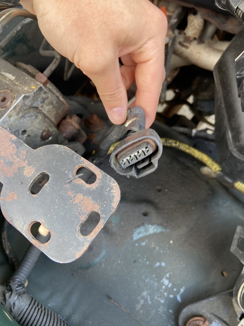

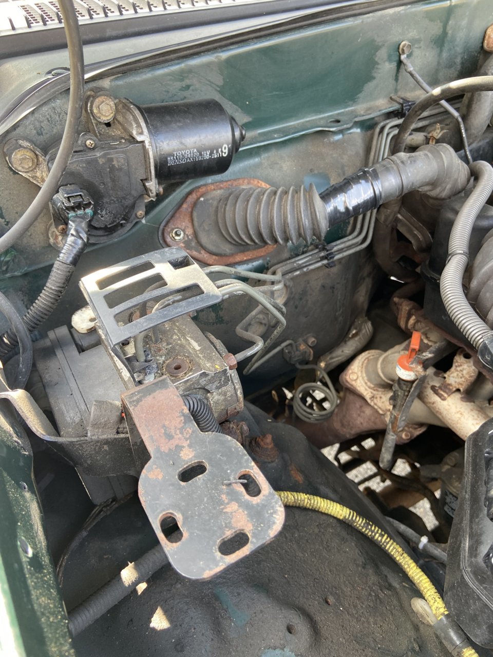

    Hi, so I have a 2003 Toyota Tacoma Prerunner 2.7L L4 and it’s an awesome truck and I love everything about it. However, after living without A/C for almost a year I can say it is an essential especially with fabric and not leather seats.
    Particularly, I believe the previous owner actually had ac in the truck but parted it out. I will post pictures of the plugs and adapters that are still in the engine bay for the air conditioning (I believe)
    My question is, how much would it be to reinstall ac into my truck and are there any kits out there that I could buy specifically for my truck since it’s already prepared for ac/ has already had ac?
    Any suggestions would be great, thanks.

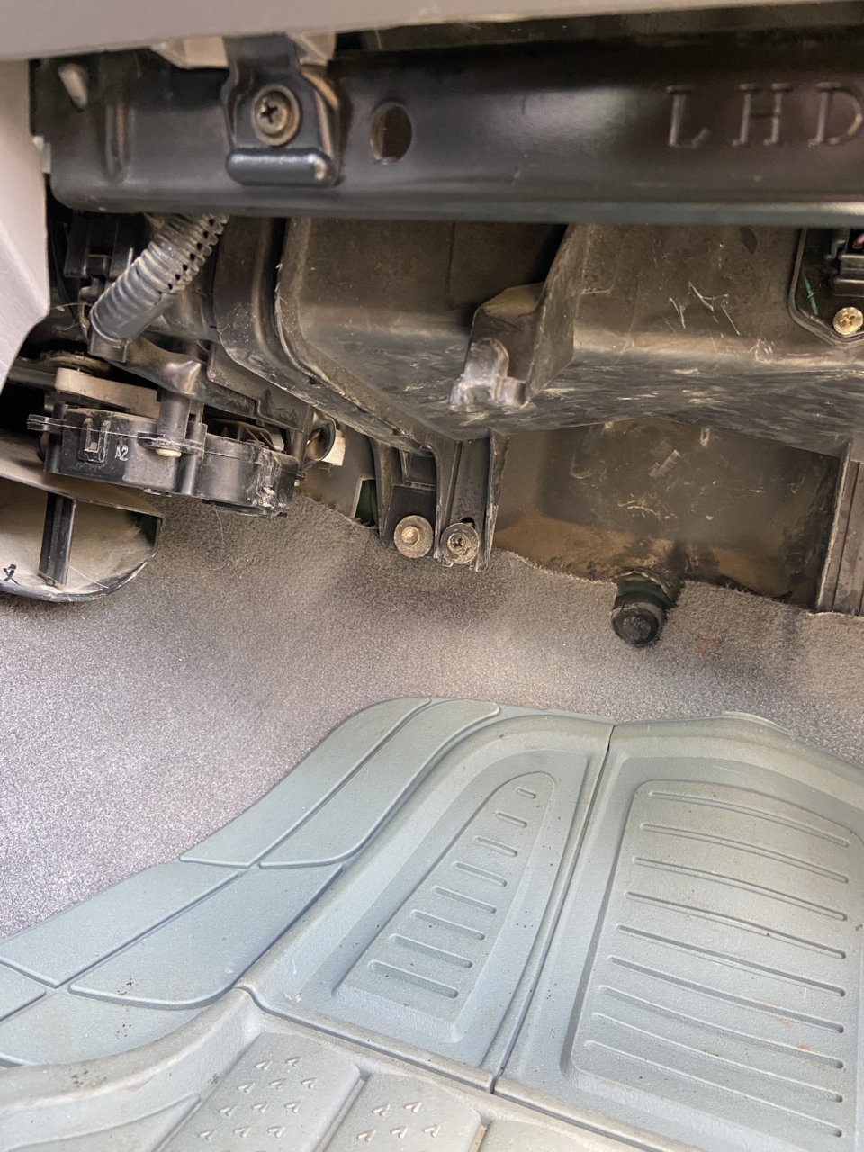

    1st gens don't require dash removal to access the evaporator, it's in a sub assembly separate from the main HVAC housing you just have to take some trim and metal brackets out behind the glove box to get it out.

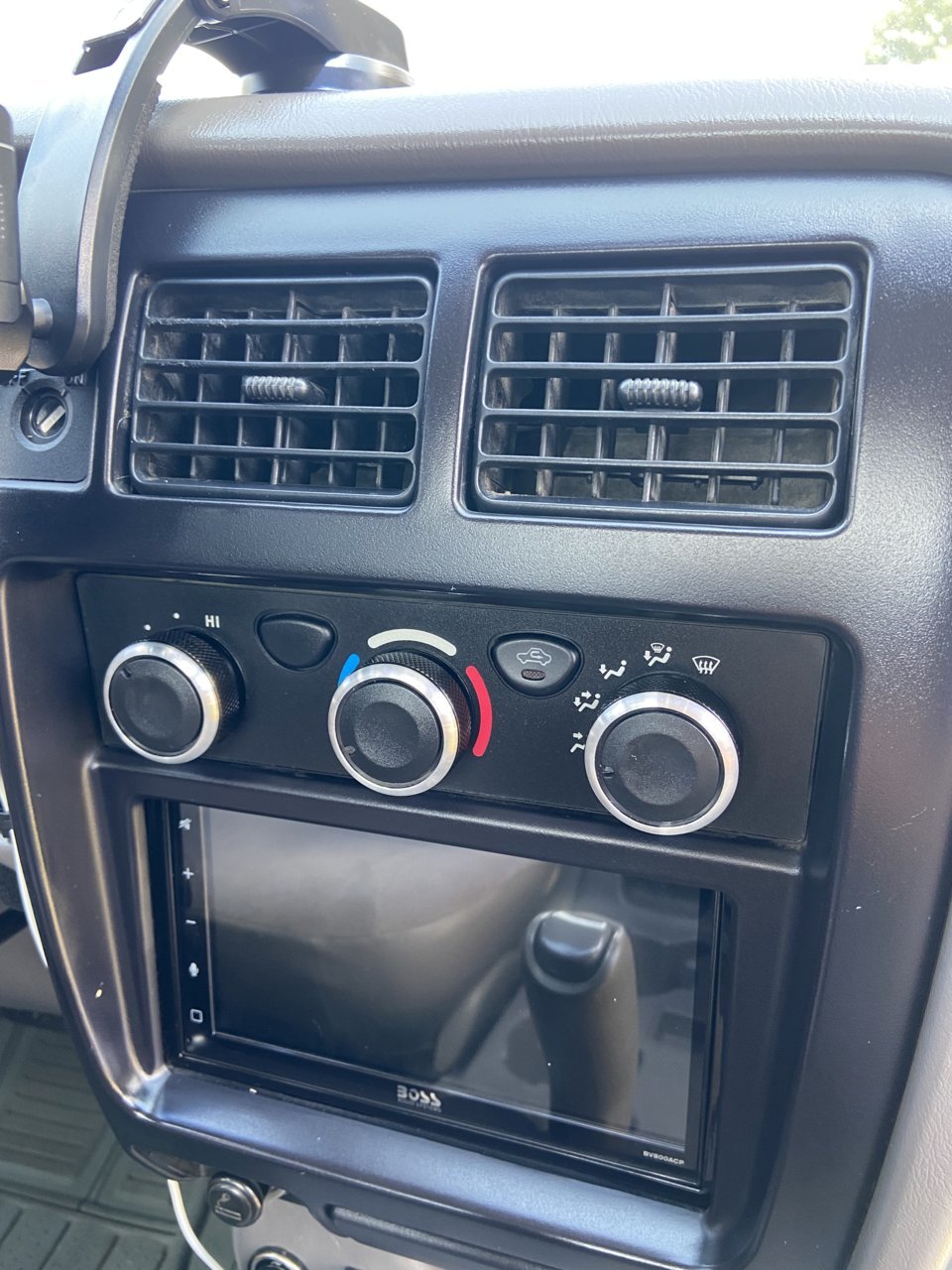

    Is there an A/C button on the HVAC controls?

    No I know what your talking about too and I’ve seen it. The spot it just hard plastic, no button but as said where the compressor usually goes beside the wiper motor it’s still there.

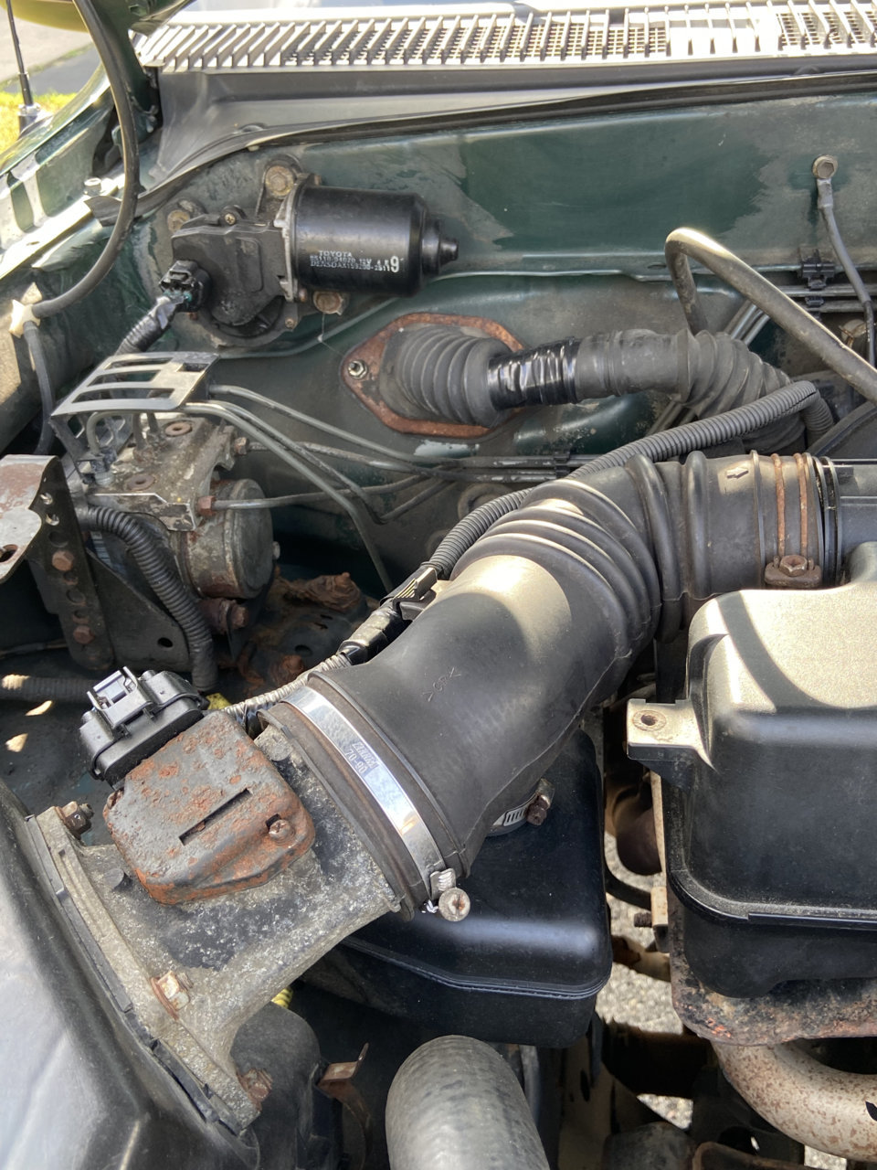

    I have pictures here. You can see that I have pictures of under the glove box and it looks like there’s brackets there with nothing attached. The panel also had the recirculating button which I believe is for ac aswell. Fuse box even has a fuse for the ac 10A so there are clear signs that it did have ac. The empty bracket by the abs system looks like where the condenser would have gone too. Anyway take a look and let me know, thanks.

    I can't make out the A/C line ports on the firewall. Are they there? Blank A/C button indicates it didn't have it factory.

    I believe the previous owner would have removed it when he got rid of the ac not sure though. Not sure what those are if I’m being honest. Could you explain?

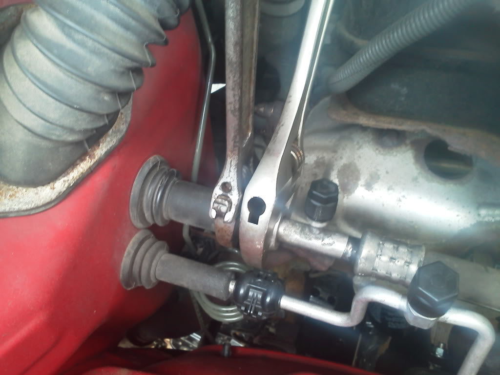

    Actually scratch that. I see where they would go in this picture, below the ECU connector. Your truck never had A/C, where the lines would enter the cab are plugged.
    This is what a truck with A/C would look like:
  15. Aug 31, 2021 at 10:07 AM

    I see. So what are the two unplugged-plugs for then and the employ bracket for?
  17. Aug 31, 2021 at 10:11 AM
    #17
    BartMaster1234
    Aug 21, 2016
    #195197
    45,888
    Tyler
    Pittsburgh, Pennsylvania
    Flux Capacitor
    90% sure that's for the Cruise Control actuator.

    2003 Toyota Tacoma Xtracab Prerunner 2WD 2.7L L4
    Funny cause I have a cruse control switch on the steering wheel but I haven’t tried it out yet.

    That's something easy you can hook up. Buy the actuator, and the computer that sits behind the passenger kick panel.

    So pretty much I can’t have ac unless I spend 1500 or more Canadian to get all the parts and labour. Damn.
